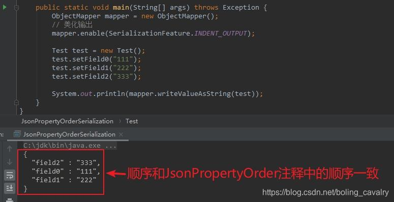

  2. 现在给Test类加上JsonPropertyOrder注解,顺序是field2、field0、field1:
    @JsonPropertyOrder({"field2", "field0", "field1"})
    static class Test {
        private String field0;
        private String field1;
        private String field2;
        // 省去get、set、toString方法
  1. 执行结果如下图所示,也是field2、field0、field1:
