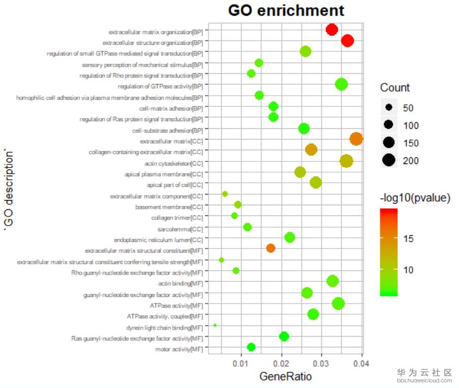

dotplot(BP.list, showCategory=30)library(clusterProfiler)

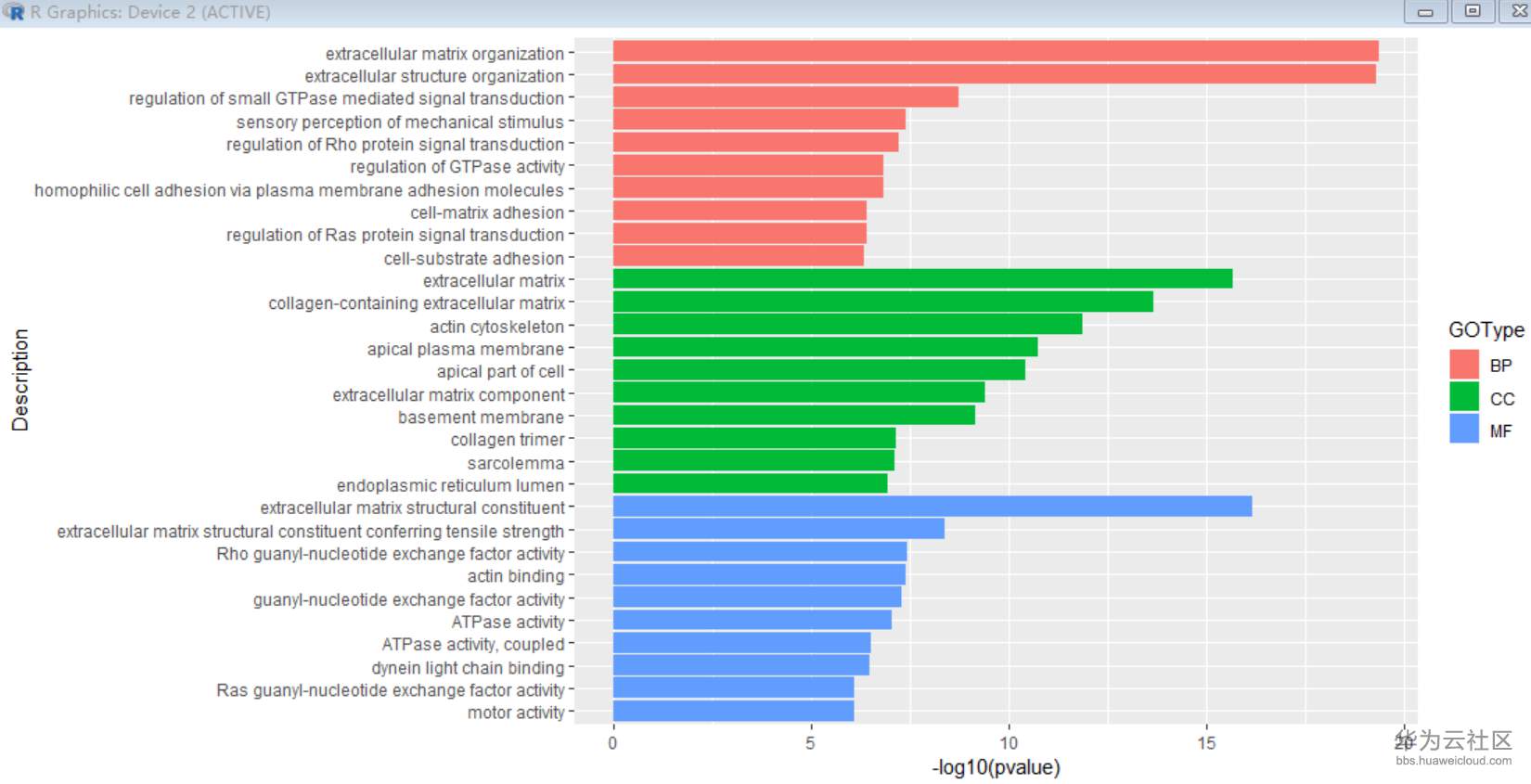

如果要做BP, CC, MF的综合柱状图,采用ggplot2
p1 <- ggplot(data=goAll)+  geom_bar(aes(x=Description,y=-log10(pvalue), fill=GOType), stat='identity') + coord_flip() + scale_x_discrete(limits=goAll$Description)
ggsave("out_bar.pdf", p1, width = 10, height=6)
p2 <- ggplot(Edata, aes(x=GeneRatio, y=`GO description`)) +
     geom_point(aes( size= Count , colour = -log10( pvalue ))  ) + scale_y_discrete(limits=Edata$`GO description`)+
     ggtitle("GO enrichment")  +  scale_color_gradient(low = 'green', high = 'red') + xlim(range(Edata$GeneRatio)) +
     theme(axis.text.x=element_text(angle=0,size=8, vjust=0.7), axis.text.y=element_text(angle=0,size=6, vjust=0.7),plot.title = element_text(lineheight=.8, face="bold", hjust=0.5, size =16), panel.background = element_rect(fill="white", colour='gray'), panel.grid.major = element_line(size = 0.05, colour = "gray"), panel.grid.minor.y = element_line(size=0.05, colour="gray"), panel.grid.minor.x = element_line(size=0.05, colour="gray")
ggsave("out_GO.pdf", p2, width = 8, height=7)
效果如图
