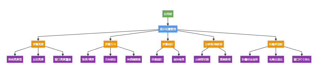

二、核心原理
2.1 显示设置体系架构
flowchart TB
    A[应用层] --> B[显示设置管理]
    B --> C[屏幕亮度]
    B --> D[屏幕方向]
    B --> E[屏幕超时]
    B --> F[分辨率/刷新率]
    B --> G[折叠屏适配]
    C --> C1[系统亮度值]
    C --> C2[自动亮度]
    C --> C3[窗口亮度覆盖]
    D --> D1[竖屏/横屏]
    D --> D2[方向锁定]
    D --> D3[传感器跟随]
    E --> E1[休眠超时]
    E --> E2[保持常亮]
    F --> F1[分辨率切换]
    F --> F2[高刷新率]
    G --> G1[折叠状态监听]
    G --> G2[布局自适应]
    G --> G3[窗口尺寸变化]
    classDef primary fill:#4CAF50,stroke:#388E3C,color:#fff
    classDef warning fill:#FF9800,stroke:#F57C00,color:#fff
    classDef error fill:#F44336,stroke:#D32F2F,color:#fff
    classDef info fill:#2196F3,stroke:#1976D2,color:#fff
    classDef purple fill:#9C27B0,stroke:#7B1FA2,color:#fff
    class A primary
    class B info
    class C,D,E,F,G warning
    class C1,C2,C3,D1,D2,D3,E1,E2,F1,F2,G1,G2,G3 purple
