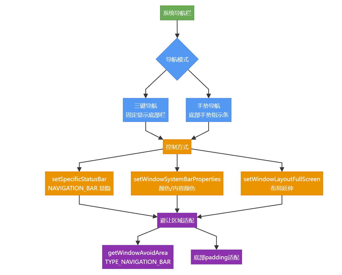

2.1 导航栏控制架构
导航栏和状态栏同属系统栏(SystemBar),它们共享同一套控制机制,但可以独立操作。
flowchart TD
    A[系统导航栏] --> B{导航模式}
    B --> C[三键导航<br/>固定显示底部栏]
    B --> D[手势导航<br/>底部手势指示条]
    C --> E[控制方式]
    D --> E
    E --> F[setSpecificStatusBar<br/>NAVIGATION_BAR 显隐]
    E --> G[setWindowSystemBarProperties<br/>颜色/内容颜色]
    E --> H[setWindowLayoutFullScreen<br/>布局延伸]
    F --> I[避让区域适配]
    G --> I
    H --> I
    I --> J[getWindowAvoidArea<br/>TYPE_NAVIGATION_BAR]
    I --> K[底部padding适配]
    classDef primary fill:#4CAF50,stroke:#388E3C,color:#fff
    classDef warning fill:#FF9800,stroke:#F57C00,color:#fff
    classDef error fill:#F44336,stroke:#D32F2F,color:#fff
    classDef info fill:#2196F3,stroke:#1976D2,color:#fff
    classDef purple fill:#9C27B0,stroke:#7B1FA2,color:#fff
    class A primary
    class B,C,D info
    class E,F,G,H warning
    class I,J,K purple
