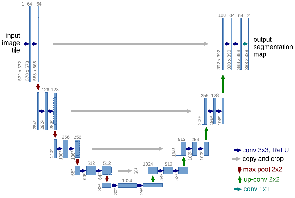

2. U-Net 神经网络
2.1 U-Net 神经网络的结构
U-Net的神经网络结构由卷积块、池化层、上采样层和残差连接构成。在代码中简化了这一过程,但是思想和 U-Net 网络一致。

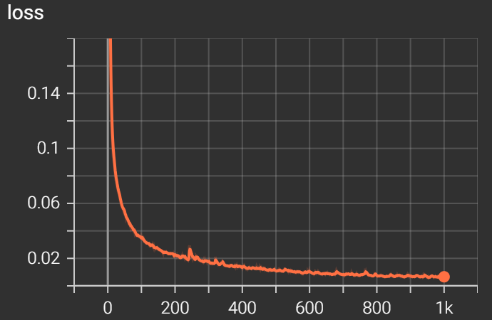

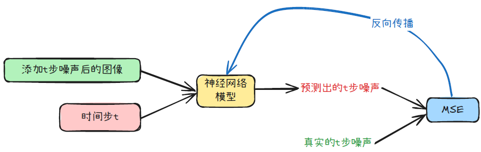

2.2 模型训练
class ImagesDatasets(Dataset):
    def __init__(self, img_size):
        self.preprocess = transforms.Compose([
            transforms.Resize((img_size, img_size)),  # Resize the input image
            transforms.ToTensor(),  # Convert to torch tensor (scales data into [0,1])
            transforms.Lambda(lambda t: (t * 2) - 1),  # Scale data between [-1, 1]
        image_trump = self.preprocess(Image.open("trump.jpeg"))
        image_biden = self.preprocess(Image.open("biden.jpeg"))
        # 将两张图片各复制128次,然后变成一个批次
        self.images = torch.stack([image_trump] * (batch_size * 2) + [image_biden] * (batch_size * 2)).to(device=device)
        # 方差调度计划[β_1, β_2, β_3,...]
        self.betas = torch.linspace(0.0001, 0.02, num_timesteps).to(device=device)
        self.alphas = 1 - self.betas
        self.alpha_bars = torch.cumprod(self.alphas, dim=0)
    def __len__(self):
        return len(self.images)
    def __getitem__(self, item):
        image = self.images[item]
        T = torch.randint(1, num_timesteps + 1, (1,)).to(device=device)
        t_idx = T - 1  # alpha_bars[0] is for t=1
        alpha_bar = self.alpha_bars[t_idx]
        noise = torch.randn_like(image).to(device=device)
        x_t = torch.sqrt(alpha_bar) * image + torch.sqrt(1 - alpha_bar) * noise
        return x_t, noise, T
# 基础配置
ROOT_DIR = Path(__file__).parent.parent
device = 'cuda' if torch.cuda.is_available() else 'cpu'
log_dir = ROOT_DIR / 'logs' / 'U-Net'
# 超参数
img_size = 32
batch_size = 128
num_timesteps = 1000
epochs = 1000
lr = 5e-4
images_datasets = ImagesDatasets(img_size)
dataloader = DataLoader(images_datasets, batch_size=batch_size, shuffle=True)
model = UNet().to(device)
optimizer = Adam(model.parameters(), lr=lr)
loss_f = nn.MSELoss()
with SummaryWriter(log_dir=str(log_dir / time.strftime('%Y-%m-%d_%H-%M-%S'))) as writer:
    for epoch in range(epochs):
        loss_sum = 0.0
        cnt = 0
        loss_avg = 0.0
        for x_t, noise, t in tqdm(dataloader, "开始训练: "):
            x_t, noise, t = x_t.to(device=device), noise.to(device=device), t.to(device=device)
            noise_p = model(x_t, t)
            optimizer.zero_grad()
            loss = loss_f(noise_p, noise)
            loss.backward()
            optimizer.step()
            loss_sum += loss.item()
            cnt += 1
            loss_avg = loss_sum / cnt
        writer.add_scalar('loss', loss_avg, epoch + 1)
        print(f'Epoch {epoch + 1} | Loss: {loss_avg}')

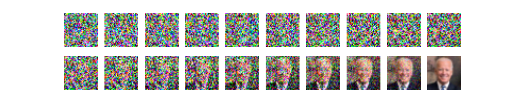

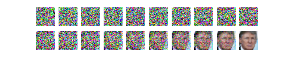

3. 去噪扩散概率模型(Denoising Diffusion Probabilistic Models,DDPM)
# 像素点恢复为图像
def reverse_to_img(x):
    x = (x + 1) / 2
    x = x * 255
    x = x.clamp(0, 255)
    x = x.to(torch.uint8)
    x = x.cpu()
    to_pil = transforms.ToPILImage()
    return to_pil(x)
# 使用两行十列的方式显示20张图片
def show_images(images, rows=2, cols=10):
    fig = plt.figure(figsize=(cols, rows))
    i = 0
    for r in range(rows):
        for c in range(cols):
            fig.add_subplot(rows, cols, i + 1)
            plt.imshow(images[i], cmap='gray')
            plt.axis('off')
            i += 1
    plt.show()
alphas = images_datasets.alphas
alpha_bars = images_datasets.alpha_bars
preprocess = images_datasets.preprocess
image_trump = preprocess(Image.open("trump.jpeg"))
images_1 = []
images_2 = []
# 按照训练数据的形状,采样一张白噪声图片x_1000出来
image_noise_pure = torch.randn_like(image_trump).to(device=device)
# 一张添加噪声的图片
image_noise_add = torch.sqrt(alpha_bars[999]) * image_trump + torch.sqrt(1-alpha_bars[999]) * image_noise_pure
x = torch.stack([image_noise_pure,image_noise_add])
batch_size = 2
# for t = T, T-1, ..., 0
for i in tqdm(range(num_timesteps, 0, -1)):
    t = torch.tensor([i] * batch_size, dtype=torch.long).to(device=device)
    # 一步去噪,x_t --> x_{t-1}
    t_idx = t - 1  # alphas[0] is for t=1
    alpha = alphas[t_idx]
    alpha_bar = alpha_bars[t_idx]
    alpha_bar_prev = alpha_bars[t_idx - 1]
    N = alpha.size(0)
    alpha = alpha.view(N, 1, 1, 1)
    alpha_bar = alpha_bar.view(N, 1, 1, 1)
    alpha_bar_prev = alpha_bar_prev.view(N, 1, 1, 1)
    model.eval()
    with torch.no_grad():
        eps = model(x, t)
    noise = torch.randn_like(x).to(device=device)
    noise[t == 1] = 0  # no noise at t=1
    mu = (x - ((1 - alpha) / torch.sqrt(1 - alpha_bar)) * eps) / torch.sqrt(alpha)
    std = torch.sqrt((1 - alpha) * (1 - alpha_bar_prev) / (1 - alpha_bar))
    # x_{t-1}
    x = mu + noise * std
    if (i-1) % 50 == 0:
        images_1.append(reverse_to_img(x[0]))
        images_2.append(reverse_to_img(x[1]))
show_images(images_1)
show_images(images_2)
