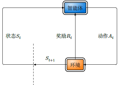

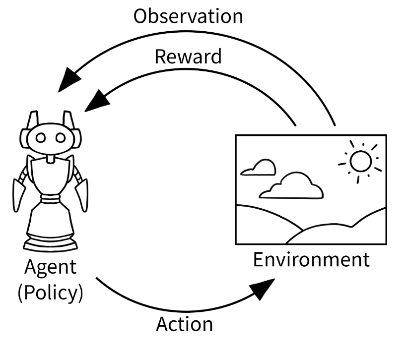

强化学习(reinforcement learning,RL)讨论的问题是智能体(agent)怎么在复杂、不确定的环境(environment)中最大化它能获得的奖励(reward)。
强化学习由两部分组成:智能体和环境。在强化学习过程中,智能体(agent)与环境(environment)一直在交互。智能体在环境中获取某个状态(state,St)后,它会利用该状态输出一个动作(action,At)。然后这个动作会在环境中被执行,环境会根据智能体采取的动作,输出下一个状态(St+1)以及当前这个动作带来的奖励(reward,Rt)。智能体的目的就是尽可能多地从环境中获取奖励。

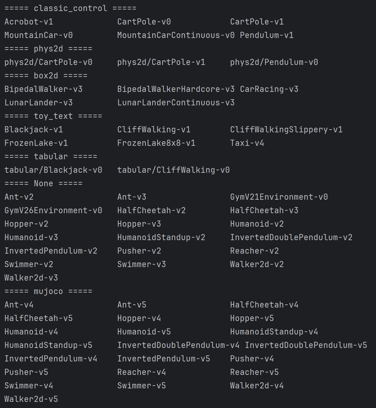

2.1 查看提供的所有环境
import gymnasium as gym
# To see all environments you can create
gym.pprint_registry()

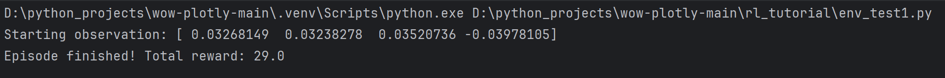

2.2 倒立摆环境的简单代码示例
# Run `pip install "gymnasium[classic-control]"` for this example.
from gymnasium.utils.save_video import save_video
# Create our training environment - a cart with a pole that needs balancing
# "render_mode" parameter that specifies how the environment should be visualized.
# See Env.render() for details on different render modes.
# The render mode determines whether you see a visual window (“human”),
# get image arrays (“rgb_array”), or run without visuals (None - fastest for training).
env = gym.make("CartPole-v1", render_mode="rgb_array_list")
# Reset environment to start a new episode
# For initializing the environment with a particular random seed or options (see the
# environment documentation for possible values) use the seed or options parameters with reset().
observation, info = env.reset()
# observation: what the agent can "see" - cart position, velocity, pole angle, etc.
# info: extra debugging information (usually not needed for basic learning)
print(f"Starting observation: {observation}")
# Example output: [ 0.01234567 -0.00987654  0.02345678  0.01456789]
# [cart_position, cart_velocity, pole_angle, pole_angular_velocity]
episode_over = False
total_reward = 0
# One such action-observation exchange is called a timestep.
while not episode_over:
    # Choose an action: 0 = push cart left, 1 = push cart right
    action = env.action_space.sample()  # Random action for now - real agents will be smarter!
    # Take the action and see what happens
    observation, reward, terminated, truncated, info = env.step(action)
    # reward: +1 for each step the pole stays upright
    # terminated: True if pole falls too far (agent failed)
    # truncated: True if we hit the time limit (500 steps)
    total_reward += reward
    episode_over = terminated or truncated
# 直接使用 env.render() 获取整个episode的帧列表
save_video(
    frames=env.render(), # 获取帧列表
    video_folder="videos",
    fps=env.metadata["render_fps"], # 从环境元数据中获取FPS,若报错可手动指定,如 fps=30[reference:3]
    name_prefix="manual_save",
print(f"Episode finished! Total reward: {total_reward}")
env.close()

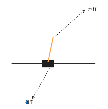

在这个环境中,智能体是推车。动作空间是推车的两个动作,向左推和向右推。状态空间是推车的位置,推车的速度,木杆的角度和木杆的角速度。奖励是推车采取向左推或者向右推的动作之后,只要木杆不倒下,奖励就加1。游戏的结束条件是推车将杆子推出了屏幕,杆子倒下和timestep超过500步。

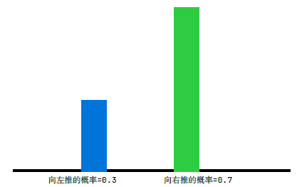

推车应该采取什么样的策略(policy),才能让杆子不倒下,获得不停的奖励。推车要采取的策略是一个函数。要采取的动作一般来说是一个概率分布。
要采取的动作的概率分布=策略函数(环境的状态)

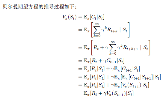

根据策略函数,每条轨迹都有一个产生的概率。评估在环境处于状态 𝑆𝑡 时,一直采取策略 𝜋 的预期回报(回报的期望值),这就是状态价值函数(State Value Function)。
或者
(贝尔曼期望方程)

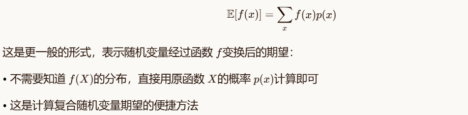

5.2 函数的期望公式

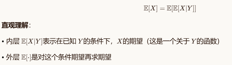

5.3 全期望公式

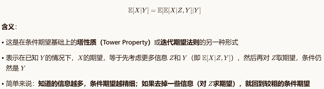

5.4 条件期望的迭代公式
5.5 期望的线性性质

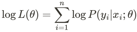

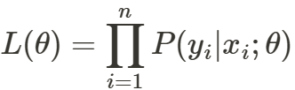

假设有训练数据  ,其中 yi 是真实标签。
似然函数:
对数似然:
最大化对数似然等价于最小化负对数似然,则交叉熵损失:

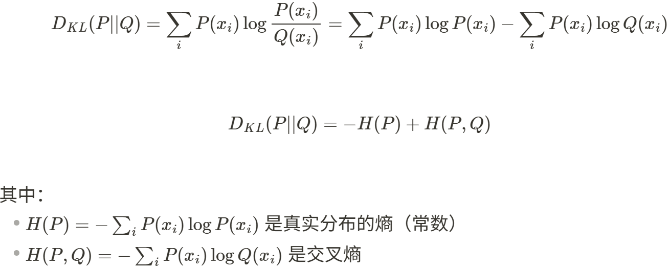

7.5 从 KL 散度到交叉熵
KL散度衡量两个分布的差异:
重要的推论:最小化散度就是最小化交叉熵
