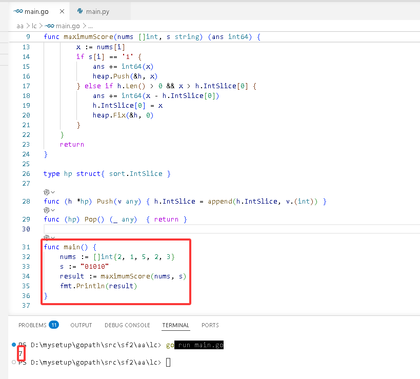

Go完整代码如下:
package main
import (
	"container/heap"
	"fmt"
	"sort"
func maximumScore(nums []int, s string) (ans int64) {
	h := hp{}
	// Traverse from the end to the beginning
	for i := len(nums) - 1; i >= 0; i-- {
		x := nums[i]
		if s[i] == '1' {
			ans += int64(x)
			heap.Push(&h, x)
		} else if h.Len() > 0 && x > h.IntSlice[0] {
			ans += int64(x - h.IntSlice[0])
			h.IntSlice[0] = x
			heap.Fix(&h, 0)
	return
type hp struct{ sort.IntSlice }
func (h *hp) Push(v any) { h.IntSlice = append(h.IntSlice, v.(int)) }
func (hp) Pop() (_ any)  { return }
func main() {
	nums := []int{2, 1, 5, 2, 3}
	s := "01010"
	result := maximumScore(nums, s)
	fmt.Println(result)

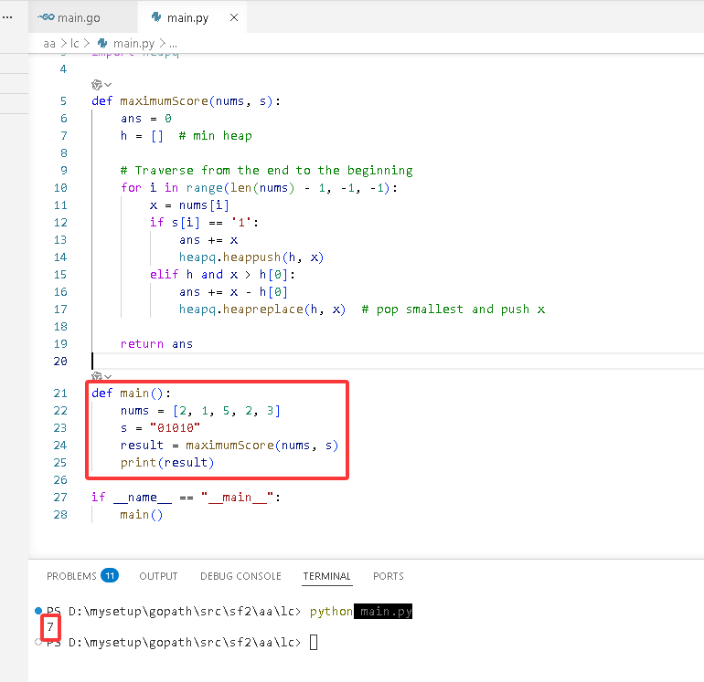

Python完整代码如下:
# -*-coding:utf-8-*-
import heapq
def maximumScore(nums, s):
    ans = 0
    h = []  # min heap
    # Traverse from the end to the beginning
    for i in range(len(nums) - 1, -1, -1):
        x = nums[i]
        if s[i] == '1':
            ans += x
            heapq.heappush(h, x)
        elif h and x > h[0]:
            ans += x - h[0]
            heapq.heapreplace(h, x)  # pop smallest and push x
    return ans
def main():
    nums = [2, 1, 5, 2, 3]
    s = "01010"
    result = maximumScore(nums, s)
    print(result)
if __name__ == "__main__":
    main()

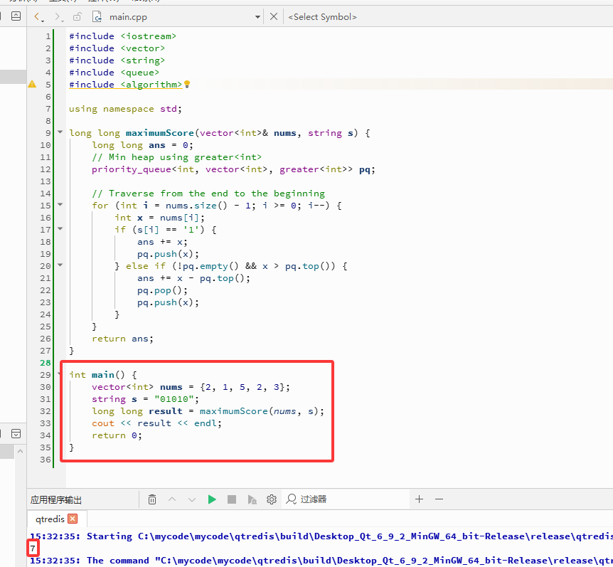

C++完整代码如下:
#include <iostream>
#include <vector>
#include <string>
#include <queue>
#include <algorithm>
using namespace std;
long long maximumScore(vector<int>& nums, string s) {
    long long ans = 0;
    // Min heap using greater<int>
    priority_queue<int, vector<int>, greater<int>> pq;
    for (int i = nums.size() - 1; i >= 0; i--) {
        int x = nums[i];
        if (s[i] == '1') {
            ans += x;
            pq.push(x);
        } else if (!pq.empty() && x > pq.top()) {
            ans += x - pq.top();
            pq.pop();
            pq.push(x);
    return ans;
int main() {
    vector<int> nums = {2, 1, 5, 2, 3};
    string s = "01010";
    long long result = maximumScore(nums, s);
    cout << result << endl;
    return 0;
