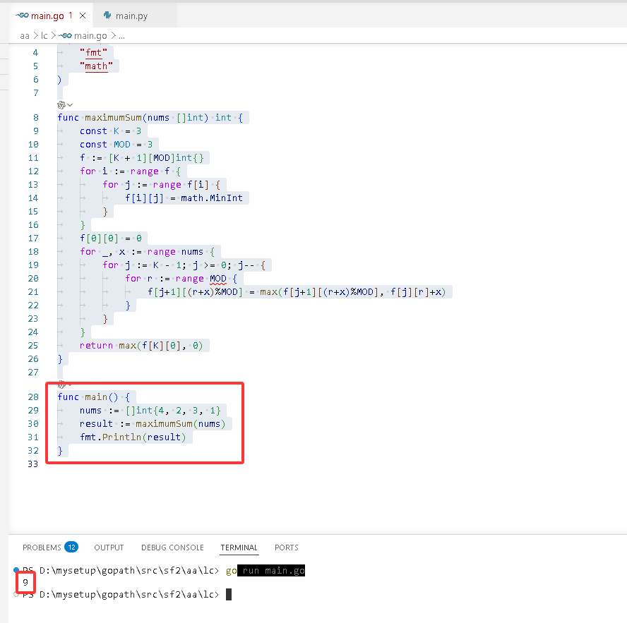

Go完整代码如下:
package main
import (
	"fmt"
	"math"
func maximumSum(nums []int) int {
	const K = 3
	const MOD = 3
	f := [K + 1][MOD]int{}
	for i := range f {
		for j := range f[i] {
			f[i][j] = math.MinInt
	f[0][0] = 0
	for _, x := range nums {
		for j := K - 1; j >= 0; j-- {
			for r := range MOD {
				f[j+1][(r+x)%MOD] = max(f[j+1][(r+x)%MOD], f[j][r]+x)
	return max(f[K][0], 0)
func main() {
	nums := []int{4, 2, 3, 1}
	result := maximumSum(nums)
	fmt.Println(result)

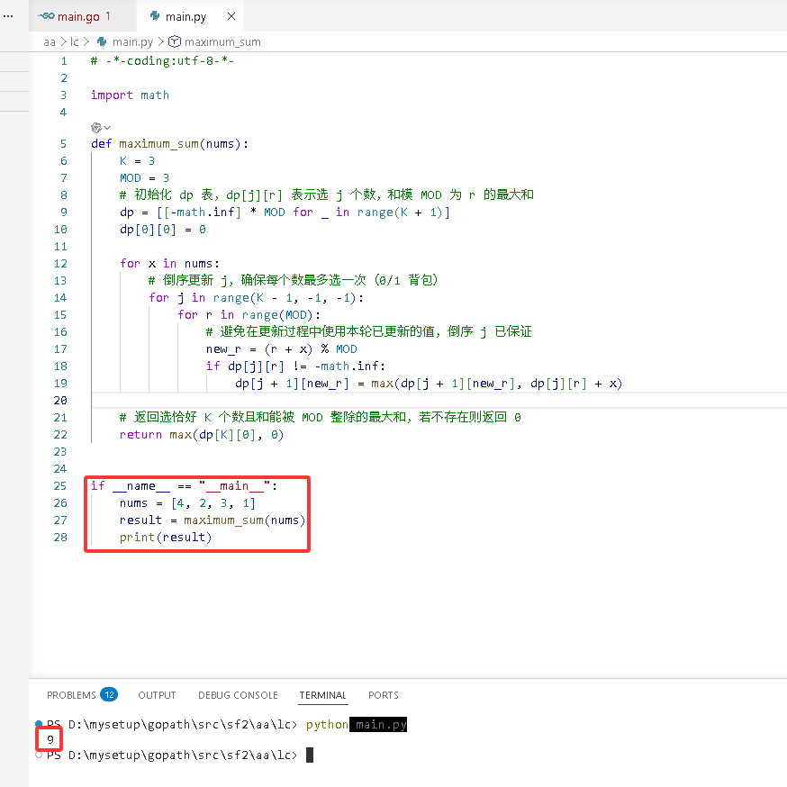

Python完整代码如下:
# -*-coding:utf-8-*-
import math
def maximum_sum(nums):
    K = 3
    MOD = 3
    # 初始化 dp 表,dp[j][r] 表示选 j 个数,和模 MOD 为 r 的最大和
    dp = [[-math.inf] * MOD for _ in range(K + 1)]
    dp[0][0] = 0
    for x in nums:
        # 倒序更新 j,确保每个数最多选一次(0/1 背包)
        for j in range(K - 1, -1, -1):
            for r in range(MOD):
                # 避免在更新过程中使用本轮已更新的值,倒序 j 已保证
                new_r = (r + x) % MOD
                if dp[j][r] != -math.inf:
                    dp[j + 1][new_r] = max(dp[j + 1][new_r], dp[j][r] + x)
    # 返回选恰好 K 个数且和能被 MOD 整除的最大和,若不存在则返回 0
    return max(dp[K][0], 0)
if __name__ == "__main__":
    nums = [4, 2, 3, 1]
    result = maximum_sum(nums)
    print(result)

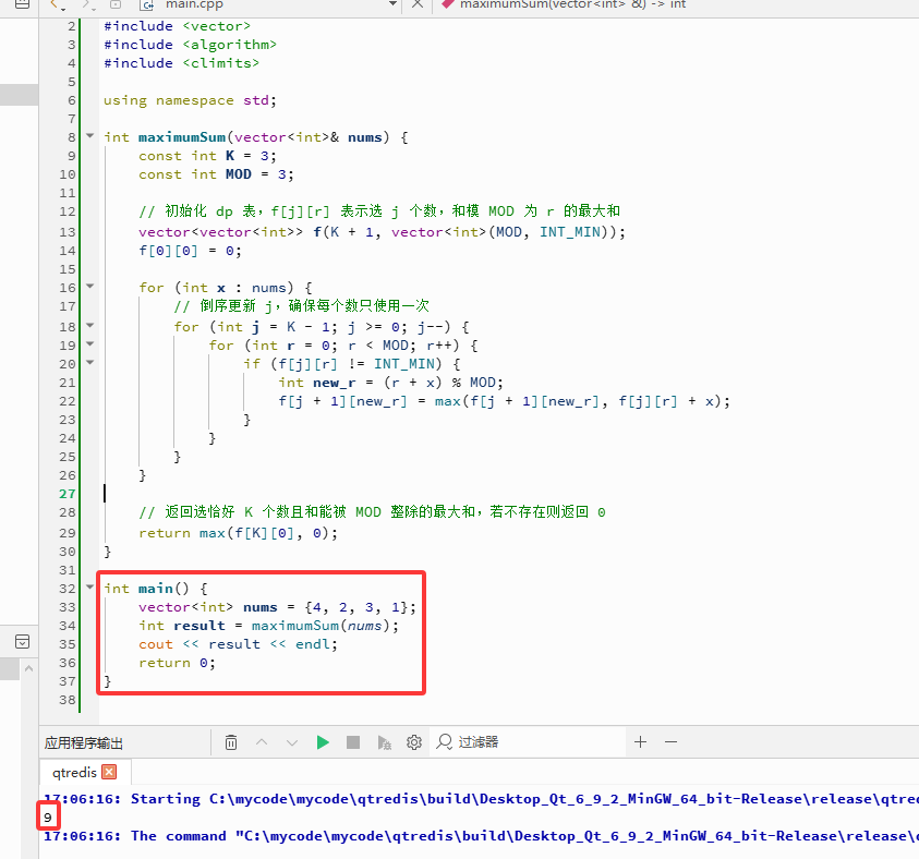

C++完整代码如下:
#include <iostream>
#include <vector>
#include <algorithm>
#include <climits>
using namespace std;
int maximumSum(vector<int>& nums) {
    const int K = 3;
    const int MOD = 3;
    // 初始化 dp 表,f[j][r] 表示选 j 个数,和模 MOD 为 r 的最大和
    vector<vector<int>> f(K + 1, vector<int>(MOD, INT_MIN));
    f[0][0] = 0;
    for (int x : nums) {
        // 倒序更新 j,确保每个数只使用一次
        for (int j = K - 1; j >= 0; j--) {
            for (int r = 0; r < MOD; r++) {
                if (f[j][r] != INT_MIN) {
                    int new_r = (r + x) % MOD;
                    f[j + 1][new_r] = max(f[j + 1][new_r], f[j][r] + x);
    // 返回选恰好 K 个数且和能被 MOD 整除的最大和,若不存在则返回 0
    return max(f[K][0], 0);
int main() {
    vector<int> nums = {4, 2, 3, 1};
    int result = maximumSum(nums);
    cout << result << endl;
    return 0;
