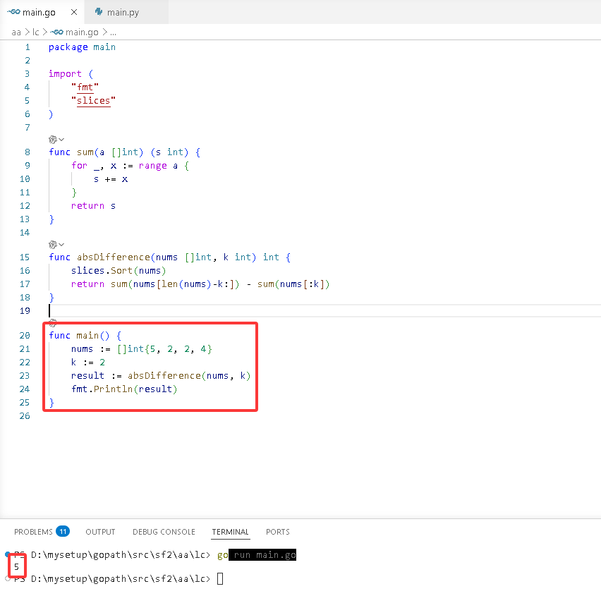

Go完整代码如下:
package main
import (
	"fmt"
	"slices"
func sum(a []int) (s int) {
	for _, x := range a {
		s += x
	return s
func absDifference(nums []int, k int) int {
	slices.Sort(nums)
	return sum(nums[len(nums)-k:]) - sum(nums[:k])
func main() {
	nums := []int{5, 2, 2, 4}
	k := 2
	result := absDifference(nums, k)
	fmt.Println(result)

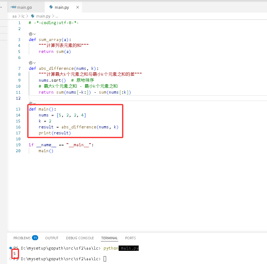

Python完整代码如下:
# -*-coding:utf-8-*-
def sum_array(a):
    """计算列表元素的和"""
    return sum(a)
def abs_difference(nums, k):
    """计算最大k个元素之和与最小k个元素之和的差"""
    nums.sort()  # 原地排序
    # 最大k个元素之和 - 最小k个元素之和
    return sum(nums[-k:]) - sum(nums[:k])
def main():
    nums = [5, 2, 2, 4]
    k = 2
    result = abs_difference(nums, k)
    print(result)
if __name__ == "__main__":
    main()

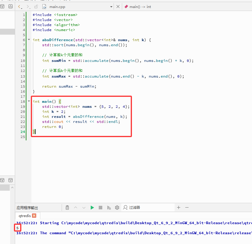

C++完整代码如下:
#include <iostream>
#include <vector>
#include <algorithm>
#include <numeric>
int absDifference(std::vector<int>& nums, int k) {
    std::sort(nums.begin(), nums.end());
    // 计算前k个元素的和
    int sumMin = std::accumulate(nums.begin(), nums.begin() + k, 0);
    // 计算后k个元素的和
    int sumMax = std::accumulate(nums.end() - k, nums.end(), 0);
    return sumMax - sumMin;
int main() {
    std::vector<int> nums = {5, 2, 2, 4};
    int k = 2;
    int result = absDifference(nums, k);
    std::cout << result << std::endl;
    return 0;
