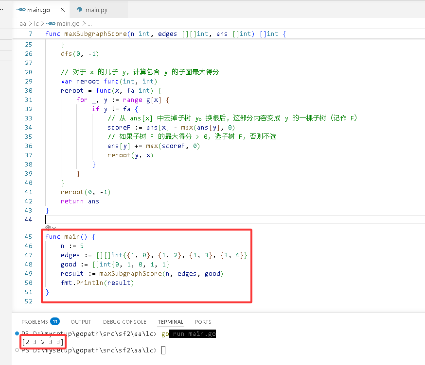

Go完整代码如下:
package main
import (
	"fmt"
func maxSubgraphScore(n int, edges [][]int, ans []int) []int {
	g := make([][]int, n)
	for _, e := range edges {
		x, y := e[0], e[1]
		g[x] = append(g[x], y)
		g[y] = append(g[y], x)
	var dfs func(int, int)
	dfs = func(x, fa int) {
		ans[x] = ans[x]*2 - 1
		for _, y := range g[x] {
			if y != fa {
				dfs(y, x)
				// 如果子树 y 的最大得分 > 0,选子树 y,否则不选
				ans[x] += max(ans[y], 0)
	dfs(0, -1)
	// 对于 x 的儿子 y,计算包含 y 的子图最大得分
	var reroot func(int, int)
	reroot = func(x, fa int) {
			if y != fa {
				// 从 ans[x] 中去掉子树 y。换根后,这部分内容变成 y 的一棵子树(记作 F)
				scoreF := ans[x] - max(ans[y], 0)
				// 如果子树 F 的最大得分 > 0,选子树 F,否则不选
				ans[y] += max(scoreF, 0)
				reroot(y, x)
	reroot(0, -1)
	return ans
func main() {
	n := 5
	edges := [][]int{{1, 0}, {1, 2}, {1, 3}, {3, 4}}
	good := []int{0, 1, 0, 1, 1}
	result := maxSubgraphScore(n, edges, good)
	fmt.Println(result)

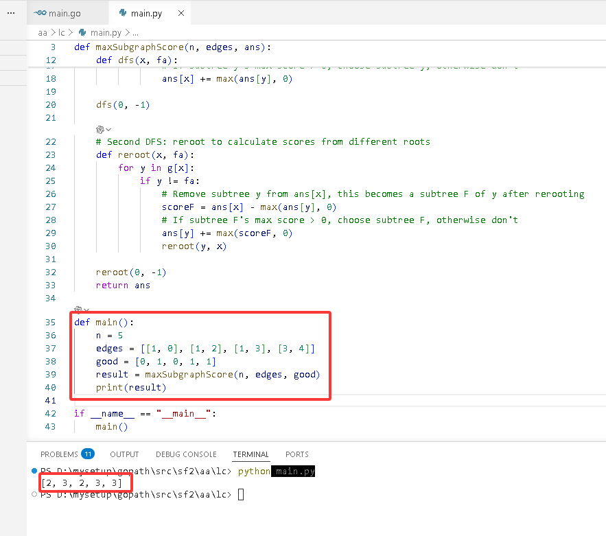

Python完整代码如下:
# -*-coding:utf-8-*-
def maxSubgraphScore(n, edges, ans):
    # Build adjacency list
    g = [[] for _ in range(n)]
    for e in edges:
        x, y = e[0], e[1]
        g[x].append(y)
        g[y].append(x)
    # First DFS: calculate scores from bottom up
    def dfs(x, fa):
        ans[x] = ans[x] * 2 - 1
        for y in g[x]:
            if y != fa:
                dfs(y, x)
                # If subtree y's max score > 0, choose subtree y, otherwise don't
    dfs(0, -1)
    # Second DFS: reroot to calculate scores from different roots
    def reroot(x, fa):
        for y in g[x]:
            if y != fa:
                # Remove subtree y from ans[x], this becomes a subtree F of y after rerooting
                scoreF = ans[x] - max(ans[y], 0)
                # If subtree F's max score > 0, choose subtree F, otherwise don't
                reroot(y, x)
    reroot(0, -1)
    return ans
def main():
    n = 5
    edges = [[1, 0], [1, 2], [1, 3], [3, 4]]
    good = [0, 1, 0, 1, 1]
    result = maxSubgraphScore(n, edges, good)
    print(result)
if __name__ == "__main__":
    main()

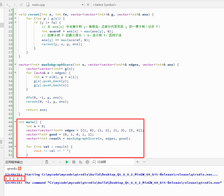

#include <iostream>
#include <vector>
#include <algorithm>
using namespace std;
void dfs(int x, int fa, vector<vector<int>>& g, vector<int>& ans) {
    ans[x] = ans[x] * 2 - 1;
    for (int y : g[x]) {
        if (y != fa) {
            dfs(y, x, g, ans);
            ans[x] += max(ans[y], 0);
void reroot(int x, int fa, vector<vector<int>>& g, vector<int>& ans) {
        if (y != fa) {
            int scoreF = ans[x] - max(ans[y], 0);
            ans[y] += max(scoreF, 0);
            reroot(y, x, g, ans);
vector<int> maxSubgraphScore(int n, vector<vector<int>>& edges, vector<int>& ans) {
    vector<vector<int>> g(n);
    for (auto& e : edges) {
        int x = e[0], y = e[1];
        g[x].push_back(y);
        g[y].push_back(x);
    dfs(0, -1, g, ans);
    reroot(0, -1, g, ans);
    return ans;
int main() {
    int n = 5;
    vector<vector<int>> edges = {{1, 0}, {1, 2}, {1, 3}, {3, 4}};
    vector<int> good = {0, 1, 0, 1, 1};
    vector<int> result = maxSubgraphScore(n, edges, good);
    for (int val : result) {
        cout << val << " ";
    cout << endl;
    return 0;
