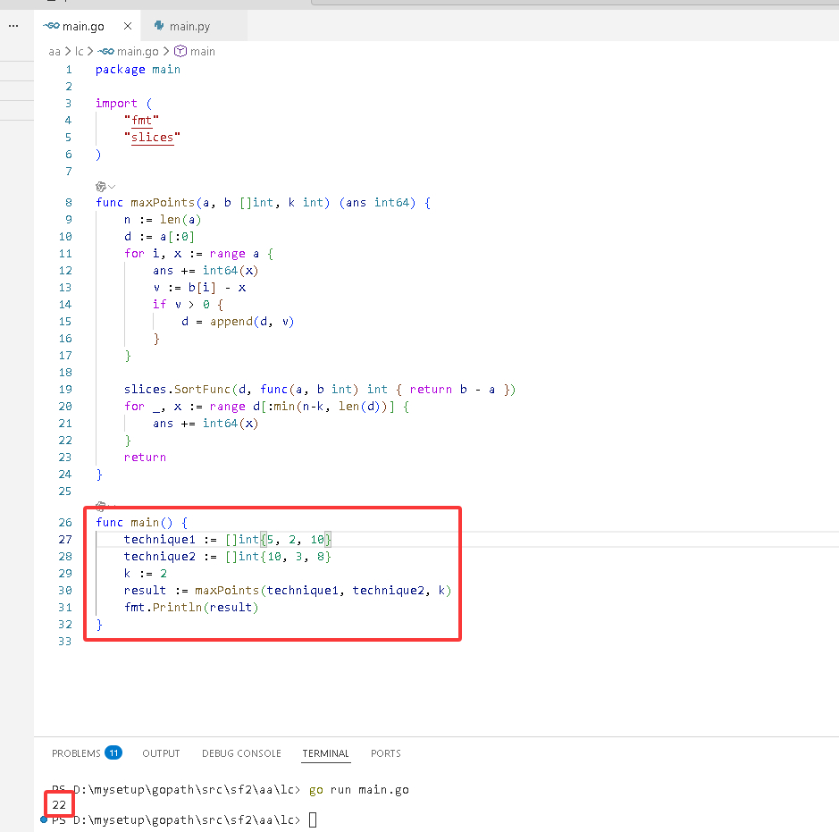

Go完整代码如下:
package main
import (
	"fmt"
	"slices"
func maxPoints(a, b []int, k int) (ans int64) {
	n := len(a)
	d := a[:0]
	for i, x := range a {
		ans += int64(x)
		v := b[i] - x
		if v > 0 {
			d = append(d, v)
	slices.SortFunc(d, func(a, b int) int { return b - a })
	for _, x := range d[:min(n-k, len(d))] {
		ans += int64(x)
	return
func main() {
	technique1 := []int{5, 2, 10}
	technique2 := []int{10, 3, 8}
	k := 2
	result := maxPoints(technique1, technique2, k)
	fmt.Println(result)
