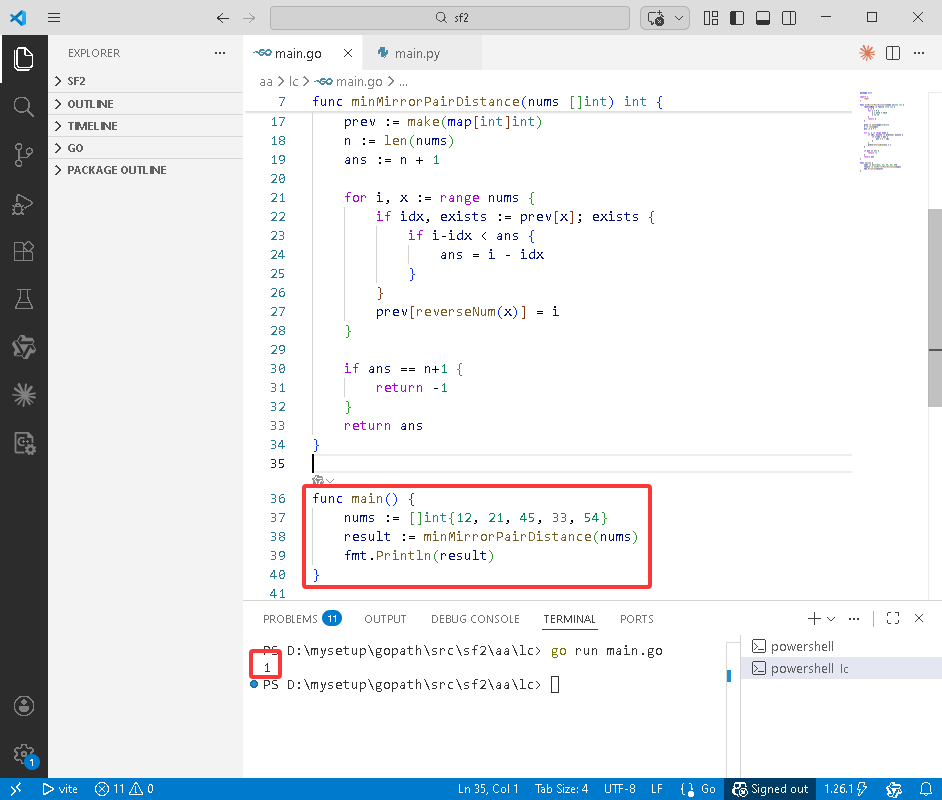

Go完整代码如下:
package main
import (
	"fmt"
func minMirrorPairDistance(nums []int) int {
	reverseNum := func(x int) int {
		y := 0
		for x > 0 {
			y = y*10 + x%10
			x /= 10
		return y
	prev := make(map[int]int)
	n := len(nums)
	ans := n + 1
	for i, x := range nums {
		if idx, exists := prev[x]; exists {
			if i-idx < ans {
				ans = i - idx
		prev[reverseNum(x)] = i
	if ans == n+1 {
		return -1
	return ans
func main() {
	nums := []int{12, 21, 45, 33, 54}
	result := minMirrorPairDistance(nums)
	fmt.Println(result)

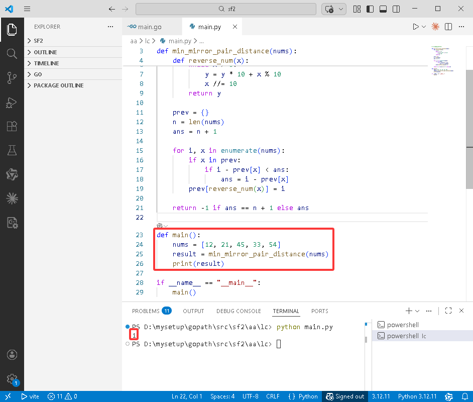

Python完整代码如下:
# -*-coding:utf-8-*-
def min_mirror_pair_distance(nums):
    def reverse_num(x):
        y = 0
        while x > 0:
            y = y * 10 + x % 10
            x //= 10
        return y
    prev = {}
    n = len(nums)
    ans = n + 1
    for i, x in enumerate(nums):
        if x in prev:
            if i - prev[x] < ans:
                ans = i - prev[x]
        prev[reverse_num(x)] = i
    return -1 if ans == n + 1 else ans
def main():
    nums = [12, 21, 45, 33, 54]
    result = min_mirror_pair_distance(nums)
    print(result)
if __name__ == "__main__":
    main()

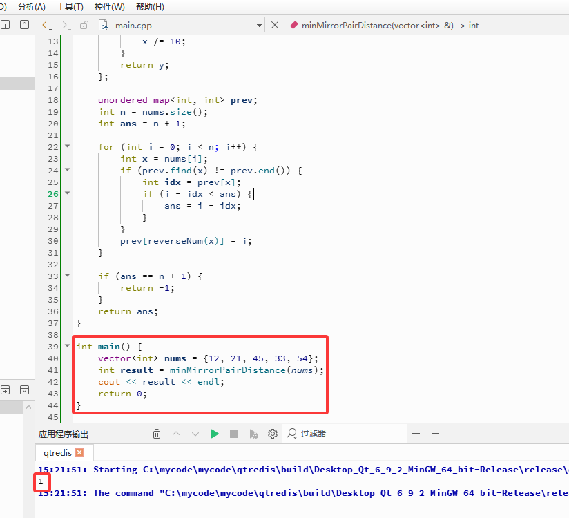

C++完整代码如下:
#include <iostream>
#include <vector>
#include <unordered_map>
#include <algorithm>
using namespace std;
int minMirrorPairDistance(vector<int>& nums) {
    auto reverseNum = [](int x) -> int {
        int y = 0;
        while (x > 0) {
            y = y * 10 + x % 10;
            x /= 10;
        return y;
    unordered_map<int, int> prev;
    int n = nums.size();
    int ans = n + 1;
    for (int i = 0; i < n; i++) {
        int x = nums[i];
        if (prev.find(x) != prev.end()) {
            int idx = prev[x];
            if (i - idx < ans) {
                ans = i - idx;
        prev[reverseNum(x)] = i;
    if (ans == n + 1) {
        return -1;
    return ans;
int main() {
    vector<int> nums = {12, 21, 45, 33, 54};
    int result = minMirrorPairDistance(nums);
    cout << result << endl;
    return 0;
