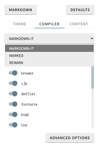

3. 升级: marked、markdown-it、remark
Markdown Viewer 中集成了:marked、markdown-it、remark 这三种编译器,用于将markdown 文件转成 Html 文件,然后在浏览器中展示。

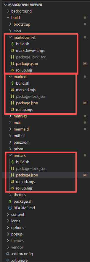

  • 见面上的三个编译器:
  • 代码结构
参照下面的方法,依次升级: marked、markdown-it、remark .

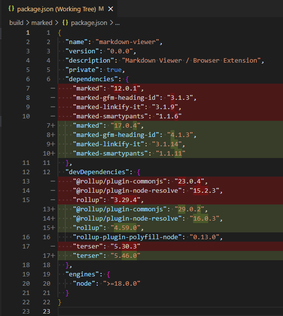

3.1. 升级 marked
3.1.1. 更新版本
/markdown-viewer/build/marked# ncu -u
Upgrading /markdown-viewer/build/marked/package.json
[====================] 9/9 100%
 @rollup/plugin-commonjs      23.0.4  →  29.0.2
 @rollup/plugin-node-resolve  15.2.3  →  16.0.3
 marked                       12.0.1  →  17.0.4
 marked-gfm-heading-id         3.1.3  →   4.1.3
 marked-linkify-it             3.1.9  →  3.1.14
 marked-smartypants            1.1.6  →  1.1.11
 rollup                       3.29.4  →  4.59.0
 terser                       5.30.3  →  5.46.0
Run npm install to install new versions.
  • 更新后 package.json 变动如下:
3.1.2. 安装升级的版本
/markdown-viewer/build/marked# npm install
added 44 packages in 3s
5 packages are looking for funding
  run `npm fund` for details
/markdown-viewer/build/marked# npm fund
markdown-viewer@0.0.0
+-- https://github.com/sponsors/jonschlinkert
|   `-- picomatch@4.0.3
`-- https://github.com/sponsors/ljharb
    `-- resolve@1.22.11, is-core-module@2.16.1, function-bind@1.1.2, supports-preserve-symlinks-flag@1.0.0
3.1.3. 构建升级后的版本
/markdown-viewer/build/marked# ./build.sh
added 43 packages, and audited 44 packages in 3s
found 0 vulnerabilities
marked.mjs → tmp/marked.js...
created tmp/marked.js in 576ms
3.1.4. 版本的差异
从package.json 文件的变动差异,可以看到版本从:12.0.1 → 17.0.4。版本的跨度很大。

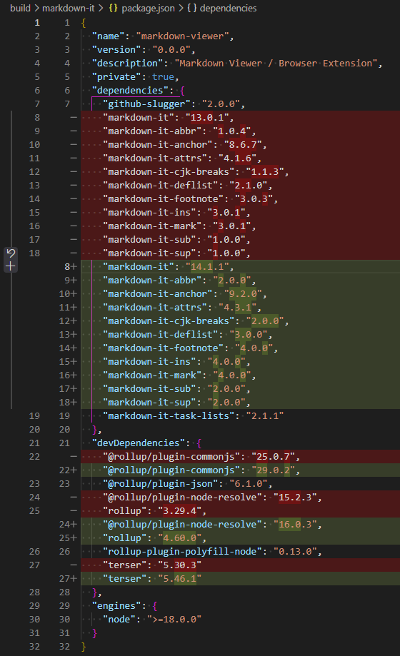

3.2. 升级 markdown-it
3.2.1. 更新版本
/markdown-viewer/build/markdown-it# ncu -u
Upgrading /mnt/d/git/markdown_viewer/markdown-viewer/build/markdown-it/package.json
[====================] 19/19 100%
 @rollup/plugin-commonjs      25.0.7  →  29.0.2
 markdown-it                  13.0.1  →  14.1.1
 markdown-it-abbr              1.0.4  →   2.0.0
 markdown-it-anchor            8.6.7  →   9.2.0
 markdown-it-attrs             4.1.6  →   4.3.1
 markdown-it-cjk-breaks        1.1.3  →   2.0.0
 markdown-it-deflist           2.1.0  →   3.0.0
 markdown-it-footnote          3.0.3  →   4.0.0
 markdown-it-ins               3.0.1  →   4.0.0
 markdown-it-mark              3.0.1  →   4.0.0
 markdown-it-sub               1.0.0  →   2.0.0
 markdown-it-sup               1.0.0  →   2.0.0
 rollup                       3.29.4  →  4.60.0
 terser                       5.30.3  →  5.46.1
3.2.2. 安装升级的版本
/markdown-viewer/build/markdown-it# npm install
added 1 package, removed 2 packages, changed 2 packages, and audited 59 packages in 5s
7 packages are looking for funding
3.2.3. 构建升级后的版本
/markdown-viewer/build/markdown-it# ./build.sh
added 59 packages, and audited 60 packages in 4s
markdown-it.mjs → tmp/markdown-it.js...
created tmp/markdown-it.js in 1.2s
3.2.4. 版本的差异
从package.json 文件的变动差异,可以看到版本从:13.0.1 → 14.1.1。

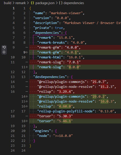

3.3. 升级 remark
3.3.1. 更新版本
/markdown-viewer/build/remark# ncu -u
Upgrading /markdown-viewer/build/remark/package.json
[====================] 10/10 100%
 remark-gfm                    4.0.0  →   4.0.1
 remark-slug                   7.0.1  →   8.0.0
3.3.2. 安装升级的版本
/markdown-viewer/build/remark# npm install
npm warn deprecated inflight@1.0.6: This module is not supported, and leaks memory. Do not use it. Check out lru-cache if you want a good and tested way to coalesce async requests by a key value, which is much more comprehensive and powerful.
npm warn deprecated glob@8.1.0: Old versions of glob are not supported, and contain widely publicized security vulnerabilities, which have been fixed in the current version. Please update. Support for old versions may be purchased (at exorbitant rates) by contacting i@izs.me
added 144 packages, and audited 145 packages in 16s
95 packages are looking for funding
1 high severity vulnerability
To address all issues, run:
  npm audit fix --force
Run `npm audit` for details.
3.3.3. 构建升级后的版本
/markdown-viewer/build/remark# ./build.sh
added 144 packages, and audited 145 packages in 4s
remark.mjs → tmp/remark.js...
created tmp/remark.js in 4.9s
3.3.4. 版本的差异
从package.json 文件的看到版本:15.0.1,并没有变动。只更新了依赖包。
