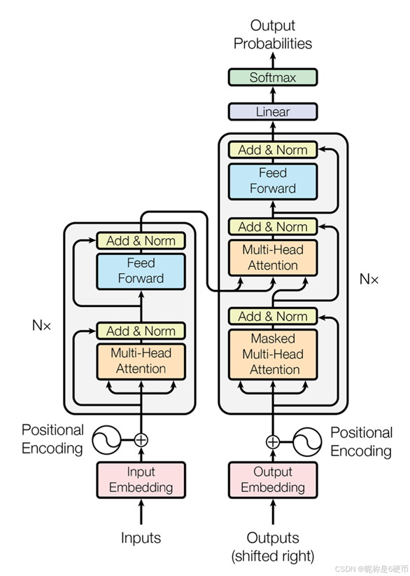

    接下来,我们可以让AI Coding工具生成一个完全展开实现的tansformer模型结构,不用高阶api,这样它可以所有关键环节全部展开,让我们能够完全与论文细节对应上,阅读完论文,再理解和运行完这个代码,实际训练一个大模型demo(虽然是完全虚拟的数据集),但对transformer模型结构和训练过程会有了清晰的认知。

class PositionalEncoding(nn.Module):
"""位置编码层"""
def __init__(self, d_model, max_len=5000):
super(PositionalEncoding, self).__init__()
# 创建位置编码矩阵
pe = torch.zeros(max_len, d_model)
position = torch.arange(0, max_len).unsqueeze(1).float()
# 使用sin和cos函数计算位置编码
div_term = torch.exp(torch.arange(0, d_model, 2).float() *
-(math.log(10000.0) / d_model))
pe[:, 0::2] = torch.sin(position * div_term) # 偶数位置
pe[:, 1::2] = torch.cos(position * div_term) # 奇数位置
# 注册为buffer,这样它不会被优化器更新
self.register_buffer('pe', pe.unsqueeze(0))
def forward(self, x):
# 将位置编码添加到输入中
return x + self.pe[:, :x.size(1)]
class MultiHeadAttention(nn.Module):
"""多头注意力机制"""
def __init__(self, d_model, num_heads):
super(MultiHeadAttention, self).__init__()
assert d_model % num_heads == 0
self.d_model = d_model
self.num_heads = num_heads
self.d_k = d_model // num_heads
# 定义线性变换层
self.W_q = nn.Linear(d_model, d_model)
self.W_k = nn.Linear(d_model, d_model)
self.W_v = nn.Linear(d_model, d_model)
self.W_o = nn.Linear(d_model, d_model)
def forward(self, query, key, value, mask=None):
batch_size = query.size(0)
# 线性变换
Q = self.W_q(query)
K = self.W_k(key)
V = self.W_v(value)
# 将Q, K, V分割成多头
Q = Q.view(batch_size, -1, self.num_heads, self.d_k).transpose(1, 2)
K = K.view(batch_size, -1, self.num_heads, self.d_k).transpose(1, 2)
V = V.view(batch_size, -1, self.num_heads, self.d_k).transpose(1, 2)
# 计算注意力分数
scores = torch.matmul(Q, K.transpose(-2, -1)) / math.sqrt(self.d_k)
# 应用掩码(如果提供)
if mask is not None:
scores = scores.masked_fill(mask == 0, -1e9)
# 应用softmax
attention_weights = torch.softmax(scores, dim=-1)
# 计算输出
output = torch.matmul(attention_weights, V)
# 重新组合多头
output = output.transpose(1, 2).contiguous().view(batch_size, -1, self.d_model)
# 最后的线性变换
return self.W_o(output)
class FeedForward(nn.Module):
"""前馈网络"""
def __init__(self, d_model, d_ff):
super(FeedForward, self).__init__()
self.linear1 = nn.Linear(d_model, d_ff)
self.linear2 = nn.Linear(d_ff, d_model)
self.relu = nn.ReLU()
return self.linear2(self.relu(self.linear1(x)))
class EncoderLayer(nn.Module):
"""编码器层"""
def __init__(self, d_model, num_heads, d_ff, dropout=0.1):
super(EncoderLayer, self).__init__()
self.self_attention = MultiHeadAttention(d_model, num_heads)
self.feed_forward = FeedForward(d_model, d_ff)
self.norm1 = nn.LayerNorm(d_model)
self.norm2 = nn.LayerNorm(d_model)
self.dropout = nn.Dropout(dropout)
def forward(self, x, mask=None):
# 自注意力机制
attended = self.self_attention(x, x, x, mask)
x = self.norm1(x + self.dropout(attended))
# 前馈网络
ff_out = self.feed_forward(x)
x = self.norm2(x + self.dropout(ff_out))
return x
class DecoderLayer(nn.Module):
"""解码器层"""
super(DecoderLayer, self).__init__()
self.cross_attention = MultiHeadAttention(d_model, num_heads)
self.norm3 = nn.LayerNorm(d_model)
def forward(self, x, encoder_output, src_mask=None, tgt_mask=None):
# 自注意力机制
attended = self.self_attention(x, x, x, tgt_mask)
# 交叉注意力机制
attended = self.cross_attention(x, encoder_output, encoder_output, src_mask)
x = self.norm2(x + self.dropout(attended))
# 前馈网络
x = self.norm3(x + self.dropout(ff_out))
return x
class Transformer(nn.Module):
"""完整的Transformer模型"""
def __init__(self, src_vocab_size, tgt_vocab_size, d_model, num_heads, num_layers, d_ff, max_seq_length, dropout=0.1):
super(Transformer, self).__init__()
# 词嵌入层
self.src_embedding = nn.Embedding(src_vocab_size, d_model)
self.tgt_embedding = nn.Embedding(tgt_vocab_size, d_model)
# 位置编码
self.positional_encoding = PositionalEncoding(d_model, max_seq_length)
# 编码器和解码器层
self.encoder_layers = nn.ModuleList([EncoderLayer(d_model, num_heads, d_ff, dropout) for _ in range(num_layers)])
self.decoder_layers = nn.ModuleList([DecoderLayer(d_model, num_heads, d_ff, dropout) for _ in range(num_layers)])
# 输出线性层
self.fc_out = nn.Linear(d_model, tgt_vocab_size)
def make_src_mask(self, src):
# 为源序列创建掩码(通常在机器翻译中用于忽略填充标记)
src_mask = (src != 0).unsqueeze(1).unsqueeze(2)
return src_mask
def make_tgt_mask(self, tgt):
# 为目标序列创建掩码(用于防止模型看到未来的信息)
tgt_len = tgt.size(1)
tgt_mask = (tgt != 0).unsqueeze(1).unsqueeze(3)
subsequent_mask = torch.tril(torch.ones((tgt_len, tgt_len), device=tgt.device)).unsqueeze(0).unsqueeze(1)
tgt_mask = tgt_mask & subsequent_mask.bool()
return tgt_mask
def forward(self, src, tgt):
# 获取掩码
src_mask = self.make_src_mask(src)
tgt_mask = self.make_tgt_mask(tgt)
# 词嵌入
src_embedded = self.dropout(self.positional_encoding(self.src_embedding(src) * math.sqrt(self.d_model)))
tgt_embedded = self.dropout(self.positional_encoding(self.tgt_embedding(tgt) * math.sqrt(self.d_model)))
# 编码器处理
enc_output = src_embedded
for layer in self.encoder_layers:
enc_output = layer(enc_output, src_mask)
# 解码器处理
dec_output = tgt_embedded
for layer in self.decoder_layers:
dec_output = layer(dec_output, enc_output, src_mask, tgt_mask)
# 输出层
output = self.fc_out(dec_output)
return output

     跑完这个demo后,也可以借助AI Coding去跑一些中译英真实数据集(前提是有GPU/NPU卡),会更有成就感。当然,基于AI再去学习大模型微调、蒸馏、推理,也就很容易了。
     学习完这一套组合拳后,会发现在AI时代,很多技术一旦公布,就没有秘密可言了。站在现在再去看2017年那几位作者,为何能写出这篇论文,我认为不是他们编程能力有多强,而是他们高等数学很厉害,且有各种实验调参的尝试,最后能够设计和验证出transformer这种新的模型架构。站在今天看未来,有了AI加持后,个人编程能力高低不重要了,但重要的是基础科学(数学、物理等知识)是否扎实,是否有创新思维,是否敢于不断尝试和验证,这些能力和品质更为重要了。
