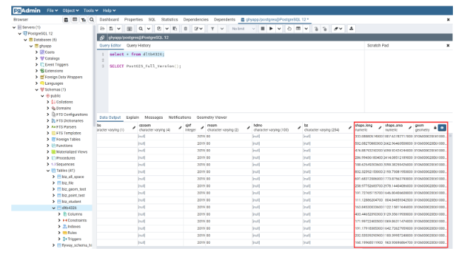

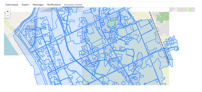

        在设计好数据库表结构后,需要进行数据初始化,如何在数据库中进行数据初始化这里不做大量讲解,数据展示如下:
  可以在pgAdmin中进行空间字段的展示,在查询出来的最后一个空间字段有一个预览的按钮,鼠标左键点击即可完成数据预览,效果如下所示:

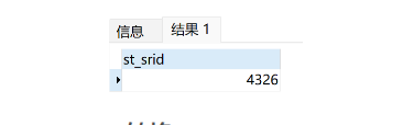

select st_srid(geom) from dltb4326 limit 1;
函数运行之后得到的结果如下:

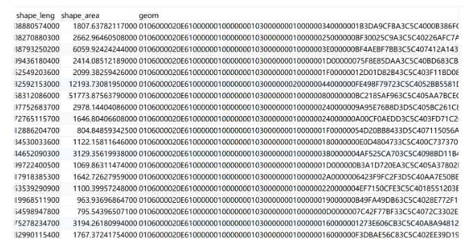

在空间数据库中,为了保持存储的高效性,通常来说,数据是存储为二进制的,比如以下的格式:
 以上的格式虽然对于数据存储来说是最高效的,但是对用户来讲,可读性是较差的,geojson是一种面向地理数据格式的json数据格式,具有可读性高的优点。在postGIS中,通过st_asgeojson进行数据转换。

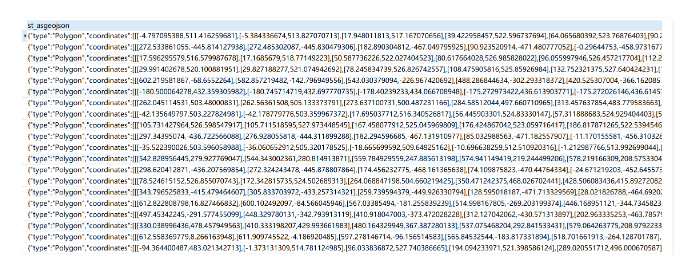

select st_asgeojson(geom) from dltb4326;
其中一条geojson数据如下所示:
{"type":"MultiPolygon","coordinates":[[[[112.948902049,28.031646521],[112.948934463,28.031602495],[112.948947087,28.03160557],[112.948990862,28.031516143],[112.948970512,28.031507049],[112.948915856,28.031482624],[112.948953672,28.031411773],[112.948989778,28.031426021],[112.949058815,28.031135666],[112.948993581,28.031122934],[112.948972683,28.031147219],[112.948939525,28.031192802],[112.948837509,28.031234815],[112.948830726,28.031238787],[112.948818769,28.031259925],[112.948799172,28.031296293],[112.948793881,28.031313083],[112.948783858,28.031341866],[112.948778722,28.031356612],[112.948761457,28.031402316],[112.948760048,28.031405735],[112.948759101,28.031427842],[112.948823424,28.031465486],[112.948871536,28.031498082],[112.948876579,28.031532736],[112.948861376,28.031574397],[112.94883146,28.031607591],[112.948813904,28.031614619],[112.94878463,28.03162494],[112.948777458,28.031627469],[112.948740873,28.031654644],[112.948627326,28.031849531],[112.948564719,28.031924253],[112.9485632,28.031942145],[112.948503091,28.032004376],[112.948436182,28.032106517],[112.948384475,28.032166996],[112.94830902,28.032192929],[112.948370033,28.032250988],[112.948396715,28.032267267],[112.94840872,28.032274592],[112.948418868,28.032262969],[112.948557256,28.032104472],[112.948640482,28.032009154],[112.948787309,28.031840991],[112.94880614,28.031819424],[112.948808544,28.031816671],[112.948832592,28.031789129],[112.94885082,28.03173793],[112.948851228,28.031737165],[112.948893567,28.031658044],[112.948902049,28.031646521]]]]}
在拿到geojson后,许多前端gis框架,比如leaflet、cesium、openlayers都可以直接进行展示。

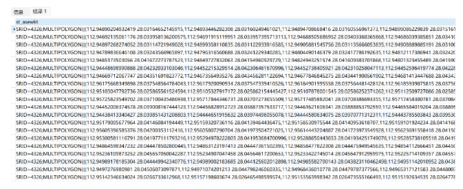

在上面的空间表中进行查询验证。
select st_asewkt(geom) from dltb4326;
SRID=4326;MULTIPOLYGON(((112.94890204932419 28.03164652145915,112.94893446282308 28.03160249461021,112.94894708668416 28.03160556961373,112.94899086229839 28.03151614262633,112.94897051189844 28.03150704851138,112.94891585590196 28.03148262432319,112.94895367222296 28.0314117725388,112.94898977797723 28.031426021004112,112.94905881545756 28.031135666053835,112.94899358110835 28.031122933916585,112.94897268274052 28.03114721949028,112.94893952469715 28.03119280160087,112.94883750860863 28.031234815284318,112.94883072625771 28.031238786653255,112.94881876908642 28.03125992489088,112.94879917174167 28.0312962928862,112.94879388059157 28.031313082613508,112.94878385840406 28.031341866228075,112.94877872235762 28.031356611674585,112.9487614574029 28.031402316249164,112.94876004837538 28.031405735030464,112.9487591013953 28.03142784174355,112.94882342369294 28.031465486161448,112.94887153560425 28.03149808188427,112.94887657902083 28.031532736410973,112.94886137589438 28.03157439741858,112.9488314598062 28.031607590745498,112.94881390363874 28.03161461870683,112.94878462976982 28.031624939649983,112.94877745771588 28.031627468898503,112.94874087256784 28.031654643500215,112.94862732553705 28.031849531246586,112.94856471938606 28.031924252558934,112.94856320015934 28.031942144854593,112.94850309122222 28.032004375600756,112.9484361819004 28.03210651665418,112.94838447535787 28.032166996273293,112.94830902032196 28.032192928521404,112.94837003282403 28.03225098804355,112.94839671459228 28.03226726728849,112.94840871962174 28.032274591850808,112.94841886802325 28.032262968778635,112.94855725634616 28.032104472143654,112.94864048184257 28.032009153963696,112.94878730879185 28.03184099148005,112.94880613958024 28.031819424476836,112.94880854374979 28.031816671071233,112.94883259161806 28.03178912893942,112.94885081958518 28.03173792962929,112.94885122816191 28.031737165367048,112.94889356660211 28.0316580440782,112.94890204932419 28.03164652145915)))

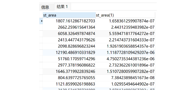

select st_area(geom::geography),st_area(geom) from dltb4326;
这里讲一个有趣的例子,在上述语句运行完成后,可以看到以下结果:
空间函数是一样的,不同的是传进去的参数不一样,一个是geography,另一个是geometry,可以看到两者运行的结果不太一样。先讲一下原因,在postGIS中,默认情况下,如果传入geometry进行面积求解,在srid是4326的时候,出来的结果是按度来进行展示的。而geography是按米为单位进行展示的,大家在工作中,按照自己的需要进行合理选型。

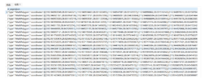

select st_asgeojson(st_buffer(geom,2)) from dltb4326;
