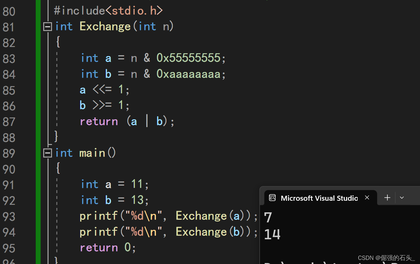

三、函数实现
#include<stdio.h>
int Exchange(int n)
	int a = n & 0x55555555;
	int b = n & 0xaaaaaaaa;
	a <<= 1;
	b >>= 1;
	return (a | b);
int main()
	int a = 11;
	int b = 13;
	printf("%d\n", Exchange(a));
	printf("%d\n", Exchange(b));
	return 0;

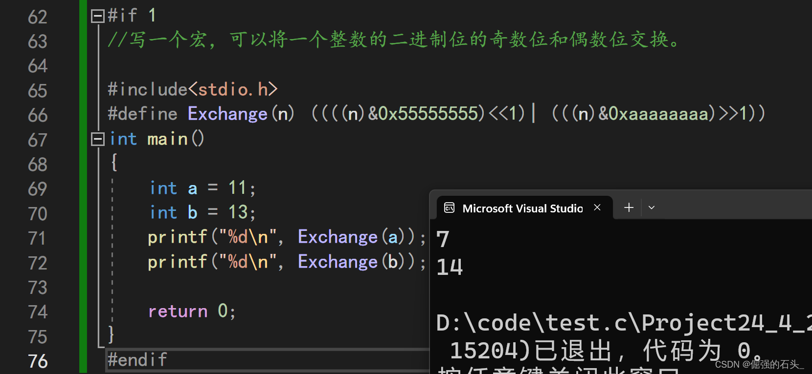

四、宏实现
#include<stdio.h>
#define Exchange(n) ((((n)&0x55555555)<<1)| (((n)&0xaaaaaaaa)>>1))
int main()
	int a = 11;
	int b = 13;
	return 0;
五、总结
