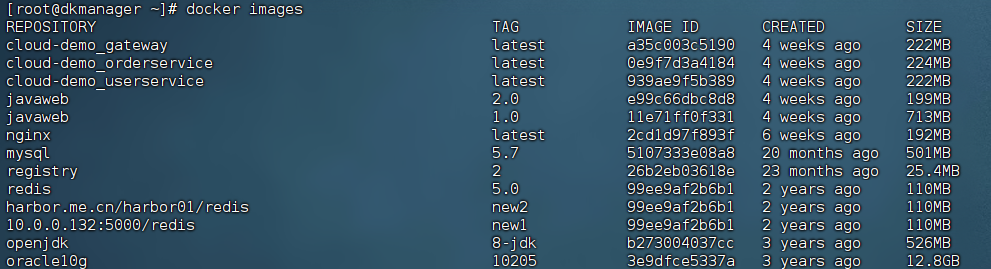

四、重新tag镜像
[root@gejie-10 ~]# docker tag registry.cn-shanghai.aliyuncs.com/techerwang/oracle:ora10g_10205 oracle10g:10205
五、启动Oracle容器
[root@gejie-10 ~]# docker run -itd --name oracle10205 -h jemora10g -p 31521:1521 --privileged=true --restart=always oracle10g:10205 init

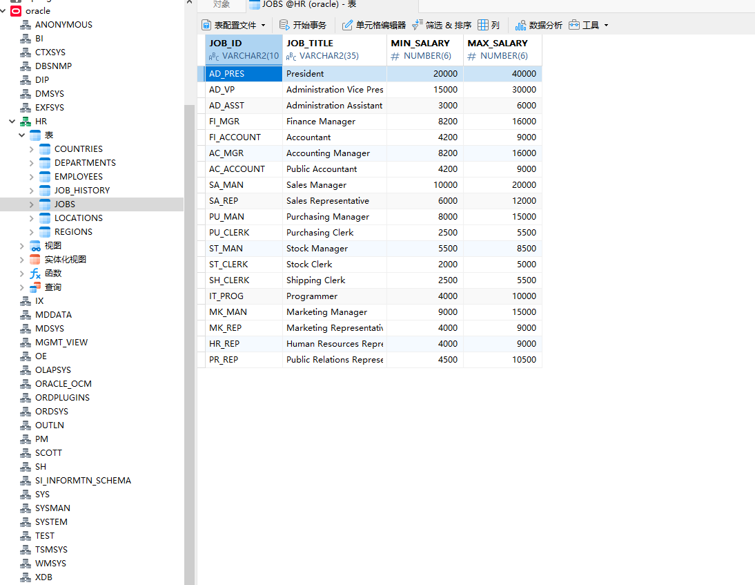

八、创建用户并授权
代码如下(示例):
SYS@jem10g> create user test identified by “12345H”;
SYS@jem10g> grant connect,resource,dba to test;
SYS@jem10g> create user test identified by "12345H";
User created.
Grant succeeded.

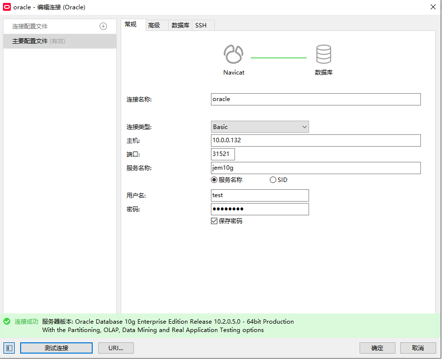

九、连接到ORACLE
连接参数:
IP:112.33.213.30
端口:31512
服务名:jem10g
用户名:test
密码:12345H
