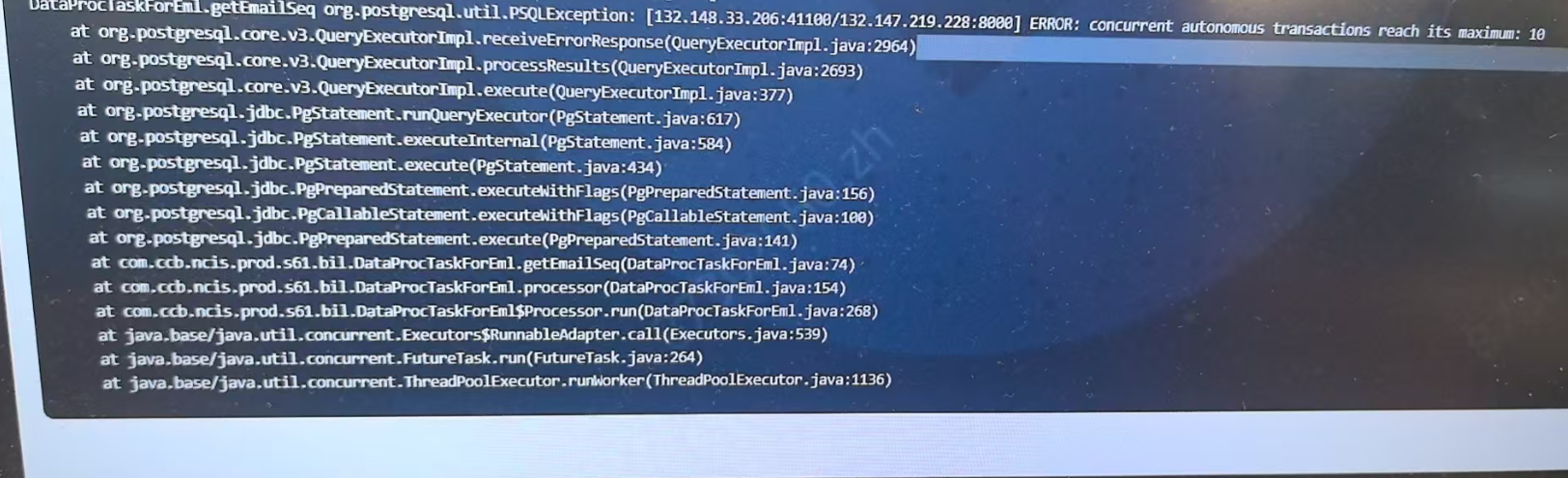

在业务触发情况下,自治事务数会达到瓶劲,GaussDB默认为10个。
如:

将max_concurrent_autonomous_transaction值按照应用开启的并发数设置,比较开启16个并发,那么这个参数要比这个值大,建议值20~30左右。
默认值:
gaussdb=>
gaussdb=>
gaussdb=> show max_concurrent_autonomous_transactions;
 10
(1 row)
gaussdb=>
如将max_concurrent_autonomous_transactions值改为20
gs_guc set -Z datanode -I all -N all -c "max_concurrent_autonomous_transactions='20'";
The gs_guc run with the following arguments: [gs_guc -Z datanode -I all -N all -c max_concurrent_autonomous_transactions=10 set ].
Begin to perform the total nodes: 3.
Popen count is 3, Popen success count is 3, Popen failure count is 0.
Begin to perform gs_guc for datanodes.
Command count is 3, Command success count is 3, Command failure count is 0.
Total instances: 3. Failed instances: 0.
ALL: Success to perform gs_guc!
[Ruby@dtest1 ~]$ cm_ctl stop && cm_ctl start
 20
(1 row)
注: max_concurrent_autonomous_transactions参数的修改需要重启服务。
