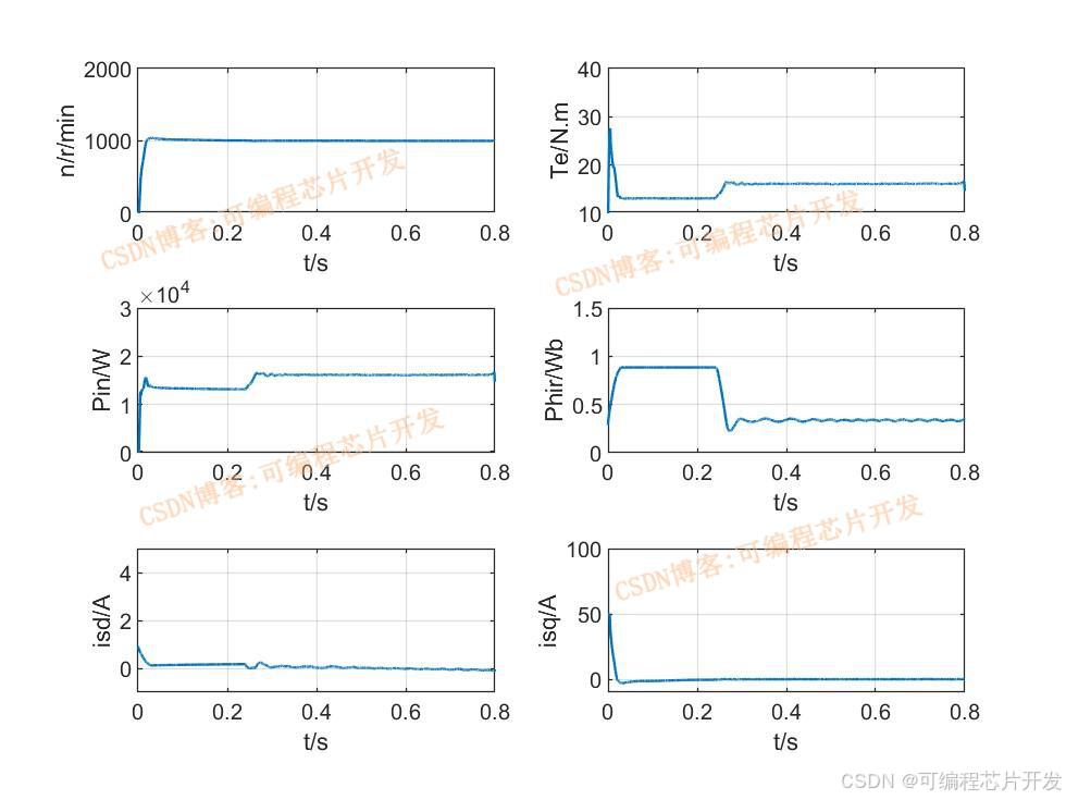

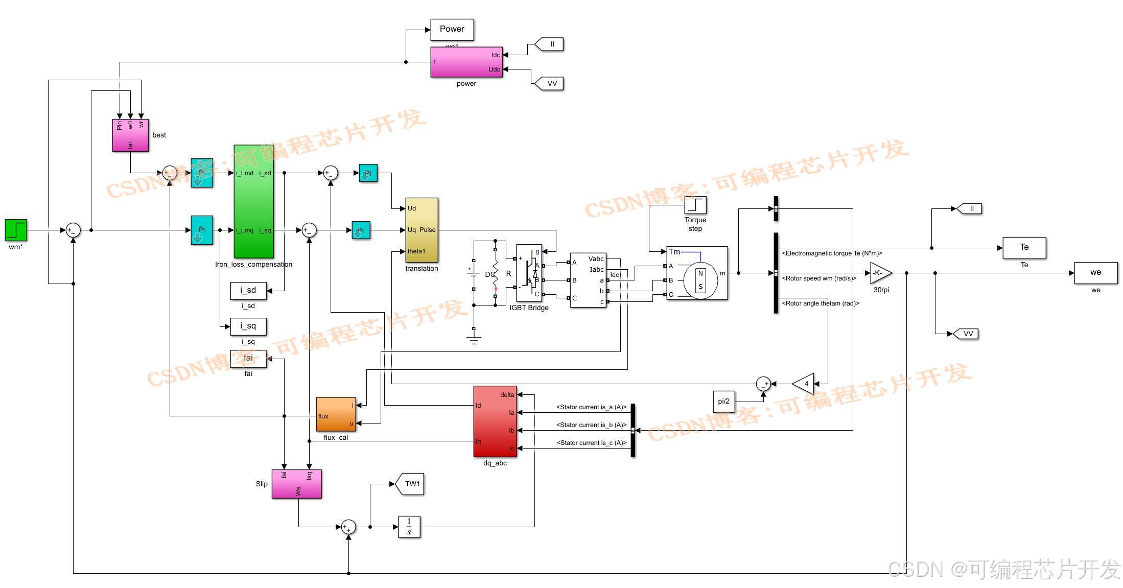

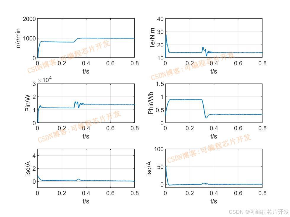

        基于最优转子磁链混合效率优化控制和铁损补偿的PMSM控制系统simulink建模与仿真,模型包括PI控制器,铁损补偿模块,abc2dq模块,逆变器,电机,最优转子磁链混合效率优化等模块。
2.系统仿真结果
3.核心程序与模型
版本:MATLAB2022a
%这里,在算法启动后,数据的采样值增加不少,所以看波形的图形的时候要调整下间隔才行
Ts      = 0.8;
Value_w   = we.signals.values;
time1     = Ts/length(Value_w):Ts/length(Value_w):Ts;
L1        = floor(length(time1));
Value_T   = Te.signals.values;
time2     = Ts/length(Value_T):Ts/length(Value_T):Ts;
L2        = floor(length(time2));
Value_isd = i_sd.signals.values;
time3     = Ts/length(Value_isd):Ts/length(Value_isd):Ts;
L3        = floor(length(time3));
Value_isq = i_sq.signals.values;
time4     = Ts/length(Value_isq):Ts/length(Value_isq):Ts;
L4        = floor(length(time4));
Value_fai = fai.signals.values;
time5     = Ts/length(Value_fai):Ts/length(Value_fai):Ts;
L5        = floor(length(time5));
Value_P   = Power.signals.values;
time6     = Ts/length(Value_fai):Ts/length(Value_fai):Ts;
L6        = floor(length(time6));
Ker = 2^9;
step= 100;
figure;
subplot(321);
plot(time1(1:step:L1),smooth(Value_w(1:step:L1),Ker),'linewidth',1);
grid on
xlabel('t/s');
ylabel('n/r/min');
axis([0,Ts,0,2000]);
subplot(322);
plot(time2(1:step:L2),smooth(Value_T(1:step:L2),Ker),'linewidth',1);
grid on
xlabel('t/s');
ylabel('Te/N.m');
axis([0,Ts,10,40]);
subplot(323);
plot(time6(1:step:L6),smooth(Value_P(1:step:L6),Ker),'linewidth',1);
grid on
xlabel('t/s');
ylabel('Pin/W');
axis([0,Ts,-1,30000]);
subplot(324);
plot(time5(1:step:L5),smooth(Value_fai(1:step:L5),Ker),'linewidth',1);
grid on
xlabel('t/s');
ylabel('Phir/Wb');
axis([0,Ts,0,1.5]);
subplot(325);
plot(time3(1:step:L3),smooth(Value_isd(1:step:L3),Ker),'linewidth',1);
grid on
xlabel('t/s');
ylabel('isd/A');
axis([0,Ts,-1,5]);
subplot(326);
plot(time4(1:step:L4),smooth(Value_isq(1:step:L4),Ker),'linewidth',1);
grid on
xlabel('t/s');
ylabel('isq/A');
axis([0,Ts,-10,100]);

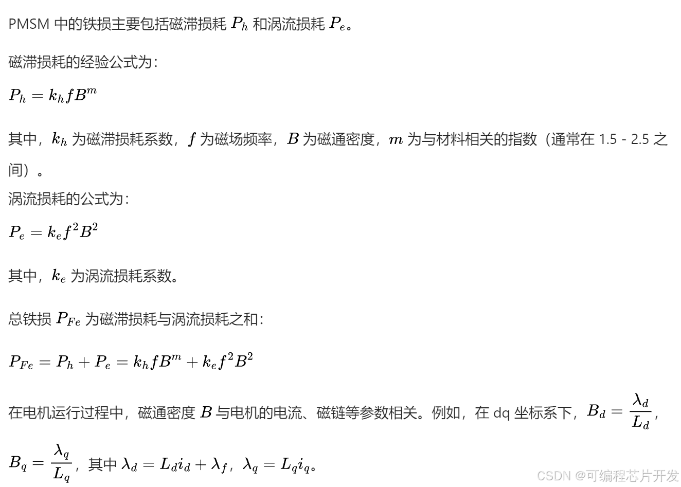

4.1 铁损模型

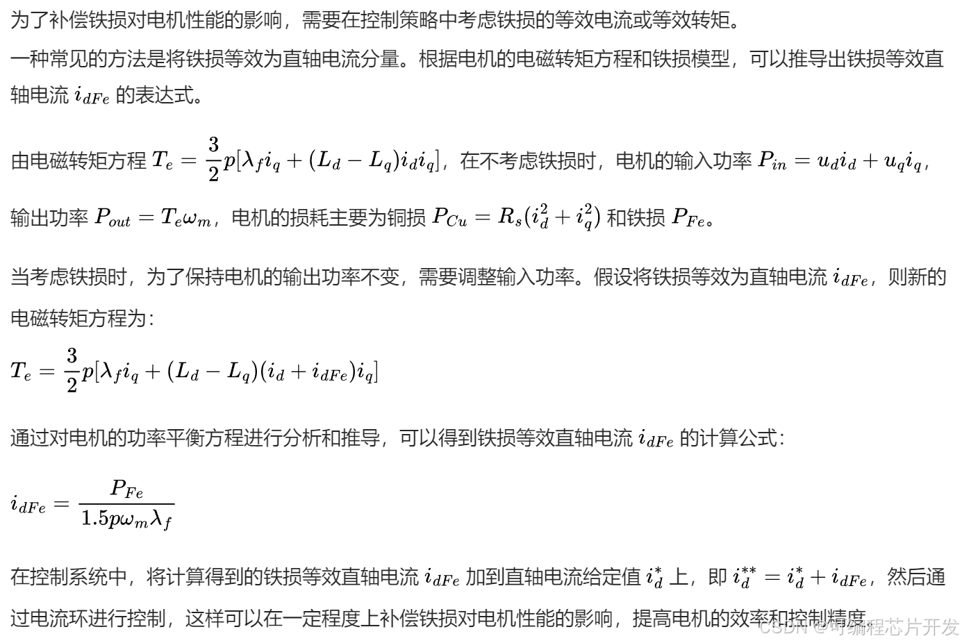

4.2 铁损补偿方法

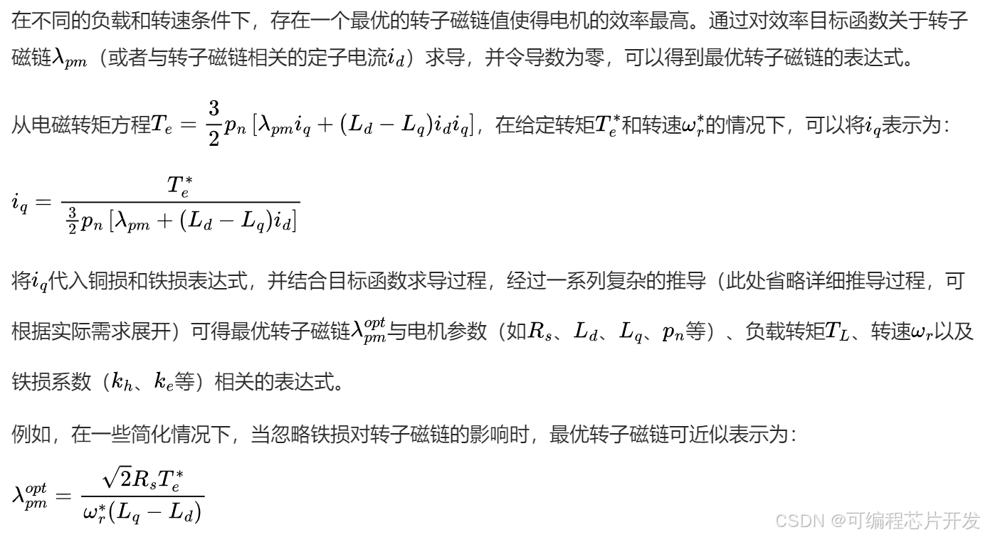

4.4 最优转子磁链混合效率优化控制
