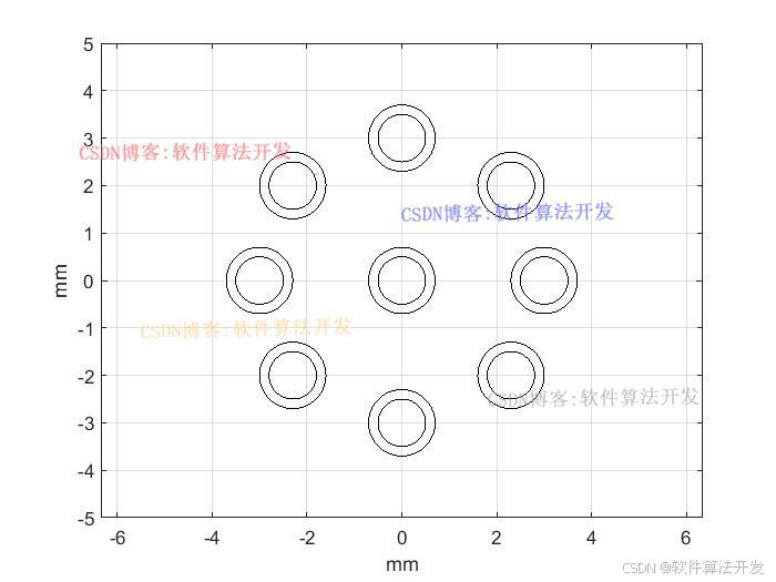

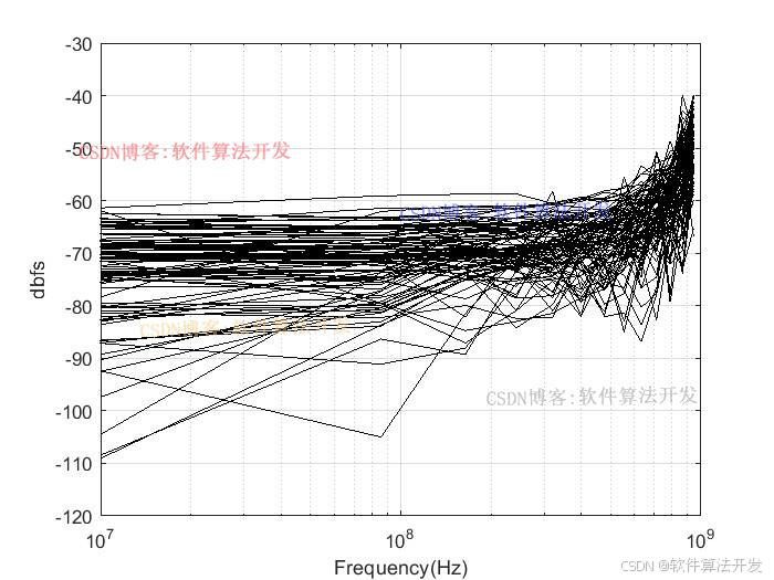

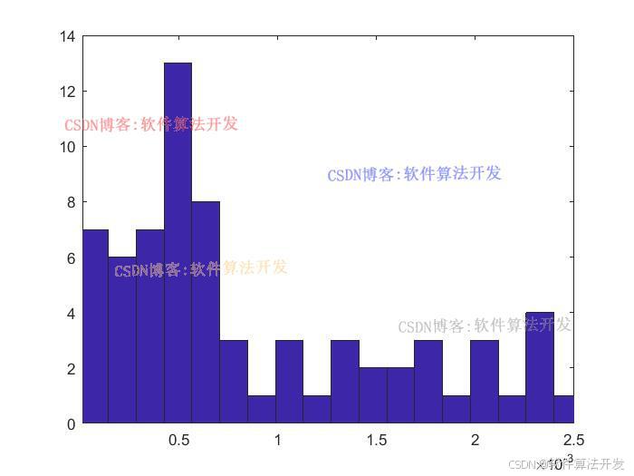

基于RMD算法模型的信号传输统计特性的matlab模拟仿真。参考的文献如下:
即通过RMD随机中点位置模型算法,实现上述文献的几个仿真图。

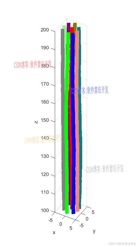

%9条线的参数配置
X0    = zeros(n,1);
Y0    = zeros(n,1);
Z0    = zeros(n,1);
Z0(1) = 90;
Z0(n) = 240;
X0(1) = -3;
X0(n) = -3.1;
Y0(1) = 0;
Y0(n) = 0.1;
%定义sin,频率为1e9内的一个范围见进行设置
rng(9);
V1    = FX*sin(2*pi*1e9*rand*[1:n]/n/Fs)/10;
V2    = FX*cos(2*pi*1e9*rand*[1:n]/n/Fs)/10;
[X9,Y9,Z9]=func_buble_rmd(X0,Y0,Z0,m,n,d1+V1,d2+V2);%这个V1和V2就是模拟论文中介绍的各个wire之间的耦合性
%将九个模型进行画图
figure;
plot3(X1,Y1,Z1,'color',[1,0,0],'linewidth',10*Radius);
hold on
plot3(X2,Y2,Z2,'color',[0.5,0.5,0],'linewidth',10*Radius);
hold on
plot3(X3,Y3,Z3,'color',[0,1,0],'linewidth',10*Radius);
hold on
plot3(X4,Y4,Z4,'color',[0,0.5,0.5],'linewidth',10*Radius);
hold on
plot3(X5,Y5,Z5,'color',[0,0,1],'linewidth',10*Radius);
hold on
plot3(X6,Y6,Z6,'color',[0.5,0,0.5],'linewidth',10*Radius);
hold on
plot3(X7,Y7,Z7,'color',[0.5,0.5,0.5],'linewidth',10*Radius);
hold on
plot3(X8,Y8,Z8,'color',[1,0.5,0.5],'linewidth',10*Radius);
hold on
plot3(X9,Y9,Z9,'color',[0.5,1,0.5],'linewidth',10*Radius);
hold on
grid on
xlabel('x');
ylabel('y');
zlabel('z');
axis equal
axis([-5,5,-5,5,100,200]);
view([30,40]);
