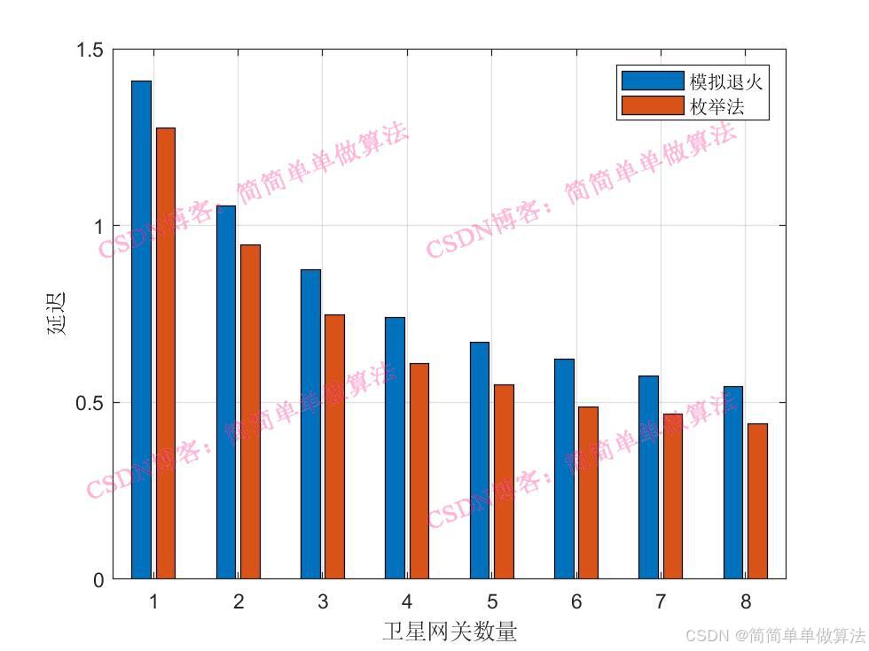

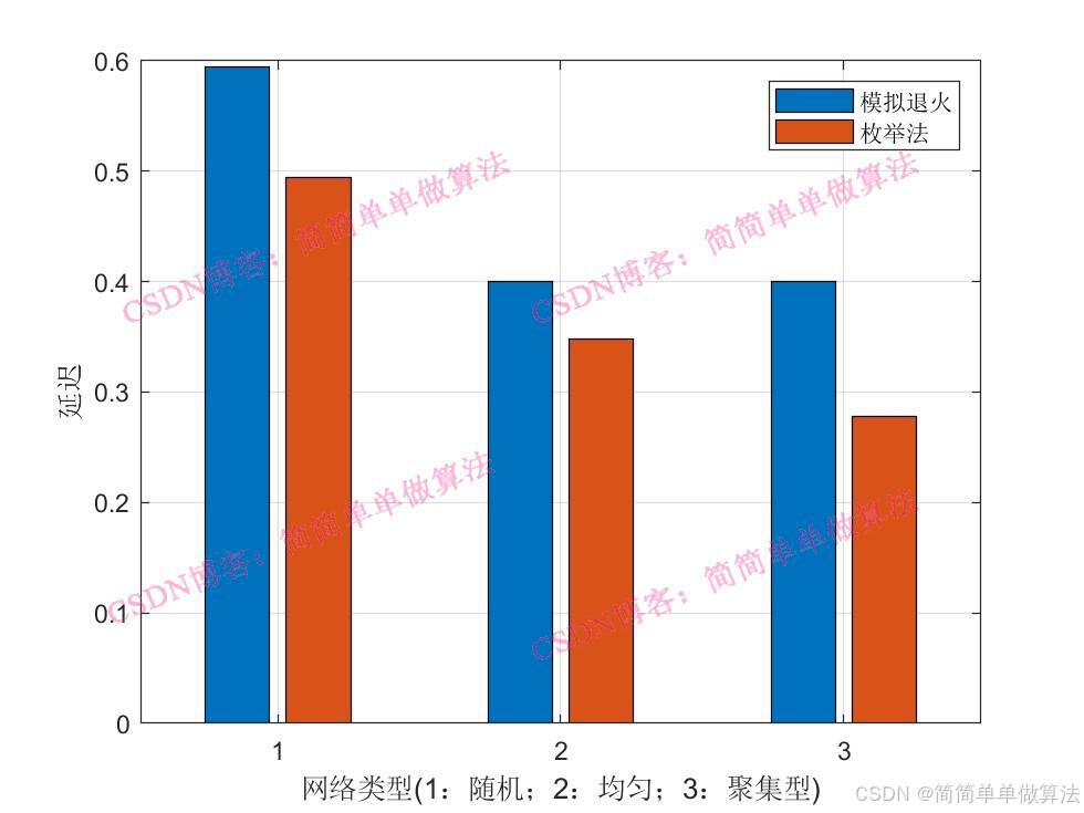

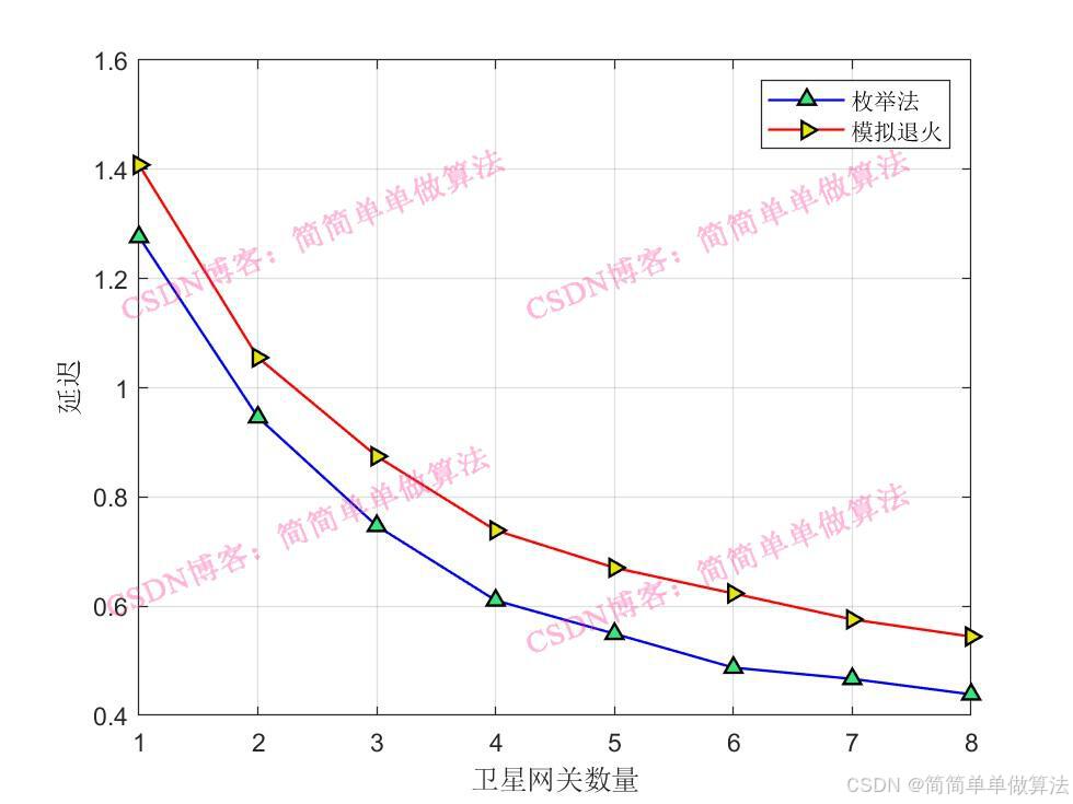

1.算法运行效果图预览
(完整程序运行后无水印)

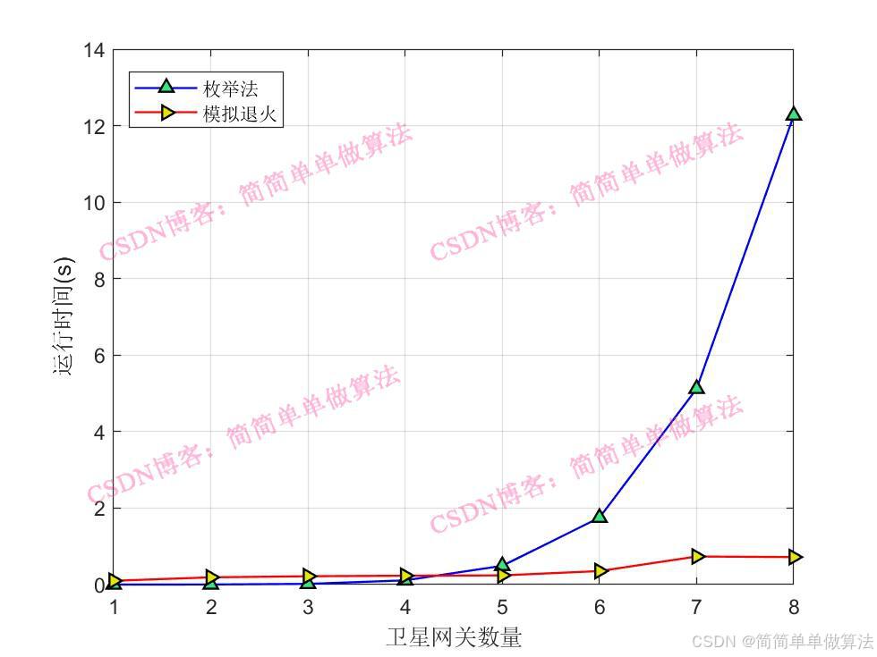

figure;
plot(kk,runtime,'-bs',...
    'LineWidth',1,...
    'MarkerSize',6,...
    'MarkerEdgeColor','k',...
    'MarkerFaceColor',[0.9,0.0,0.0]);
% 设置 x 轴的标签为卫星网关数量
xlabel('卫星网关数量');
% 设置 y 轴的标签为运行时间(s)
ylabel('运行时间(s)');
grid on
save R1.mat kk runtime
