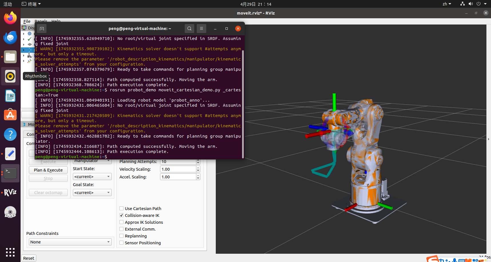

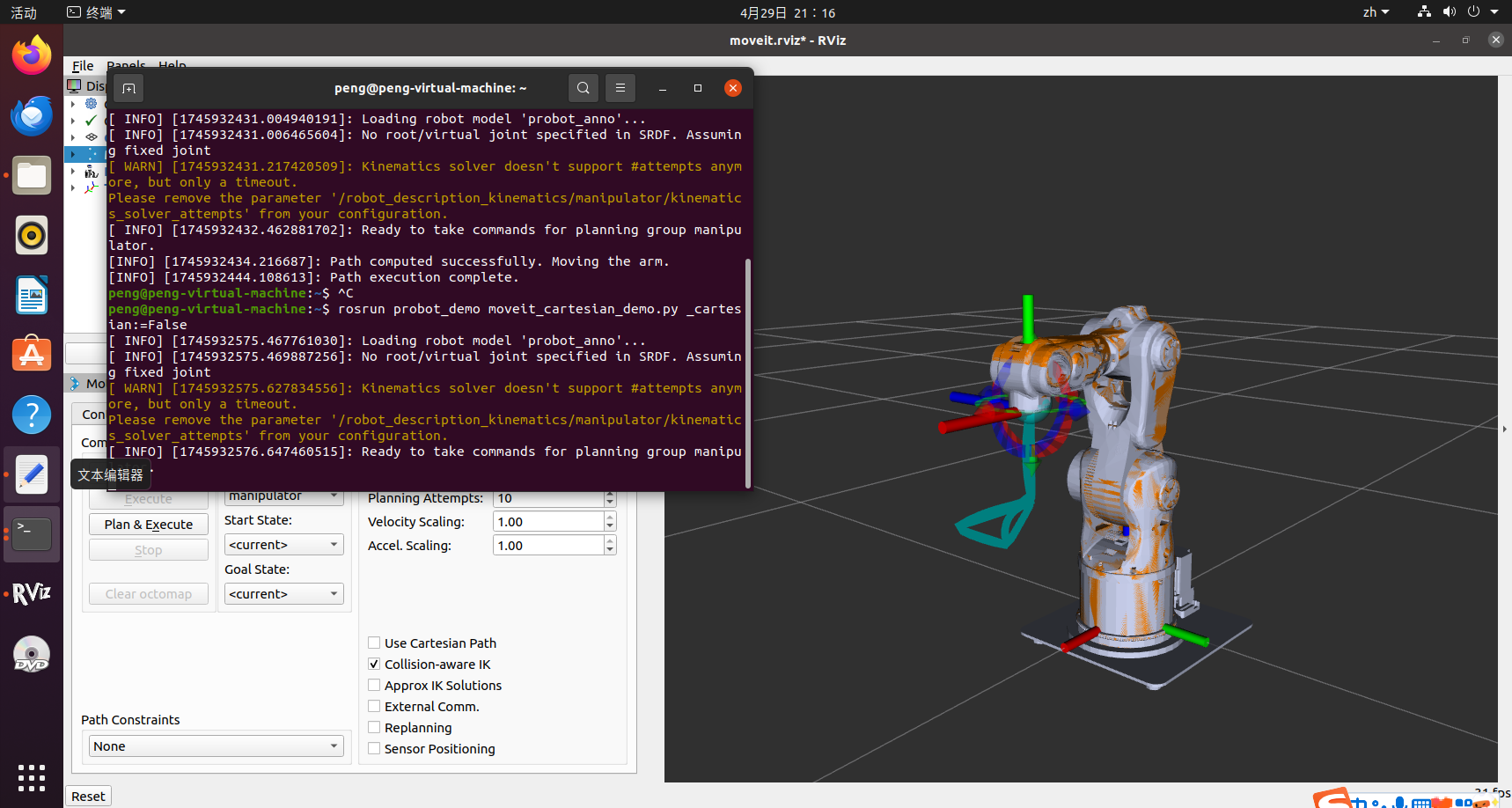

代码演示
roslaunch probot_anno_moveit_config demo.launch
rosrun probot_demo moveit_cartesian_demo.py _cartesian:=True
rosrun probot_demo moveit_cartesian_demo.py _cartesian:=False
