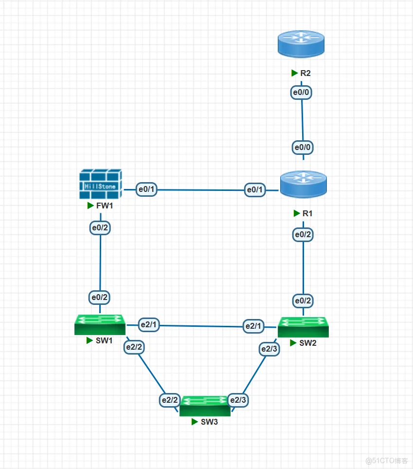

【摘要】 该网络拓扑包含6台设备(SW1-3、RT1-2、FW1),通过OSPFv2协议在Area 0中实现全网互通,核心配置包括基础IP设置、OSPF统一使用Process 1并发布Loopback及直连网段路由,路由验证显示全网可达,特殊设计包括FW1配置trust安全域与RT1/SW1建邻、RT2作为边缘节点单邻居连接,整体采用/30点对点链路和环回地址确保高效路由收敛。
网络拓扑图及 IP 地址表:
1.网络拓扑图
2.网络设备 IP 地址分配表
设备名称    设备接口    IP 地址 所属接口
SW1 Loopback1 10.4.1.1/32
SW1 Loopback2 10.4.11.1/24
SW1 Vlan1019  10.4.255.14/30 e0/2
SW1 Vlan1020  10.4.255.5/30 e2/2
SW1 Vlan1023  10.4.255.1/30 e2/1
SW2 Loopback1 10.4.2.1/32
SW2 Loopback2 10.4.21.1/24
SW2 Vlan1019  10.4.255.22/30 e0/2
SW2 Vlan1020  10.4.255.9/30 e2/3
SW2 Vlan1023  10.4.255.2/30 e2/1
SW3 Loopback1 10.4.3.1/32
SW3 Loopback2 10.4.31.1/24
SW3 Vlan1019  10.4.255.6/30 e2/2
SW3 Vlan1020  10.4.255.10/30 e2/3
RT1 Loopback1 10.4.5.1/32
RT1 e0/0      10.4.255.33/30 e0/0
RT1 e0/1      10.4.255.18/30 e0/1
RT1 e0/2      10.4.255.21/30 e0/2
RT2 Loopback1 10.4.6.1/32
RT2 e0/0      10.4.255.34/30 e0/0
FW1 Loopback1 10.4.7.1/32
FW1 e0/1trust 10.4.255.17/30 e0/1
FW1 e0/2trust 10.4.255.13/30 e0/2

O        10.4.5.1/32 [110/2] via 10.4.255.21, 00:13:42, Vlan1019
O        10.4.6.1/32 [110/12] via 10.4.255.21, 00:08:30, Vlan1019
O        10.4.11.1/32 [110/2] via 10.4.255.1, 00:18:53, Vlan1023
O        10.4.31.1/32 [110/2] via 10.4.255.10, 00:17:22, Vlan1020
O        10.4.255.4/30 [110/2] via 10.4.255.10, 00:17:22, Vlan1020
O        10.4.255.12/30 [110/2] via 10.4.255.1, 00:18:53, Vlan1023
O        10.4.255.16/30 [110/3] via 10.4.255.1, 00:06:38, Vlan1023
O        10.4.255.32/30 [110/11] via 10.4.255.21, 00:08:30, Vlan1019
SW3
SW3>enable
SW3#show ip ospf neighbor
Neighbor ID     Pri   State           Dead Time   Address         Interface
10.4.2.1          1   FULL/DR         00:00:38    10.4.255.9      Vlan1020
10.4.1.1          1   FULL/DR         00:00:32    10.4.255.5      Vlan1019
SW3#show ip route ospf
Codes: L - local, C - connected, S - static, R - RIP, M - mobile, B - BGP
       D - EIGRP, EX - EIGRP external, O - OSPF, IA - OSPF inter area
       N1 - OSPF NSSA external type 1, N2 - OSPF NSSA external type 2
       E1 - OSPF external type 1, E2 - OSPF external type 2
       i - IS-IS, su - IS-IS summary, L1 - IS-IS level-1, L2 - IS-IS level-2
       ia - IS-IS inter area, * - candidate default, U - per-user static route
       o - ODR, P - periodic downloaded static route, H - NHRP, l - LISP
       a - application route
       + - replicated route, % - next hop override, p - overrides from PfR
Gateway of last resort is not set
      10.0.0.0/8 is variably subnetted, 18 subnets, 3 masks
O        10.4.1.1/32 [110/2] via 10.4.255.5, 00:18:50, Vlan1019
O        10.4.2.1/32 [110/2] via 10.4.255.9, 00:18:39, Vlan1020
O        10.4.5.1/32 [110/3] via 10.4.255.9, 00:14:48, Vlan1020
O        10.4.6.1/32 [110/13] via 10.4.255.9, 00:09:46, Vlan1020
O        10.4.11.1/32 [110/2] via 10.4.255.5, 00:18:50, Vlan1019
O        10.4.21.1/32 [110/2] via 10.4.255.9, 00:18:39, Vlan1020
O        10.4.255.0/30 [110/2] via 10.4.255.9, 00:18:39, Vlan1020
O        10.4.255.12/30 [110/2] via 10.4.255.5, 00:18:50, Vlan1019
O        10.4.255.16/30 [110/3] via 10.4.255.5, 00:07:54, Vlan1019
O        10.4.255.20/30 [110/2] via 10.4.255.9, 00:18:39, Vlan1020
O        10.4.255.32/30 [110/12] via 10.4.255.9, 00:09:46, Vlan1020
RT1
RT1>ebable
RT1#show ip ospf neighbor
10.4.6.1          1   FULL/DR         00:00:34    10.4.255.34     Ethernet0/0
10.4.2.1          1   FULL/DR         00:00:39    10.4.255.22     Ethernet0/2
10.4.7.1          1   FULL/BDR        00:00:34    10.4.255.17     Ethernet0/1
RT1#show ip route ospf
      10.0.0.0/8 is variably subnetted, 18 subnets, 2 masks
O        10.4.1.1/32 [110/12] via 10.4.255.22, 00:15:44, Ethernet0/2
                     [110/12] via 10.4.255.17, 00:08:38, Ethernet0/1
O        10.4.2.1/32 [110/11] via 10.4.255.22, 00:15:44, Ethernet0/2
O        10.4.3.1/32 [110/12] via 10.4.255.22, 00:15:44, Ethernet0/2
O        10.4.6.1/32 [110/11] via 10.4.255.34, 00:10:30, Ethernet0/0
O        10.4.11.1/32 [110/12] via 10.4.255.22, 00:15:44, Ethernet0/2
O        10.4.21.1/32 [110/11] via 10.4.255.22, 00:15:44, Ethernet0/2
O        10.4.31.1/32 [110/12] via 10.4.255.22, 00:15:44, Ethernet0/2
O        10.4.255.0/30 [110/11] via 10.4.255.22, 00:15:44, Ethernet0/2
O        10.4.255.4/30 [110/12] via 10.4.255.22, 00:15:44, Ethernet0/2
O        10.4.255.8/30 [110/11] via 10.4.255.22, 00:15:44, Ethernet0/2
O        10.4.255.12/30 [110/11] via 10.4.255.17, 00:08:38, Ethernet0/1
RT2
RT2>ebable
RT2#show ip ospf neighbor
10.4.5.1          1   FULL/BDR        00:00:32    10.4.255.33     Ethernet0/0
RT2#show ip route ospf
      10.0.0.0/8 is variably subnetted, 16 subnets, 2 masks
O        10.4.1.1/32 [110/22] via 10.4.255.33, 00:11:43, Ethernet0/0
O        10.4.2.1/32 [110/21] via 10.4.255.33, 00:11:43, Ethernet0/0
O        10.4.3.1/32 [110/22] via 10.4.255.33, 00:11:43, Ethernet0/0
O        10.4.5.1/32 [110/11] via 10.4.255.33, 00:11:43, Ethernet0/0
O        10.4.11.1/32 [110/22] via 10.4.255.33, 00:11:43, Ethernet0/0
O        10.4.21.1/32 [110/21] via 10.4.255.33, 00:11:43, Ethernet0/0
O        10.4.31.1/32 [110/22] via 10.4.255.33, 00:11:43, Ethernet0/0
O        10.4.255.0/30 [110/21] via 10.4.255.33, 00:11:43, Ethernet0/0
O        10.4.255.4/30 [110/22] via 10.4.255.33, 00:11:43, Ethernet0/0
O        10.4.255.8/30 [110/21] via 10.4.255.33, 00:11:43, Ethernet0/0
O        10.4.255.12/30 [110/21] via 10.4.255.33, 00:09:48, Ethernet0/0
O        10.4.255.16/30 [110/20] via 10.4.255.33, 00:11:43, Ethernet0/0
O        10.4.255.20/30 [110/20] via 10.4.255.33, 00:11:43, Ethernet0/0
FW1
login: hillstone
password:
FW1# show ip ospf neighbor
OSPF Router with ID 10.4.7.1, OSPF Process ID 1
10.4.5.1          1 Full/DR         00:00:38  10.4.255.18     ethernet0/1
10.4.1.1          1 Full/DR         00:00:34  10.4.255.14     ethernet0/2
FW1# show ip ospf route
Codes: N - network route, D - discard route, R - router route, IA - inter router
       E1 - external type-1 route, E2 - external type-2 route
================= OSPF network routing table =================
N    10.4.1.1/32           [2] area: 0.0.0.0
                           directly attached to ethernet0/2
                           via 10.4.255.14, ethernet0/2
N    10.4.2.1/32           [3] area: 0.0.0.0
N    10.4.3.1/32           [3] area: 0.0.0.0
N    10.4.5.1/32           [2] area: 0.0.0.0
                           directly attached to ethernet0/1
                           via 10.4.255.18, ethernet0/1
N    10.4.6.1/32           [12] area: 0.0.0.0
N    10.4.11.1/32          [2] area: 0.0.0.0
N    10.4.21.1/32          [3] area: 0.0.0.0
N    10.4.31.1/32          [3] area: 0.0.0.0
N    10.4.255.0/30         [2] area: 0.0.0.0
N    10.4.255.4/30         [2] area: 0.0.0.0
N    10.4.255.8/30         [3] area: 0.0.0.0
N    10.4.255.12/30        [1] area: 0.0.0.0
N    10.4.255.16/30        [1] area: 0.0.0.0
N    10.4.255.20/30        [3] area: 0.0.0.0
N    10.4.255.32/30        [11] area: 0.0.0.0
