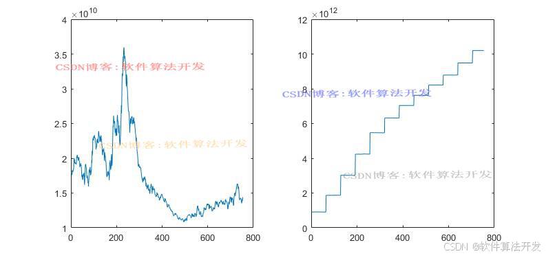

%计算违约点
DP = SD+k*LD;
figure;
subplot(121);
plot(SD(1:end-NN/2));
subplot(122);
plot(DP(1:end-NN/2));

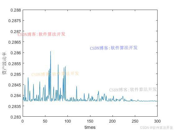

%资产价值波动率-图2
R    = func_Rsy(dat1);
zeta = func_GARCH(R);
figure;
plot(zeta);
xlabel('times');
ylabel('资产波动率');
axis([0,300,0.283,0.288]);
%信用溢价和表2数据分析

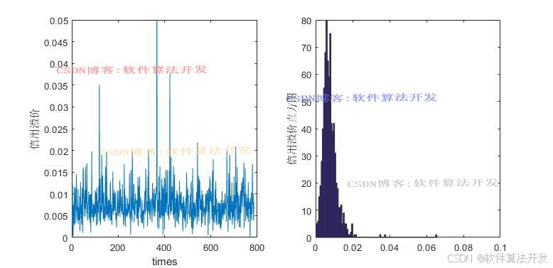

[Rc,d] = func_xyyj(dat1,zeta,DP);
figure;
subplot(121);
plot(Rc);
xlabel('times');
ylabel('信用溢价');
axis([0,800,0.0,0.05]);
subplot(122);
hist(Rc,100);
axis([0,0.1,0.0,80]);
ylabel('信用溢价直方图');
d(1:7)'

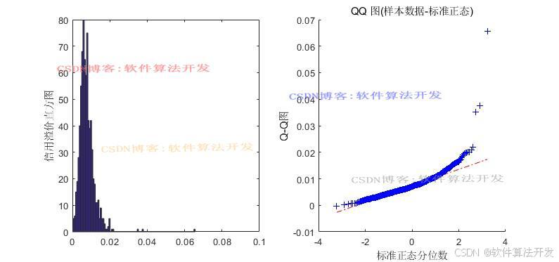

%QQ图
figure;
subplot(121);
hist(Rc,100);
ylabel('信用溢价直方图');
subplot(122);
qqplot(Rc);
ylabel('Q-Q图');
