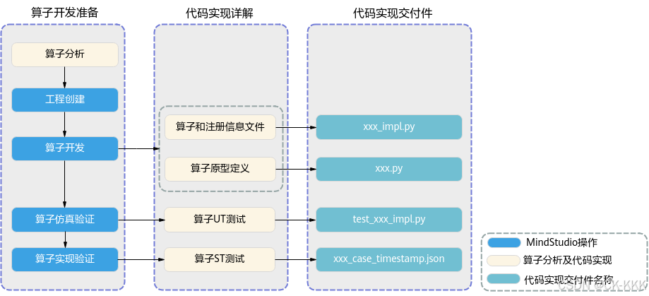

制作Mindspore的TBE流程中用于测试的是test_xxx_impl.py。

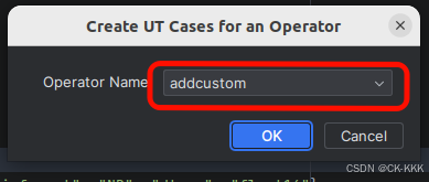

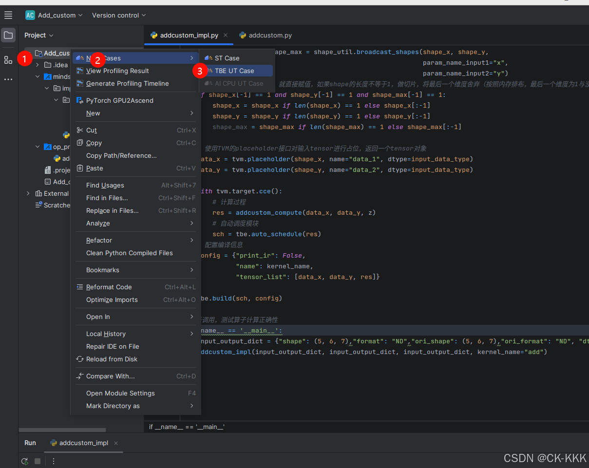

  1. 右键算子工程文件,点击New Case,创建 TBE UT CASE
  2. 选择测试的算子为新创建的addCustom算子,点击OK

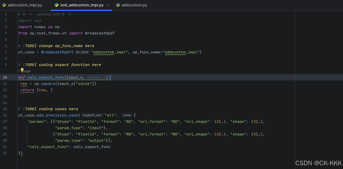

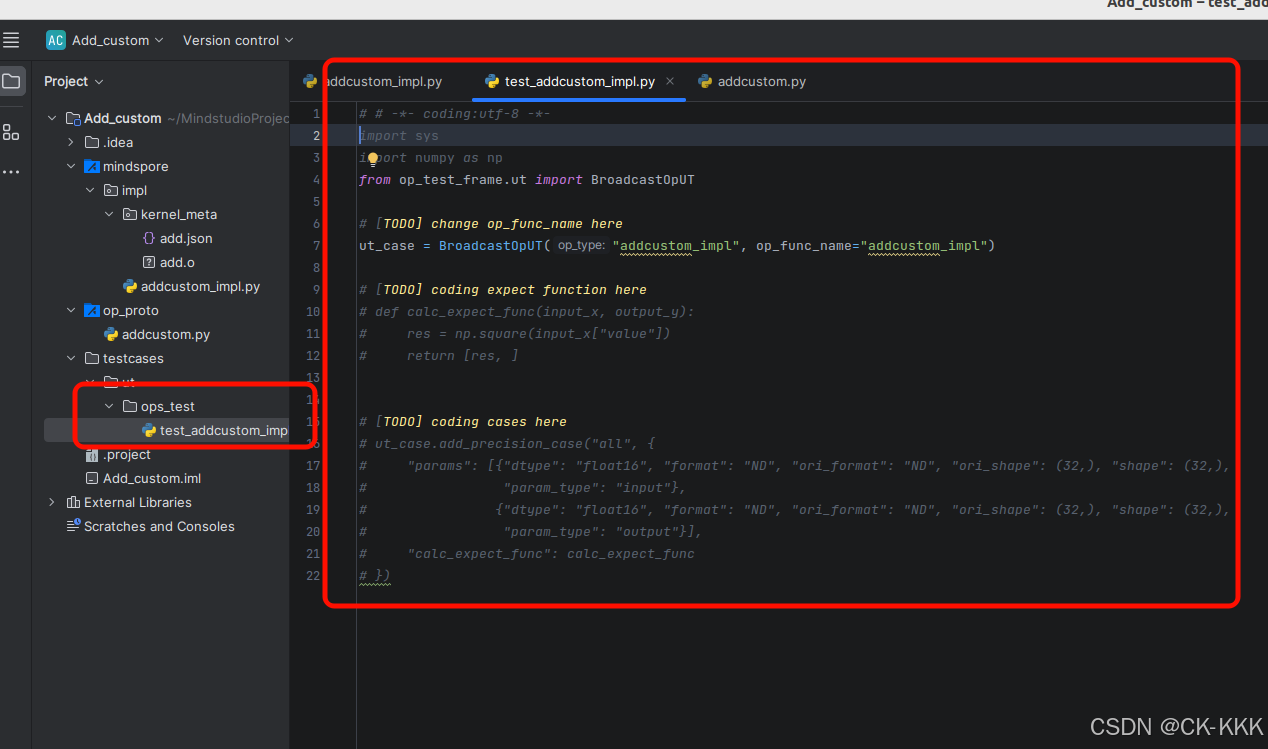

  3. 生成了对应的test_xxx_impl.py文件
  4. 编辑对应的py文件,清理掉对应注释,

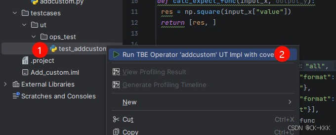

  5. 右击对应的python文件,执行TBE算子测试

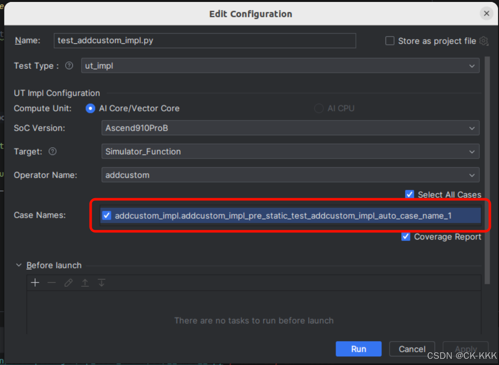

解决这个问题之后,便可以选择测试例子
7. 执行测试用例
这里需要注意的是,需要选择的SOC核心为Ascend910芯片,这里我选择Ascend910Pro。

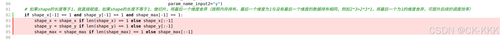

9. bug调整
报错信息:
Soc Version: Ascend910ProB
    failed: [addcustom_impl]  addcustom_impl_pre_static_test_addcustom_impl_auto_case_name_1 (Ascend910ProB), error msg: Failed,
      Case File "/home/science/MindstudioProjects/Add_custom/testcases/ut/ops_test/test_addcustom_impl.py", line 16
      Error trace:
      Call op func failed, err_trace: Traceback (most recent call last):
        File "/home/science/Ascend/ascend-toolkit/8.0.0/toolkit/python/site-packages/op_test_frame/ut/op_ut.py", line 873, in _call_op_func
          op_func(*case_info.op_params, **addition_params)
        File "/home/science/anaconda3/envs/mindspore/lib/python3.9/site-packages/mindspore/ops/op_info_register.py", line 298, in wrapped_function
          return func(*args, **kwargs)
      TypeError: addcustom_impl() missing 1 required positional argument: 'z'
这里需要对之前的impl代码进行修改

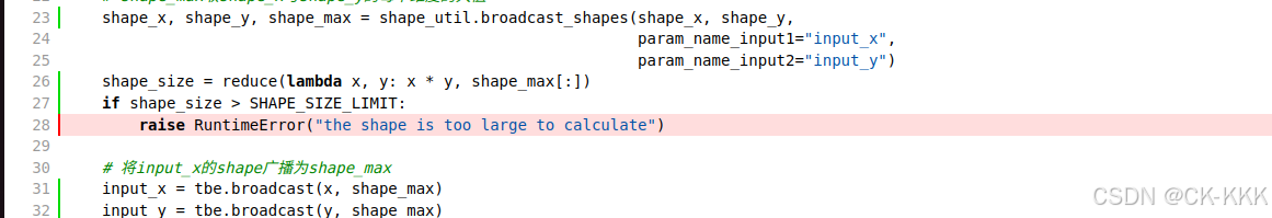

def addcustom_compute(x, y):
    The compute function of the Addcustom implementation.
    # shape转为list
    shape_x = shape_util.shape_to_list(x.shape)
    shape_y = shape_util.shape_to_list(y.shape)
    # shape_max取shape_x与shape_y的每个维度的大值
    shape_x, shape_y, shape_max = shape_util.broadcast_shapes(shape_x, shape_y,
                                                              param_name_input1="input_x",
                                                              param_name_input2="input_y")
    shape_size = reduce(lambda x, y: x * y, shape_max[:])
    if shape_size > SHAPE_SIZE_LIMIT:
        raise RuntimeError("the shape is too large to calculate")
    # 将input_x的shape广播为shape_max
    input_x = tbe.broadcast(x, shape_max)
    input_y = tbe.broadcast(y, shape_max)
    # 执行input_x + input_y
    res = tbe.vadd(input_x, input_y)
    return res

    # 如果shape的长度等于1,就直接赋值,如果shape的长度不等于1,做切片,将最后一个维度舍弃(按照内存排布,最后一个维度为1与没有最后一个维度的数据排布相同,例如2*3=2*3*1,将最后一个为1的维度舍弃,可提升后续的调度效率)
    if shape_x[-1] == 1 and shape_y[-1] == 1 and shape_max[-1] == 1:
        shape_x = shape_x if len(shape_x) == 1 else shape_x[:-1]
        shape_y = shape_y if len(shape_y) == 1 else shape_y[:-1]
        shape_max = shape_max if len(shape_max) == 1 else shape_max[:-1]
# # -*- coding:utf-8 -*-
import sys
import numpy as np
from op_test_frame.ut import BroadcastOpUT
# [TODO] change op_func_name here
ut_case = BroadcastOpUT("addcustom_impl", op_func_name="addcustom_impl")
# [TODO] coding expect function here
def calc_expect_func(input_x, input_y, output):
    res = input_x["value"] + input_y["value"]  # 计算加法
    return [res, ]
# [TODO] coding cases here
ut_case.add_precision_case("all", {
    "params": [
        {"dtype": "float16", "format": "ND", "ori_format": "ND", "ori_shape": (32,), "shape": (32,), "param_type": "input"},  # input_x
        {"dtype": "float16", "format": "ND", "ori_format": "ND", "ori_shape": (32,), "shape": (32,), "param_type": "input"},  # input_y
        {"dtype": "float16", "format": "ND", "ori_format": "ND", "ori_shape": (32,), "shape": (32,), "param_type": "output"}  # 添加输出参数
    "calc_expect_func": calc_expect_func

>>>> start run test case
[Ascend910ProB] addcustom_impl test start running...
addcustom_impl_pre_static_test_addcustom_impl_auto_case_name_1 (addcustom_impl) (precision) ... [INFO] 2025-02-10 22:34:01.097596 [File "/home/science/Ascend/ascend-toolkit/8.0.0/toolkit/python/site-packages/op_test_frame/runtime/rts_api.py", line 105] Load RTS shared library...

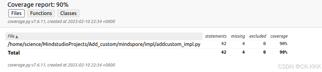

[INFO] 2025-02-10 22:34:02.244534 [File "/home/science/Ascend/ascend-toolkit/8.0.0/toolkit/python/site-packages/op_test_frame/runtime/rts_api.py", line 780] Runtime API call rtDeviceReset() success.
Error count: 0, Max atol error count: 0, Threshold count(rtol * data_size):0.032
ok
run 1 tests, success: 1
>>>> end run test case, op_type:addcustom_impl cost time: 2
[INFO] 2025-02-10 22:34:02.248955 [File "/home/science/Ascend/ascend-toolkit/8.0.0/toolkit/python/site-packages/op_test_frame/ut/op_ut_runner.py", line 255] end run: /home/science/MindstudioProjects/Add_custom/testcases/ut/ops_test/test_addcustom_impl.py
/home/science/MindstudioProjects/Add_custom/out/bin/report/combine_rpt_path [] ['rpt_1_test_addcustom_impl.data']
load /home/science/MindstudioProjects/Add_custom/out/bin/report/combine_rpt_path/rpt_1_test_addcustom_impl.data success, case cnt: 1
- test soc: [Ascend910ProB]
- test case count: 1
- success count: 1
- failed count: 0
- error count: 0
    success: [addcustom_impl]  addcustom_impl_pre_static_test_addcustom_impl_auto_case_name_1 (Ascend910ProB) (precision)
end run ops ut time: 2025-02-10 22:34:02.266352
TBE TestRun Finished
Ut_Impl report index.html: http://localhost:63342/Add_custom/out/coverage_report/ut_impl/index.html?_ijt=laasfbagsbclwufgwngbqcposk
从报告中也可以看到,依然是有代码是UT测试中没有覆盖的内容,这也代表着我们需要进行更多更全面的测试用例编写。
