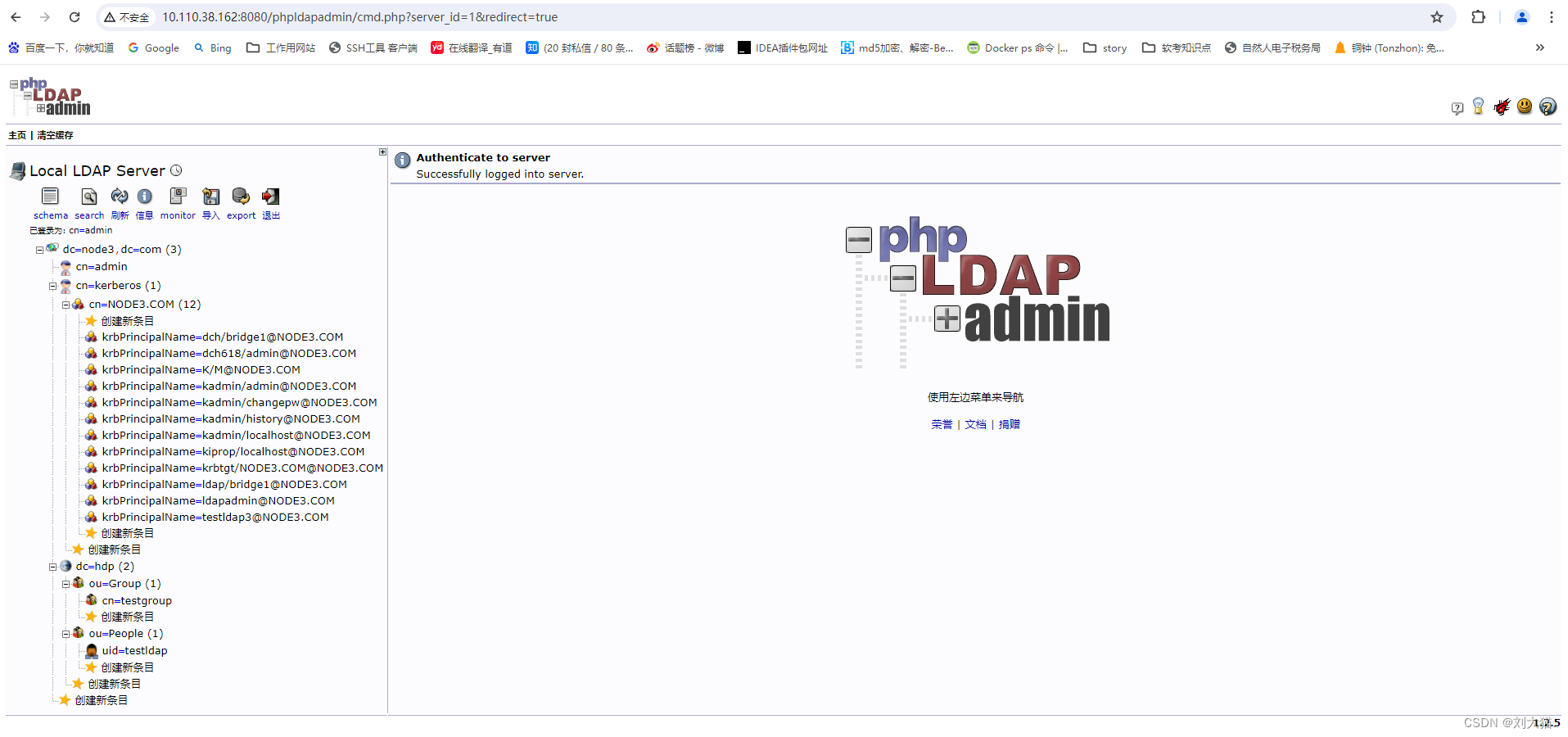

2.4 登录phpldapadmin界面
http://10.110.38.162:8080/phpldapadmin/
其中cn:admin 密码:123456

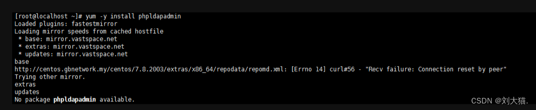

错误场景1:执行步骤“安装phpldapadmin”执行命令:yum install -y phpldapadmin时报错
错误原因:是因为使用yum搜索某些rpm包,找不到包是因为CentOS是RedHat企业版编译过来的,去掉了所有关于版权问题的东西。安装EPEL后可以很好的解决这个问题。EPEL(Extra Packages for Enterprise Linux )即企业版Linux的扩展包,提供了很多可共Centos使用的组件,安装完这个以后基本常用的rpm都可以找到。
解决方案:
执行命令:
yum localinstall http://rpms.famillecollet.com/enterprise/remi-release-7.rpm
再执行
yum -y install phpldapadmin

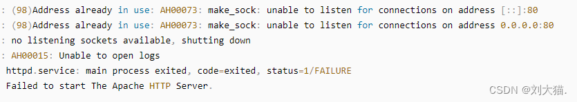

错误场景2:安装phpldapadmin完成后,apache启动报错,执行启动命令systemctl start httpd、systemctl restart httpd、systemctl restart httpd.service报错
详细错误
May 07 10:10:15 localhost.localdomain dbus[580]: [system] Successfully activated service 'org.freedesktop.problems'
May 07 10:12:34 localhost.localdomain kernel: perf: interrupt took too long (16513 > 15557), lowering kernel.perf_event_max_sample_rate to 12000
May 07 10:13:48 localhost.localdomain polkitd[617]: Registered Authentication Agent for unix-process:5169:404183 (system bus name :1.220 [/usr/bin/pkttyagent --notify-fd 5 --fallback], object path /org/freedesktop/PolicyKit1/AuthenticationAgent, locale en_US.UTF-8)
May 07 10:13:52 localhost.localdomain polkitd[617]: Operator of unix-process:5169:404183 successfully authenticated as unix-user:root to gain ONE-SHOT authorization for action org.freedesktop.systemd1.manage-units for system-bus-name::1.221 [systemctl start httpd] (owne
May 07 10:13:52 localhost.localdomain systemd[1]: Starting The Apache HTTP Server...
-- Subject: Unit httpd.service has begun start-up
-- Defined-By: systemd
-- Support: http://lists.freedesktop.org/mailman/listinfo/systemd-devel
-- Unit httpd.service has begun starting up.
May 07 10:13:52 localhost.localdomain httpd[5186]: AH00558: httpd: Could not reliably determine the server's fully qualified domain name, using localhost.localdomain. Set the 'ServerName' directive globally to suppress this message
May 07 10:13:52 localhost.localdomain httpd[5186]: (98)Address already in use: AH00073: make_sock: unable to listen for connections on address [::]:80
May 07 10:13:52 localhost.localdomain httpd[5186]: (98)Address already in use: AH00073: make_sock: unable to listen for connections on address 0.0.0.0:80
May 07 10:13:52 localhost.localdomain httpd[5186]: no listening sockets available, shutting down
May 07 10:13:52 localhost.localdomain httpd[5186]: AH00015: Unable to open logs
May 07 10:13:52 localhost.localdomain systemd[1]: httpd.service: main process exited, code=exited, status=1/FAILURE
May 07 10:13:52 localhost.localdomain systemd[1]: Failed to start The Apache HTTP Server.
-- Subject: Unit httpd.service has failed
-- Unit httpd.service has failed.
-- The result is failed.
May 07 10:13:52 localhost.localdomain polkitd[617]: Unregistered Authentication Agent for unix-process:5169:404183 (system bus name :1.220, object path /org/freedesktop/PolicyKit1/AuthenticationAgent, locale en_US.UTF-8) (disconnected from bus)
May 07 10:13:52 localhost.localdomain systemd[1]: Unit httpd.service entered failed state.
May 07 10:13:52 localhost.localdomain systemd[1]: httpd.service failed.
May 07 10:13:58 localhost.localdomain su[5193]: (to root) zws on pts/0
May 07 10:13:58 localhost.localdomain su[5193]: pam_unix(su:session): session opened for user root by zws(uid=1000)
May 07 10:13:58 localhost.localdomain dbus[580]: [system] Activating service name='org.freedesktop.problems' (using servicehelper)
May 07 10:13:58 localhost.localdomain dbus[580]: [system] Successfully activated service 'org.freedesktop.problems'
May 07 10:14:12 localhost.localdomain polkitd[617]: Registered Authentication Agent for unix-process:5232:406549 (system bus name :1.226 [/usr/bin/pkttyagent --notify-fd 5 --fallback], object path /org/freedesktop/PolicyKit1/AuthenticationAgent, locale en_US.UTF-8)
May 07 10:14:12 localhost.localdomain systemd[1]: Starting The Apache HTTP Server...
May 07 10:14:12 localhost.localdomain httpd[5239]: AH00558: httpd: Could not reliably determine the server's fully qualified domain name, using localhost.localdomain. Set the 'ServerName' directive globally to suppress this message
May 07 10:14:12 localhost.localdomain httpd[5239]: (98)Address already in use: AH00073: make_sock: unable to listen for connections on address [::]:80
May 07 10:14:12 localhost.localdomain httpd[5239]: (98)Address already in use: AH00073: make_sock: unable to listen for connections on address 0.0.0.0:80
May 07 10:14:12 localhost.localdomain httpd[5239]: no listening sockets available, shutting down
May 07 10:14:12 localhost.localdomain httpd[5239]: AH00015: Unable to open logs
May 07 10:14:12 localhost.localdomain systemd[1]: httpd.service: main process exited, code=exited, status=1/FAILURE
May 07 10:14:12 localhost.localdomain systemd[1]: Failed to start The Apache HTTP Server.
May 07 10:14:12 localhost.localdomain systemd[1]: Unit httpd.service entered failed state.
May 07 10:14:12 localhost.localdomain systemd[1]: httpd.service failed.
May 07 10:14:12 localhost.localdomain polkitd[617]: Unregistered Authentication Agent for unix-process:5232:406549 (system bus name :1.226, object path /org/freedesktop/PolicyKit1/AuthenticationAgent, locale en_US.UTF-8) (disconnected from bus)

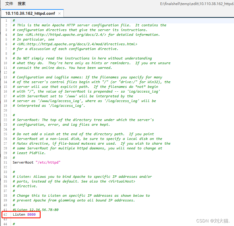

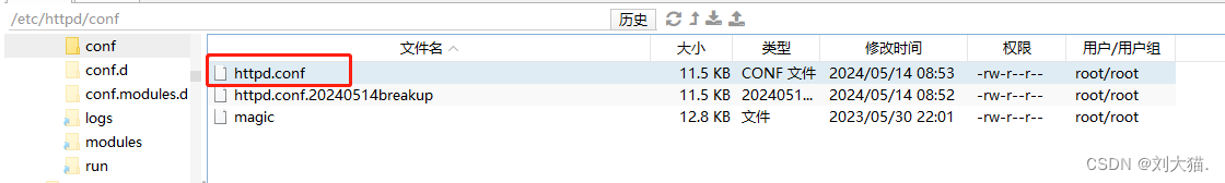

错误原因:nginx和apache默认端口都是80,因为nginx得用不能随意修改,所以只能考虑修改apache端口号。
解决方案:修改apache端口号即可,比如改为8080。
修改apache端口号文件所在路径:/etc/httpd/conf/httpd.conf /etc/httpd/conf/httpd.conf
修改完成后执行命令即可。
