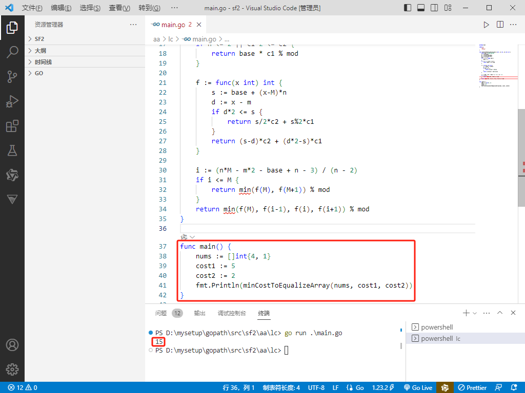

Go完整代码如下:
package main
import (
	"fmt"
	"slices"
func minCostToEqualizeArray(nums []int, c1 int, c2 int) int {
	const mod = 1_000_000_007
	n := len(nums)
	m := slices.Min(nums)
	M := slices.Max(nums)
	base := n * M
	for _, x := range nums {
		base -= x
	if n <= 2 || c1*2 <= c2 {
		return base * c1 % mod
	f := func(x int) int {
		s := base + (x-M)*n
		d := x - m
		if d*2 <= s {
			return s/2*c2 + s%2*c1
		return (s-d)*c2 + (d*2-s)*c1
	i := (n*M - m*2 - base + n - 3) / (n - 2)
	if i <= M {
		return min(f(M), f(M+1)) % mod
	return min(f(M), f(i-1), f(i), f(i+1)) % mod

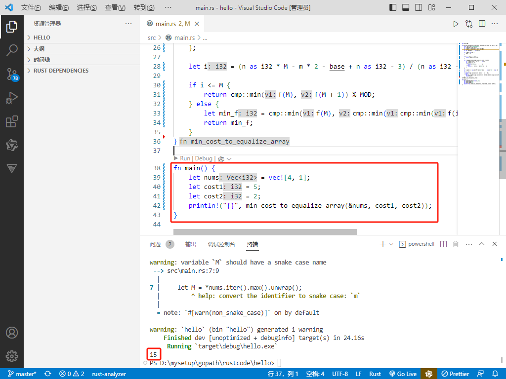

func main() {
	nums := []int{4, 1}
	cost1 := 5
	cost2 := 2
	fmt.Println(minCostToEqualizeArray(nums, cost1, cost2))
Rust完整代码如下:
use std::cmp;
fn min_cost_to_equalize_array(nums: &Vec<i32>, c1: i32, c2: i32) -> i32 {
    const MOD: i32 = 1_000_000_007;
    let n = nums.len();
    let m = *nums.iter().min().unwrap();
    let M = *nums.iter().max().unwrap();
    let mut base = n as i32 * M;
    for x in nums {
        base -= x;
    if n <= 2 || c1 * 2 <= c2 {
        return (base * c1) % MOD;
    let f = |x: i32| -> i32 {
        let s = base + (x - M) * n as i32;
        let d = x - m;
        if d * 2 <= s {
            return s / 2 * c2 + s % 2 * c1;
        } else {
            return (s - d) * c2 + (d * 2 - s) * c1;
    let i = (n as i32 * M - m * 2 - base + n as i32 - 3) / (n as i32 - 2);
    if i <= M {
        return cmp::min(f(M), f(M + 1)) % MOD;
    } else {
        let min_f = cmp::min(f(M), cmp::min(cmp::min(f(i - 1), f(i)), f(i + 1))) % MOD;
        return min_f;
fn main() {
    let nums = vec![4, 1];
    let cost1 = 5;
    let cost2 = 2;
    println!("{}", min_cost_to_equalize_array(&nums, cost1, cost2));
