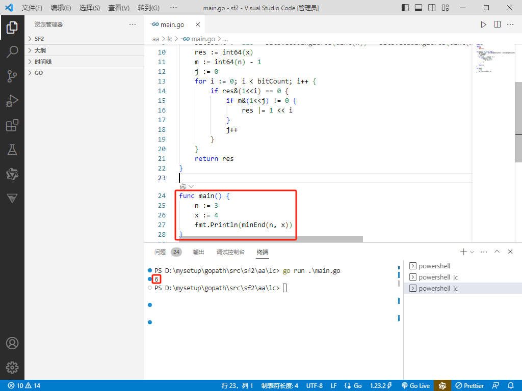

Go完整代码如下:
package main
import (
	"fmt"
	"math/bits"
func minEnd(n int, x int) int64 {
	bitCount := 128 - bits.LeadingZeros(uint(n)) - bits.LeadingZeros(uint(x))
	res := int64(x)
	m := int64(n) - 1
	j := 0
	for i := 0; i < bitCount; i++ {
		if res&(1<<i) == 0 {
			if m&(1<<j) != 0 {
				res |= 1 << i
			j++
	return res
func main() {
	n := 3
	x := 4
	fmt.Println(minEnd(n, x))

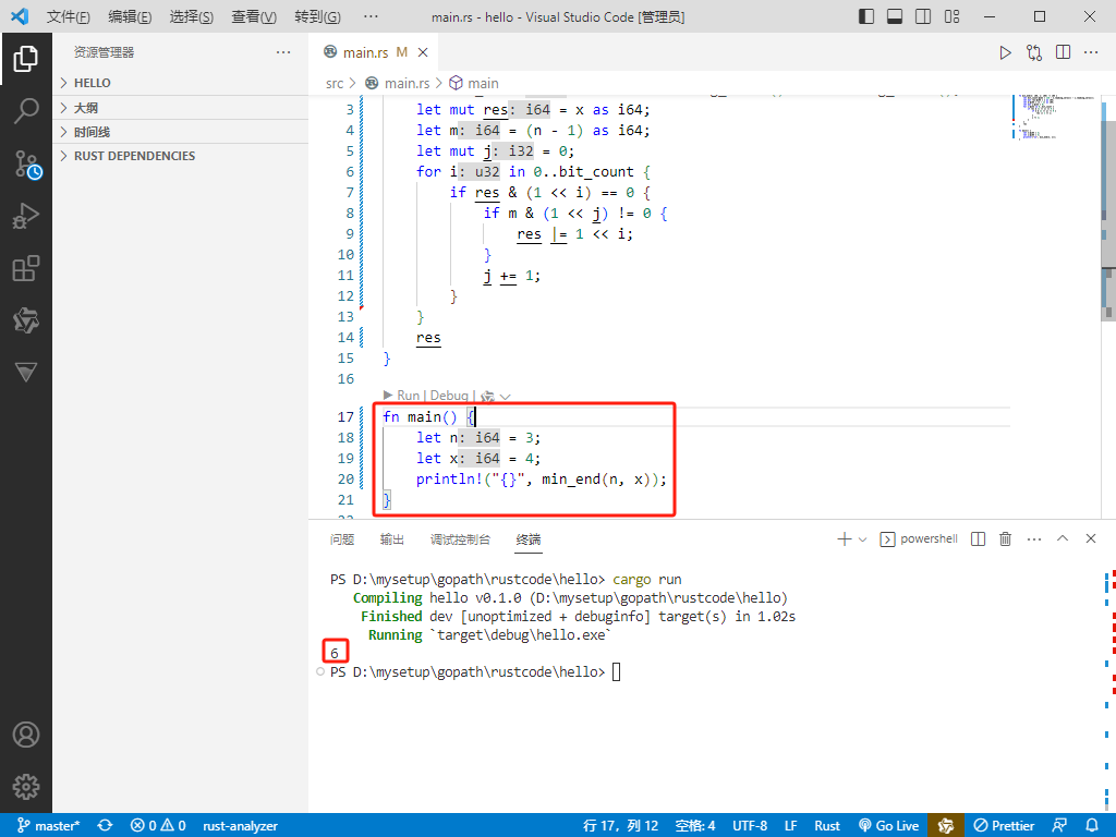

Rust完整代码如下:
fn min_end(n: i64, x: i64) -> i64 {
    let bit_count = 128 - n.leading_zeros() - x.leading_zeros();
    let mut res = x as i64;
    let m = (n - 1) as i64;
    let mut j = 0;
    for i in 0..bit_count {
        if res & (1 << i) == 0 {
            if m & (1 << j) != 0 {
                res |= 1 << i;
            j += 1;
    res
fn main() {
    let n = 3;
    let x = 4;
    println!("{}", min_end(n, x));
