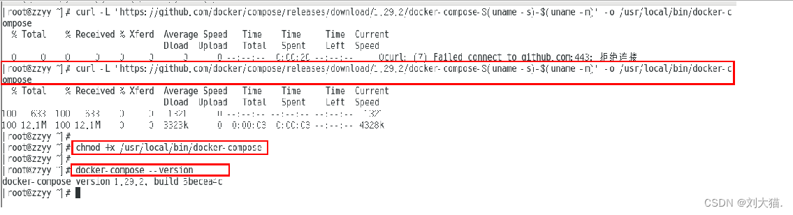

  • 安装步骤
curl -L "https://github.com/docker/compose/releases/download/1.29.2/docker-compose-$(uname -s)-$(uname -m)" -o /usr/local/bin/docker-compose
chmod +x /usr/local/bin/docker-compose
docker-compose --version

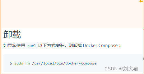

  • 卸载步骤

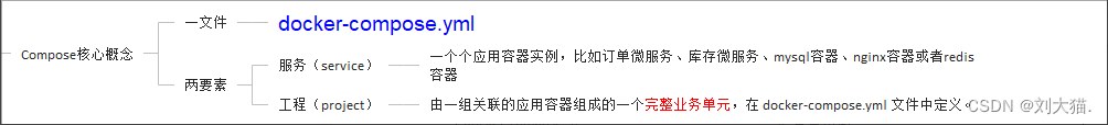

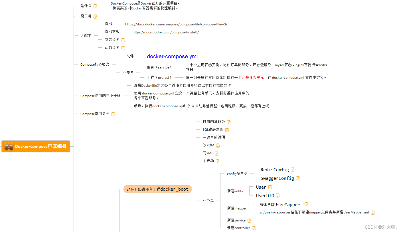

5.4 Compose核心概念

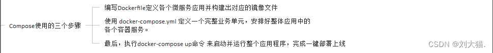

5.5 Compose使用的三个步骤
5.6 Compose常用命令

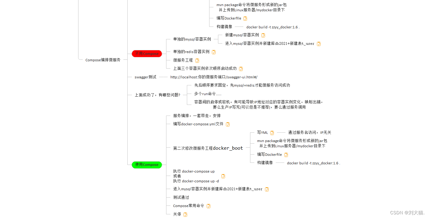

5.7.2不用Compose
  • 单独的mysql容器实例-新建mysql容器实例
docker run -p 3306:3306 --name mysql57 --privileged=true -v /zzyyuse/mysql/conf:/etc/mysql/conf.d -v /zzyyuse/mysql/logs:/logs -v /zzyyuse/mysql/data:/var/lib/mysql -e MYSQL_ROOT_PASSWORD=123456 -d mysql:5.7
  • 单独的mysql容器实例-进入mysql容器实例并新建库db2021+新建表t_user
docker exec -it mysql57 /bin/bash
mysql -uroot -p
create database db2021;
use db2021;
CREATE TABLE `t_user` (
  `id` INT(10) UNSIGNED NOT NULL AUTO_INCREMENT,
  `username` VARCHAR(50) NOT NULL DEFAULT '' COMMENT '用户名',
  `password` VARCHAR(50) NOT NULL DEFAULT '' COMMENT '密码',
  `sex` TINYINT(4) NOT NULL DEFAULT '0' COMMENT '性别 0=女 1=男 ',
  `deleted` TINYINT(4) UNSIGNED NOT NULL DEFAULT '0' COMMENT '删除标志,默认0不删除,1删除',
  `update_time` TIMESTAMP NOT NULL DEFAULT CURRENT_TIMESTAMP ON UPDATE CURRENT_TIMESTAMP COMMENT '更新时间',
  `create_time` TIMESTAMP NOT NULL DEFAULT CURRENT_TIMESTAMP COMMENT '创建时间',
  PRIMARY KEY (`id`)
) ENGINE=INNODB AUTO_INCREMENT=1 DEFAULT CHARSET=utf8mb4 COMMENT='用户表';
  • 单独的redis容器实例
docker run  -p 6379:6379 --name redis608 --privileged=true -v /app/redis/redis.conf:/etc/redis/redis.conf -v /app/redis/data:/data -d redis:6.0.8 redis-server /etc/redis/redis.conf
  • 微服务工程

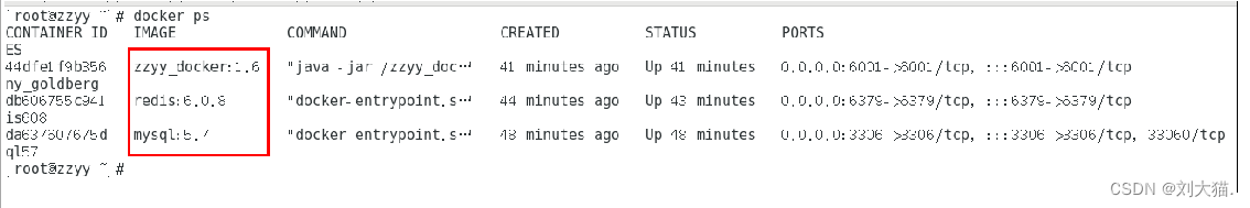

docker run -d -p 6001:6001 zzyy_docker:1.6
  • 上面三个容器实例依次顺序启动成功
5.7.3swagger测试
  • swagger测试
http://localhost:你的微服务端口/swagger-ui.html#/
5.7.4上面成功了,有哪些问题?

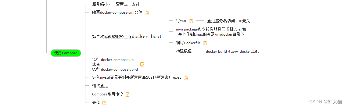

5.7.5使用Compose
  • 编写docker-compose.yml文件
version: "3"
services:
  microService:
    image: zzyy_docker:1.6
    container_name: ms01
    ports:
      - "6001:6001"
    volumes:
      - /app/microService:/data
    networks:
      - atguigu_net
    depends_on:
      - redis
      - mysql
  redis:
    image: redis:6.0.8
    ports:
      - "6379:6379"
    volumes:
      - /app/redis/redis.conf:/etc/redis/redis.conf
      - /app/redis/data:/data
    networks:
      - atguigu_net
    command: redis-server /etc/redis/redis.conf
  mysql:
    image: mysql:5.7
    environment:
      MYSQL_ROOT_PASSWORD: '123456'
      MYSQL_ALLOW_EMPTY_PASSWORD: 'no'
      MYSQL_DATABASE: 'db2021'
      MYSQL_USER:
      MYSQL_PASSWORD:
    ports:
       - "3306:3306"
    volumes:
       - /app/mysql/db:/var/lib/mysql
       - /app/mysql/conf/my.cnf:/etc/my.cnf
       - /app/mysql/init:/docker-entrypoint-initdb.d
    networks:
      - atguigu_net
    command: --default-authentication-plugin=mysql_native_password #解决外部无法访问
networks:
   atguigu_net:

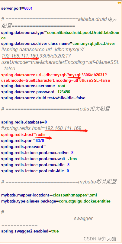

  • 第二次修改微服务工程docker_boot-写YML-通过服务名访问,IP无关
    把springboot项目配置文件中数据库的ip换为mysql,redis的ip换为redis
  • 第二次修改微服务工程docker_boot-mvn package命令将微服务形成新的jar包,并上传到Linux服务器/mydocker目录下
  • 第二次修改微服务工程docker_boot-编写Dockerfile
# 基础镜像使用java
FROM java:8
# 作者
MAINTAINER zzyy
# VOLUME 指定临时文件目录为/tmp,在主机/var/lib/docker目录下创建了一个临时文件并链接到容器的/tmp
VOLUME /tmp
# 将jar包添加到容器中并更名为zzyy_docker.jar
ADD docker_boot-0.0.1-SNAPSHOT.jar zzyy_docker.jar
# 运行jar包
RUN bash -c 'touch /zzyy_docker.jar'
ENTRYPOINT ["java","-jar","/zzyy_docker.jar"]
#暴露6001端口作为微服务
EXPOSE 6001
  • 第二次修改微服务工程docker_boot-构建镜像
执行命令:docker build -t zzyy_docker:1.6 .

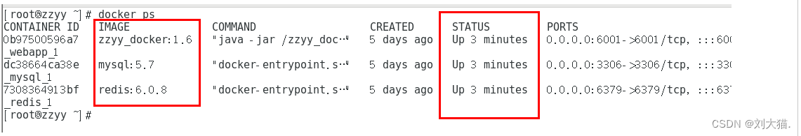

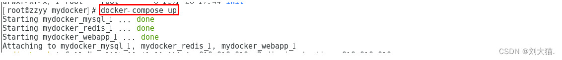

  • 执行 docker-compose up或者执行 docker-compose up -d
  • 进入mysql容器实例并新建库db2021+新建表t_user
docker exec -it 容器实例id /bin/bash
mysql -uroot -p
use db2021;
  PRIMARY KEY (`id`)
  • 测试通过

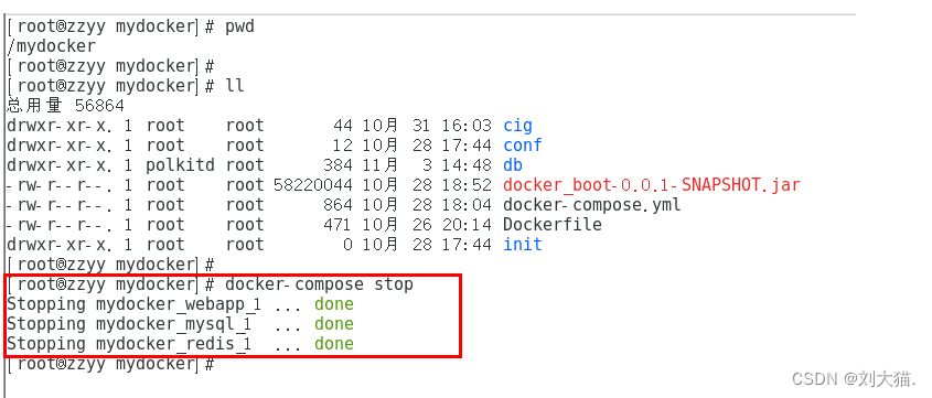

  • 关停
