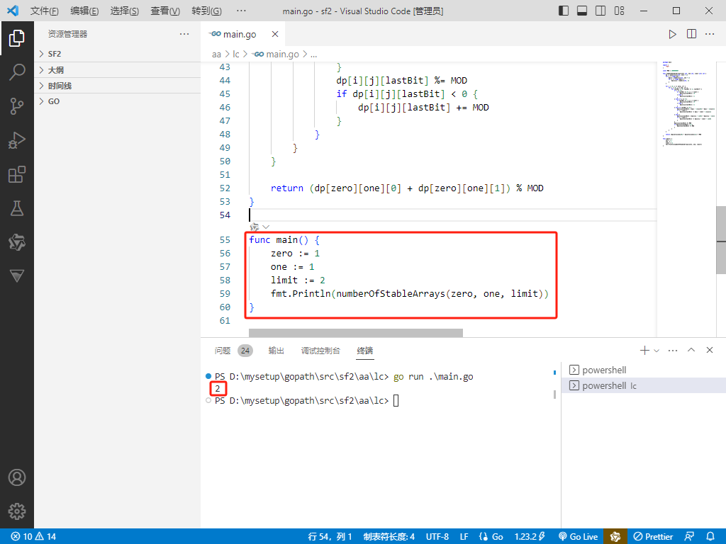

Go完整代码如下:
package main
import (
	"fmt"
const MOD = 1000000007
func numberOfStableArrays(zero int, one int, limit int) int {
    dp := make([][][]int, zero + 1)
    for i := range dp {
        dp[i] = make([][]int, one + 1)
        for j := range dp[i] {
            dp[i][j] = make([]int, 2)
    for i := 0; i <= zero; i++ {
        for j := 0; j <= one; j++ {
            for lastBit := 0; lastBit <= 1; lastBit++ {
                if i == 0 {
                    if lastBit == 0 || j > limit {
                        dp[i][j][lastBit] = 0
                    } else {
                        dp[i][j][lastBit] = 1
                } else if j == 0 {
                    if lastBit == 1 || i > limit {
                    } else {
                } else if lastBit == 0 {
                    dp[i][j][lastBit] = dp[i - 1][j][0] + dp[i - 1][j][1]
                    if i > limit {
                        dp[i][j][lastBit] -= dp[i - limit - 1][j][1]
                } else {
                    dp[i][j][lastBit] = dp[i][j - 1][0] + dp[i][j - 1][1]
                    if j > limit {
                        dp[i][j][lastBit] -= dp[i][j - limit - 1][0]
                dp[i][j][lastBit] %= MOD
                if dp[i][j][lastBit] < 0 {
                    dp[i][j][lastBit] += MOD
    return (dp[zero][one][0] + dp[zero][one][1]) % MOD
func main() {
	zero := 1
	one := 1
	limit := 2
	fmt.Println(numberOfStableArrays(zero, one, limit))

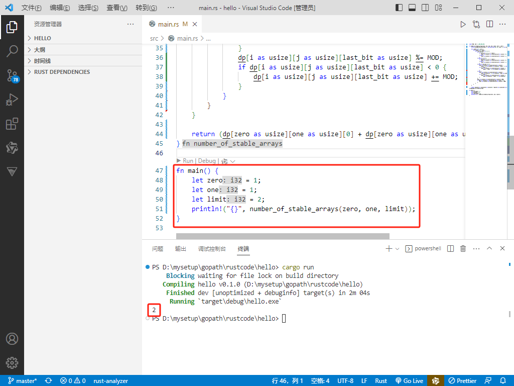

Rust完整代码如下:
const MOD: i64 = 1_000_000_007;
fn number_of_stable_arrays(zero: i32, one: i32, limit: i32) -> i64 {
    let mut dp = vec![vec![vec![0; 2]; (one + 1) as usize]; (zero + 1) as usize];
    for i in 0..=zero {
        for j in 0..=one {
            for last_bit in 0..=1 {
                if i == 0 {
                    if last_bit == 0 || j > limit {
                        dp[i as usize][j as usize][last_bit as usize] = 0;
                    } else {
                        dp[i as usize][j as usize][last_bit as usize] = 1;
                } else if j == 0 {
                    if last_bit == 1 || i > limit {
                    } else {
                } else if last_bit == 0 {
                        dp[(i - 1) as usize][j as usize][0] + dp[(i - 1) as usize][j as usize][1];
                    if i > limit {
                        dp[i as usize][j as usize][last_bit as usize] -=
                            dp[(i - limit - 1) as usize][j as usize][1];
                } else {
                        dp[i as usize][(j - 1) as usize][0] + dp[i as usize][(j - 1) as usize][1];
                    if j > limit {
                            dp[i as usize][(j - limit - 1) as usize][0];
                dp[i as usize][j as usize][last_bit as usize] %= MOD;
                if dp[i as usize][j as usize][last_bit as usize] < 0 {
                    dp[i as usize][j as usize][last_bit as usize] += MOD;
    return (dp[zero as usize][one as usize][0] + dp[zero as usize][one as usize][1]) % MOD;
fn main() {
    let zero = 1;
    let one = 1;
    let limit = 2;
    println!("{}", number_of_stable_arrays(zero, one, limit));
