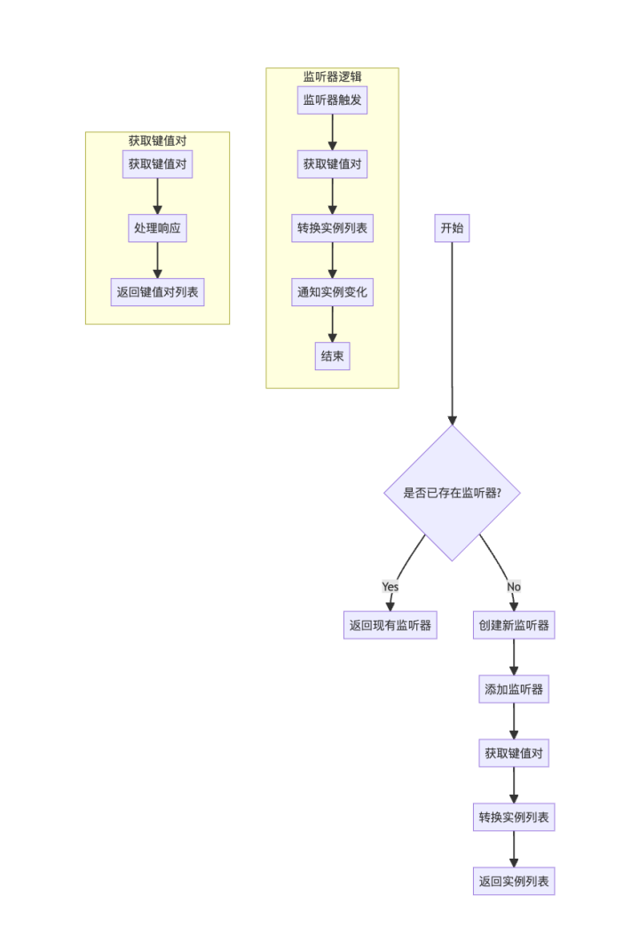

重点介绍一下EtcdDiscovery.findServiceInstances的逻辑,代码如下:
public List<EtcdDiscoveryInstance> findServiceInstances(String application, String serviceName) {
  String prefixPath = basePath + "/" + application + "/" + serviceName;
  watchMap.computeIfAbsent(prefixPath, serName -> {
    Watch watchClient = client.getWatchClient();
    try {
      ByteSequence prefixByteSeq = ByteSequence.from(prefixPath, Charset.defaultCharset());
      watchClient.watch(prefixByteSeq, WatchOption.builder().withPrefix(prefixByteSeq).build(),
          resp -> watchNode(application, serviceName, prefixPath));
    } catch (Exception e) {
      LOGGER.error("Failed to add watch", e);
    return watchClient;
  List<KeyValue> endpointKv = getValuesByPrefix(prefixPath);
  return convertServiceInstanceList(endpointKv);
private void watchNode(String application, String serviceName, String prefixPath) {
  CompletableFuture<GetResponse> getFuture = client.getKVClient()
      .get(ByteSequence.from(prefixPath, StandardCharsets.UTF_8),
          GetOption.builder().withPrefix(ByteSequence.from(prefixPath, StandardCharsets.UTF_8)).build());
  getFuture.thenAcceptAsync(response -> {
    List<EtcdDiscoveryInstance> discoveryInstanceList = convertServiceInstanceList(response.getKvs());
    instanceChangedListener.onInstanceChanged(name(), application, serviceName, discoveryInstanceList);
  }).exceptionally(e -> {
    LOGGER.error("watchNode error", e);
    return null;
private List<KeyValue> getValuesByPrefix(String prefix) {
      .get(ByteSequence.from(prefix, StandardCharsets.UTF_8),
          GetOption.builder().withPrefix(ByteSequence.from(prefix, StandardCharsets.UTF_8)).build());
  GetResponse response = MuteExceptionUtil.builder().withLog("get kv by prefix error")
      .executeCompletableFuture(getFuture);
  return response.getKvs();
代码功能解释
findServiceInstances 方法
构建前缀路径:根据 application 和 serviceName 构建 prefixPath。
添加监听器:使用 watchMap 确保每个 prefixPath 只有一个监听器,通过 client.getWatchClient() 添加监听器。
获取键值对:调用 getValuesByPrefix 获取前缀路径下的所有键值对。
转换实例列表:调用 convertServiceInstanceList 将键值对转换为 EtcdDiscoveryInstance 列表。
watchNode 方法
获取键值对:通过 client.getKVClient().get 获取前缀路径下的所有键值对。
处理响应:异步处理响应,将键值对转换为 EtcdDiscoveryInstance 列表,并调用 instanceChangedListener.onInstanceChanged 通知实例变化。
异常处理:记录异常日志。
getValuesByPrefix 方法
处理响应:使用 MuteExceptionUtil.builder 处理异步响应,记录异常日志并返回键值对列表。

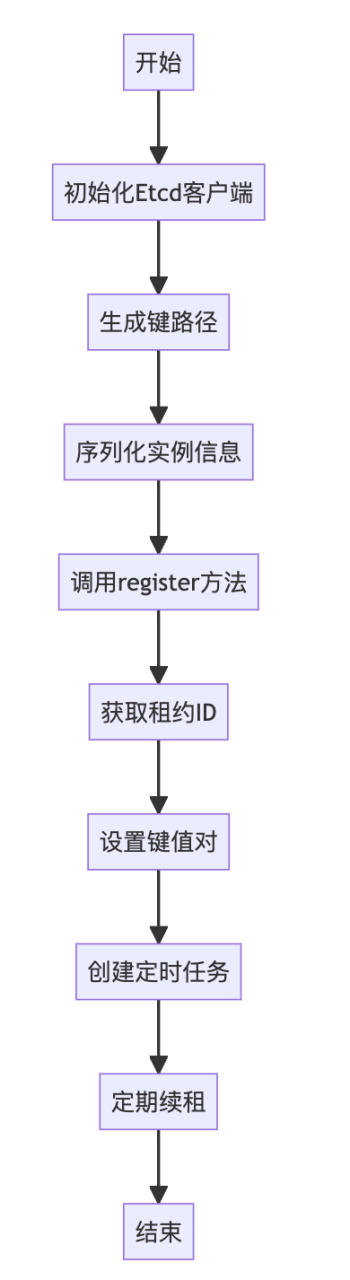

重点介绍一下EtcdRegistration.run的逻辑,代码如下:
@Override
public void run() {
  client = Client.builder().endpoints(etcdRegistryProperties.getConnectString())
      .build();
  keyPath = basePath + "/" +
      BootStrapProperties.readApplication(environment) + "/" +
      BootStrapProperties.readServiceName(environment) + "/" +
      registrationId.getInstanceId();
  String valueJson = MuteExceptionUtil.builder().withLog("to json, key:{}, value:{}", keyPath, etcdInstance)
      .executeFunction(JsonUtils::writeValueAsString, etcdInstance);
  register(ByteSequence.from(keyPath, Charset.defaultCharset()),
      ByteSequence.from(valueJson, Charset.defaultCharset()));
public void register(ByteSequence key, ByteSequence value) {
  Lease leaseClient = client.getLeaseClient();
  leaseId = MuteExceptionUtil.builder().withLog("get lease id, key:{}, value:{}", keyPath, etcdInstance)
      .executeCompletableFuture(leaseClient.grant(60)).getID();
  KV kvClient = client.getKVClient();
  PutOption putOption = PutOption.builder().withLeaseId(leaseId).build();
  CompletableFuture<PutResponse> putResponse = kvClient.put(key, value, putOption);
  putResponse.thenRun(() -> {
    executorService = Executors.newSingleThreadScheduledExecutor();
    executorService.scheduleAtFixedRate(
        () -> MuteExceptionUtil.builder().withLog("reRegister, {}, {}", keyPath, etcdInstance)
            .executeFunction(leaseClient::keepAliveOnce, leaseId), 0, 5, TimeUnit.SECONDS);
详细步骤
初始化客户端:使用Client.builder()构建Etcd客户端,并设置连接端点。
生成键路径:根据环境配置生成键路径keyPath,格式为basePath/application/serviceName/instanceId。
序列化实例信息:使用MuteExceptionUtil.builder()构建异常处理工具,调用JsonUtils.writeValueAsString将etcdInstance对象转换为JSON字符串。
注册服务:调用register方法,传入生成的键和值。
获取租约ID:使用MuteExceptionUtil.builder()构建异常处理工具,调用leaseClient.grant(60)获取租约ID。
设置键值对:使用kvClient.put将键值对写入Etcd,并设置租约ID。
定期续租:创建单线程定时任务,每5秒调用leaseClient.keepAliveOnce续租。
流程图如下:

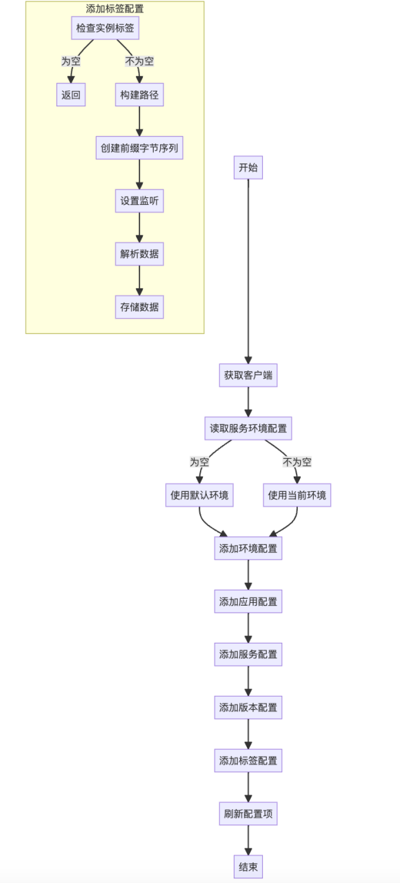

下面介绍一下dynamic-config下的config-etcd模块
通过Java的spi机制读取DynamicPropertiesSource,实现自动读取。
实现DynamicPropertiesSource的核心方法
重点解释一下EtcdClient的方法,代码如下:
public void refreshEtcdConfig() throws Exception {
  getClient();
  String env = BootStrapProperties.readServiceEnvironment(environment);
  if (StringUtils.isEmpty(env)) {
    env = EtcdConfig.ZOOKEEPER_DEFAULT_ENVIRONMENT;
  addEnvironmentConfig(env);
  addApplicationConfig(env);
  addServiceConfig(env);
  addVersionConfig(env);
  addTagConfig(env);
  refreshConfigItems();
private void addTagConfig(String env) throws Exception {
  if (StringUtils.isEmpty(etcdConfig.getInstanceTag())) {
    return;
  String path = String.format(PATH_TAG, env,
      BootStrapProperties.readApplication(environment),
      BootStrapProperties.readServiceName(environment),
      BootStrapProperties.readServiceVersion(environment),
      etcdConfig.getInstanceTag());
  ByteSequence prefixByteSeq = ByteSequence.from(path, Charset.defaultCharset());
      resp -> new Thread(new GetDataRunable(tagData, this, path)).start());
  this.tagData = parseData(path);
代码解释
refreshEtcdConfig 方法
获取客户端:调用 getClient() 方法初始化 Etcd 客户端。
读取环境变量:从 environment 中读取服务环境配置 env,如果为空则使用默认值 ZOOKEEPER_DEFAULT_ENVIRONMENT。
添加配置:依次调用 addEnvironmentConfig、addApplicationConfig、addServiceConfig、addVersionConfig 和 addTagConfig 方法,分别添加环境、应用、服务、版本和标签配置。
刷新配置项:调用 refreshConfigItems 方法,合并所有配置项并更新。
addTagConfig 方法
检查实例标签:如果 etcdConfig.getInstanceTag() 为空,则直接返回。
构建路径:使用 String.format 构建标签配置的路径 path。
创建前缀字节序列:将路径转换为 ByteSequence。
设置监听:使用 client.getWatchClient() 设置监听器,当路径下的数据发生变化时,启动新线程执行 GetDataRunable。
解析数据:调用 parseData(path) 方法解析路径下的配置数据,并存储在 tagData 中。
流程图如下:

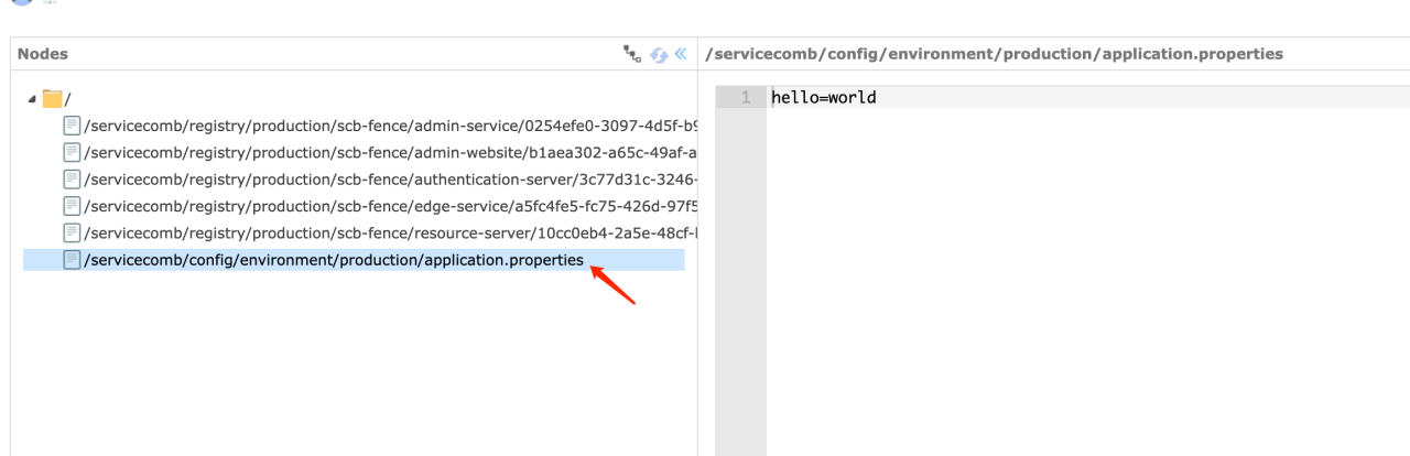

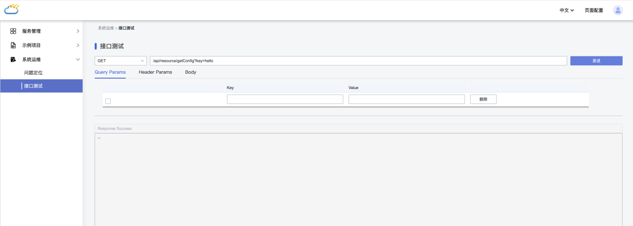

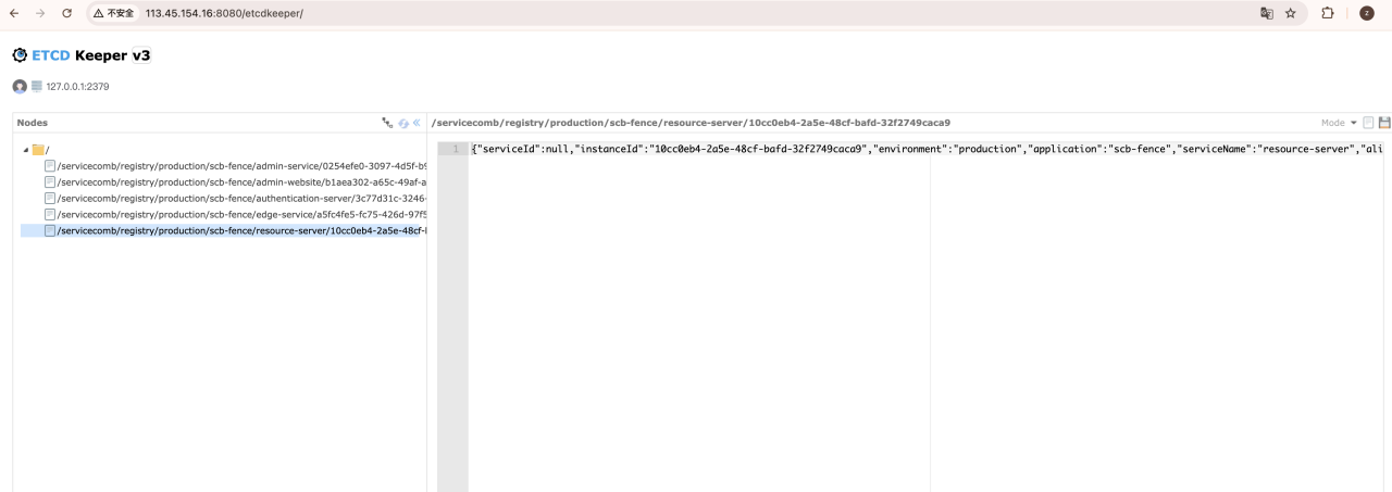

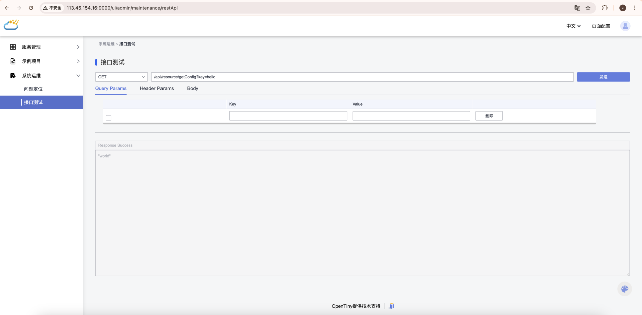

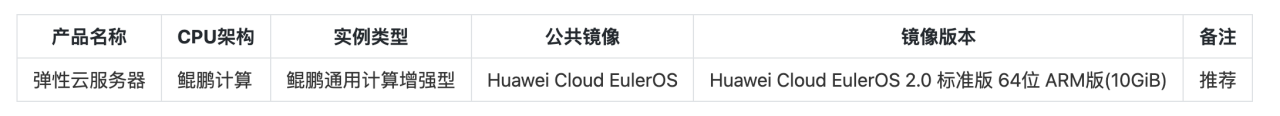

步骤5:购买华为云
步骤6:测试结果
修改动作:
修改前:
修改后:
