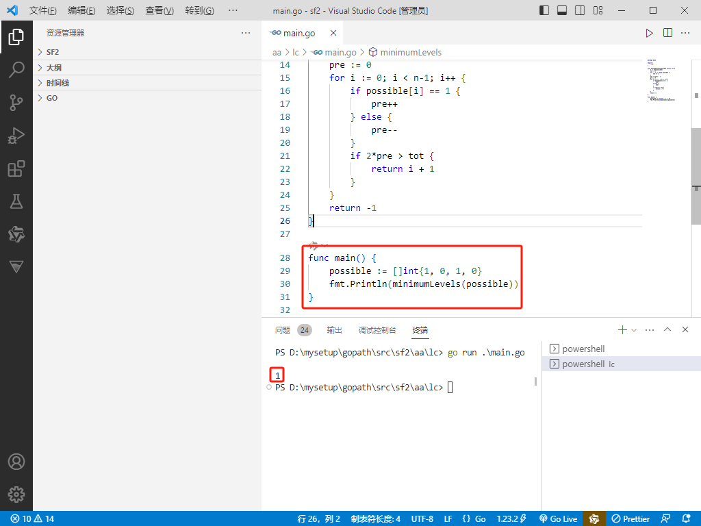

Go完整代码如下:
package main
import (
	"fmt"
func minimumLevels(possible []int) int {
	n := len(possible)
	tot := 0
	for _, v := range possible {
		tot += v
	tot = tot*2 - n
	pre := 0
	for i := 0; i < n-1; i++ {
		if possible[i] == 1 {
			pre++
		} else {
			pre--
		if 2*pre > tot {
			return i + 1
	return -1
func main() {
	possible := []int{1, 0, 1, 0}
	fmt.Println(minimumLevels(possible))

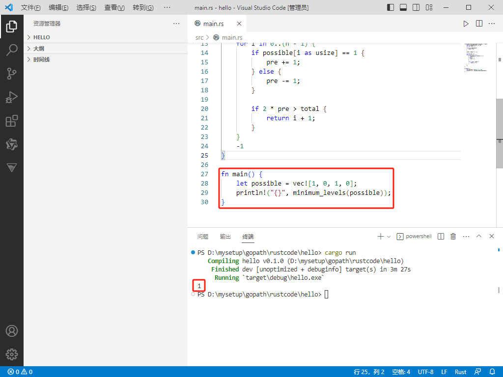

Rust完整代码如下:
fn minimum_levels(possible: Vec<i32>) -> i32 {
    let n = possible.len() as i32;
    let mut total = 0;
    for &v in &possible {
        total += v;
    total = total * 2 - n;
    let mut pre = 0;
    for i in 0..(n - 1) {
        if possible[i as usize] == 1 {
            pre += 1;
        } else {
            pre -= 1;
        if 2 * pre > total {
            return i + 1;
    -1
fn main() {
    let possible = vec![1, 0, 1, 0];
    println!("{}", minimum_levels(possible));
评论(0
