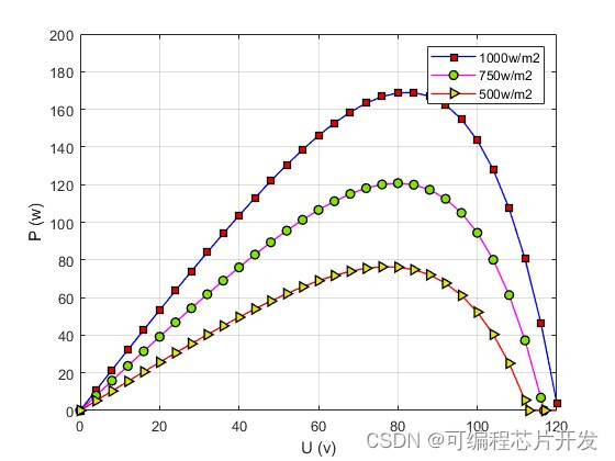

1.课题概述

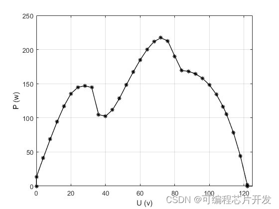

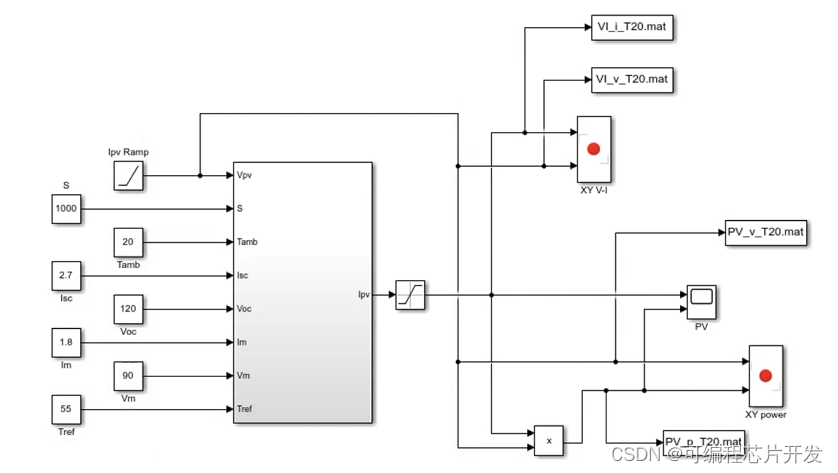

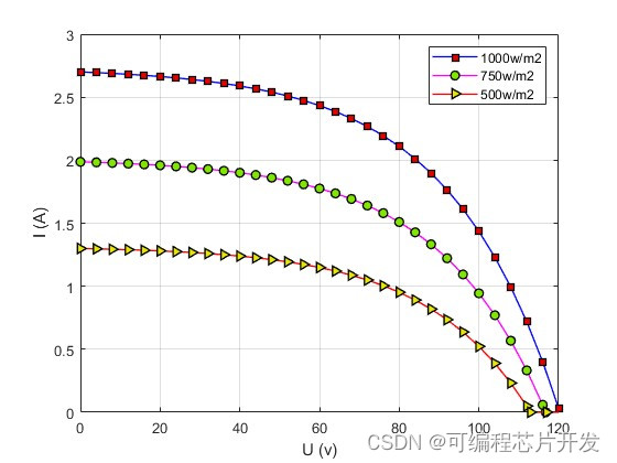

        太阳能光伏电池的simulink建模与仿真.分析不同光照温度,光照强度下的光伏电池的U-I特性曲线以及P-V特性曲线。
2.系统仿真结果

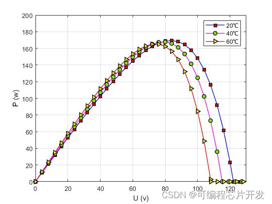

clc;
clear;
close all;
warning off;
R   = 1;
load PV_p_T20.mat
P20 = ans.Data;
load PV_v_T20.mat
V20 = R*ans.Data;
load PV_p_T40.mat
P40 = ans.Data;
load PV_v_T40.mat
V40 = R*ans.Data;
load PV_p_T60.mat
P60 = ans.Data;
load PV_v_T60.mat
V60 = R*ans.Data;
figure;
plot(V20,P20,'-bs',...
    'LineWidth',1,...
    'MarkerSize',6,...
    'MarkerEdgeColor','k',...
    'MarkerFaceColor',[0.9,0.0,0.0]);
hold on
plot(V40,P40,'-mo',...
    'LineWidth',1,...
    'MarkerSize',6,...
    'MarkerFaceColor',[0.5,0.9,0.0]);
hold on
plot(V60,P60,'-r>',...
    'LineWidth',1,...
    'MarkerSize',6,...
    'MarkerFaceColor',[0.9,0.9,0.0]);
hold on
legend('20℃','40℃','60℃');
xlabel('U (v)');
ylabel('P (w)');
grid on
axis([0,130,0,200]);

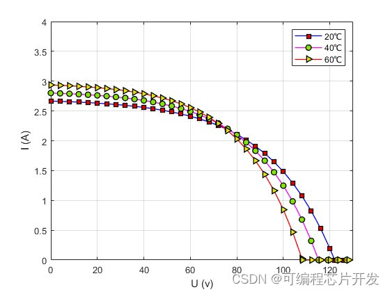

load VI_i_T20.mat
I20 = ans.Data;
load VI_v_T20.mat
V20 = ans.Data;
load VI_i_T40.mat
I40 = ans.Data;
load VI_v_T40.mat
V40 = ans.Data;
load VI_i_T60.mat
I60 = ans.Data;
load VI_v_T60.mat
V60 = ans.Data;
figure;
plot(V20,I20,'-bs',...
    'LineWidth',1,...
    'MarkerSize',6,...
hold on
plot(V40,I40,'-mo',...
    'LineWidth',1,...
    'MarkerSize',6,...
hold on
plot(V60,I60,'-r>',...
    'LineWidth',1,...
    'MarkerSize',6,...
hold on
xlabel('U (v)');
ylabel('I (A)');
grid on
axis([0,130,0,4]);
02_053m
