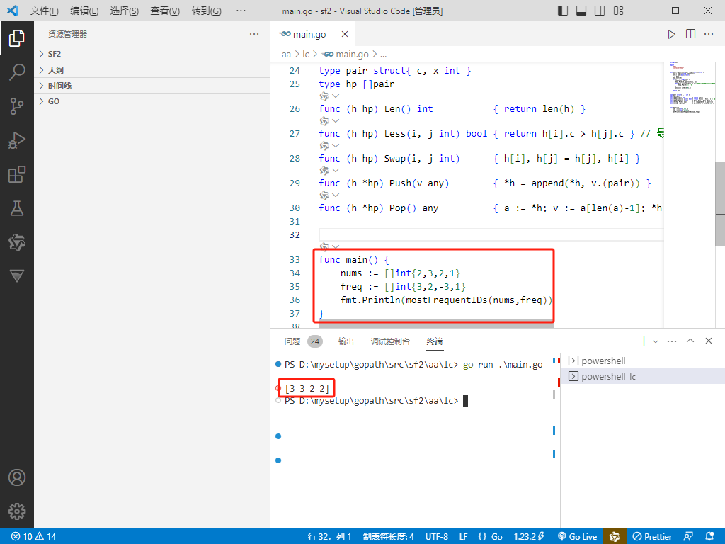

func main() {
	nums := []int{2,3,2,1}
	freq := []int{3,2,-3,1}
	fmt.Println(mostFrequentIDs(nums,freq))
