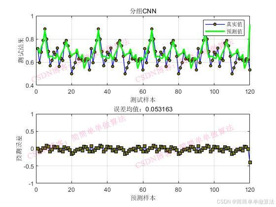

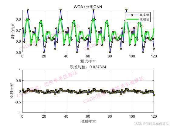

ypred2 = predict(GCNN_net, Dat_test );
figure
plot(Lab_test, 'r')
hold on
plot(ypred2, 'b-o')
legend('真实值', '预测值')
grid on

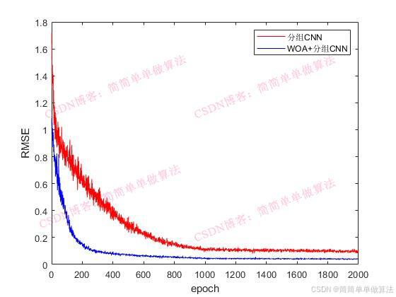

figure
subplot(211)
plot(Rerr)
xlabel('迭代次数')
ylabel('RMSE')
grid on
subplot(212)
plot(Rlos)
xlabel('迭代次数')
ylabel('LOSS')
grid on
