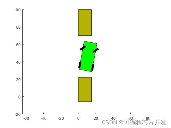

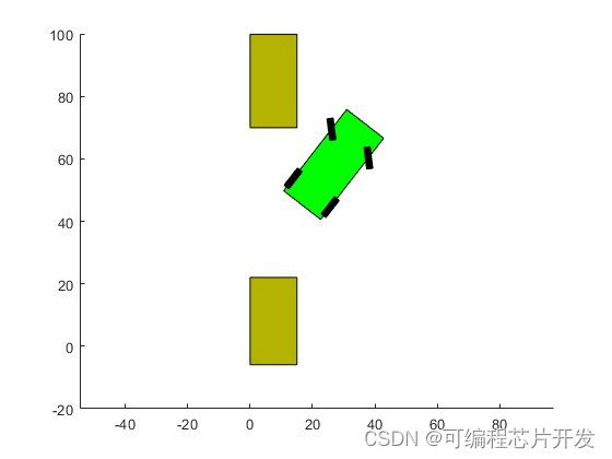

1.课题概述
       小车侧方位停车过程的动态模拟matlab仿真。仿真得到小车的停车动画,小车移动的xy轴坐标以及角度变换。

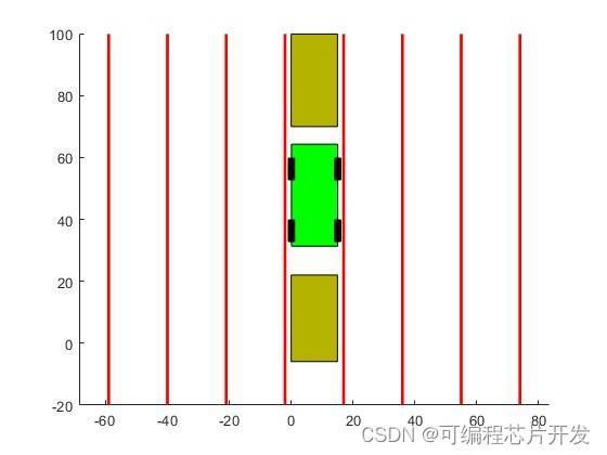

hold on
plot(-59*ones(1,121),[-20:100],'r','linewidth',2);
hold on
plot(-40*ones(1,121),[-20:100],'r','linewidth',2);
hold on
plot(-21*ones(1,121),[-20:100],'r','linewidth',2);
hold on
plot(-2*ones(1,121),[-20:100],'r','linewidth',2);
hold on
plot(17*ones(1,121),[-20:100],'r','linewidth',2);
hold on
plot(36*ones(1,121),[-20:100],'r','linewidth',2);
hold on
plot(55*ones(1,121),[-20:100],'r','linewidth',2);
hold on
plot(74*ones(1,121),[-20:100],'r','linewidth',2);
hold on

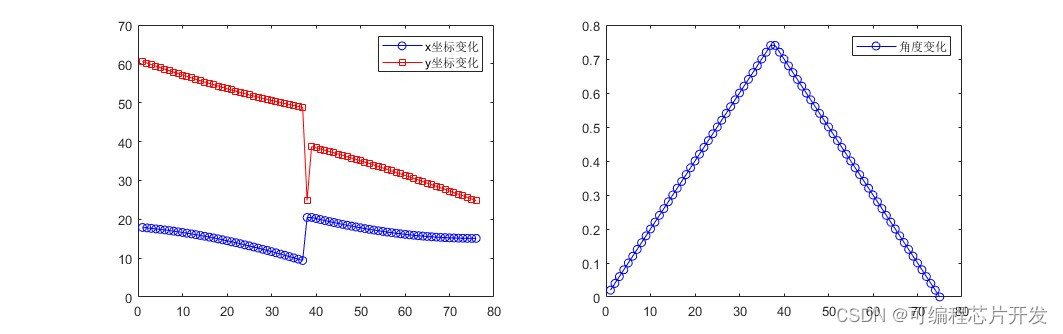

figure;
subplot(121);
plot(Xset,'b-o')
hold on
plot(Yset,'r-s')
legend('x坐标变化','y坐标变化');
subplot(122);
plot(thetas,'b-o')
legend('角度变化');
