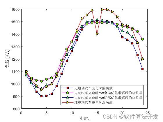

       基于CVX凸优化的电动汽车充放电调度.仿真输出无电动汽车充电时的负载,电动汽车充电时cvx全局优化求解后的总负载,电动汽车充电时cvx局部优化求解后的总负载,纯电动汽车充电时总负载。

disp('CVX二次规划解...');
cvx_begin
    variable v_x(Nvars);
    minimize(  k0*sum(pow_p(v_x(1:Nslot),1)) + (k1/2)*sum(pow_p(v_x(1:Nslot),2)) + beta*sum(square(F1)*square(v_x(Nslot+1:Nvars)))-k0*sum(pow_p(Load_basic0(1:Nslot),1)) - (k1/2)*sum(pow_p(Load_basic0(1:Nslot),2)) )
    % 目标函数和约束条件
    Eq_L * v_x == Eq_R;
    Ij1 * v_x <= Ij2;
    Ij3 * v_x <= Ij4;
    Ij5 * v_x <= Ij6;
    v_x >= Xmin;
    v_x <= Xmax;
cvx_end
% 绘制不包括电动汽车充电的基础负载
figure;
plot(1:Nslot,Load_basic0,'-bs',...
    'LineWidth',1,...
    'MarkerSize',6,...
    'MarkerEdgeColor','k',...
    'MarkerFaceColor',[0.9,0.0,0.0]);
hold on
plot(1:Nslot,VE_load(:,3),'-mo',...
    'LineWidth',1,...
    'MarkerSize',6,...
    'MarkerFaceColor',[0.5,0.9,0.0]);
hold on
plot(1:Nslot,Charged_Load(:,3),'-b^',...
    'LineWidth',1,...
    'MarkerSize',6,...
    'MarkerFaceColor',[0.2,0.9,0.5]);
hold on
plot(1:Nslot,N_Charged_Load(:,3),'-r>',...
    'LineWidth',1,...
    'MarkerSize',6,...
    'MarkerFaceColor',[0.9,0.9,0.0]);
ylabel('负载 [KW]');
xlabel('小时.');
legend('无电动汽车充电时的负载','电动汽车充电时cvx全局优化求解后的总负载','电动汽车充电时cvx局部优化求解后的总负载','纯电动汽车充电时总负载');

fprintf('应充电能量总量 %g.\n\n',total_charged);
fprintf('实际充电能量总量:全局最优方案=%g, 局部最优方案=%g, 等额分配方案=%g.\n\n',sum(Result(:,2)-Result(:,1)), sum(Result(:,3)-Result(:,1)), sum(Result(:,4)-Result(:,1)) );
% 负载峰值
Peak_based=max(Load_basic0); % 基础负载
Peak_Charged=max(Charged_Load(:,3)); % 充电后的负载
Peak_reduction=(Peak_based-Peak_Charged)/Peak_based;
fprintf('峰值比较:基础负载=%g, 全局最优方案=%g, 局部最优方案=%g, 等额分配方案=%g KW.\n\n',max(Result(:,1)), max(Result(:,2)), max(Result(:,3)), max(Result(:,4)) );
