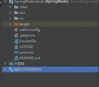

3.2 Springblade代码初始化
先把源代码导入IDEA,
使用maven进行构建,使用阿里云镜像站作为maven远程仓
mvn clean install
整个构建过程比较和谐,没有出现什么问题。

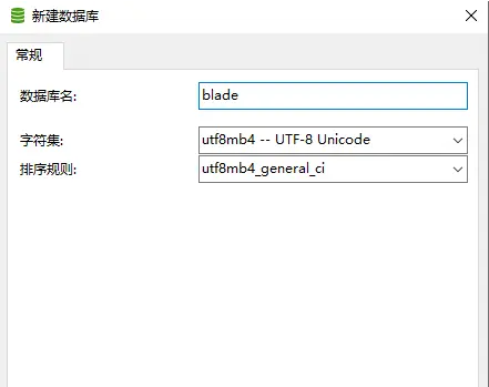

3.3 数据库初始化
创建blade数据库
导入项目中的sql文件,由于前端使用vue,所以导入blade-saber-mysql.sql
导入后表如下图

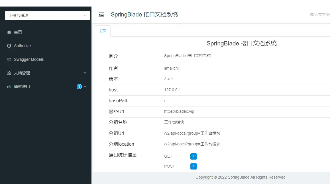

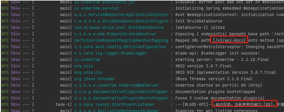

从启动类Application.java启动项目。
看到项目启动,访问swagger地址:http://127.0.0.1/doc.html,如下图所示,后端项目启动成功

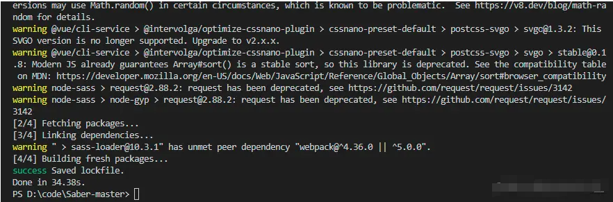

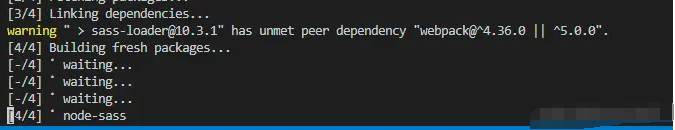

意外发生了
卡在这里,报错如下
npm install node-sass npm ERR! code 1 npm ERR! path D:\code\Saber-master\node_modules\node-sass npm ERR! command failed npm ERR! command C:\Windows\system32\cmd.exe /d /s /c node scripts/build.js npm ERR! Building: C:\Program Files\nodejs\node.exe D:\code\Saber-master\node_modules\node-sass\node_modules\node-gyp\bin\node-gyp.js rebuild --verbose --libsass_ext= --libsass_cflags= --libsass_ldflags= --libsass_library= npm ERR! gyp info it worked if it ends with ok npm ERR! gyp verb cli [ npm ERR! gyp verb cli 'C:\Program Files\nodejs\node.exe', npm ERR! gyp verb cli 'D:\code\Saber-master\node_modules\node-sass\node_modules\node-gyp\bin\node-gyp.js', npm ERR! gyp verb cli 'rebuild', npm ERR! gyp verb cli '--verbose', npm ERR! gyp verb cli '--libsass_ext=', npm ERR! gyp verb cli '--libsass_cflags=', npm ERR! gyp verb cli '--libsass_ldflags=', npm ERR! gyp verb cli '--libsass_library=' npm ERR! gyp verb cli ] npm ERR! gyp info using node-gyp@7.1.2 npm ERR! gyp info using node@16.13.1 | win32 | x64 npm ERR! gyp verb command rebuild [] npm ERR! gyp verb command clean [] npm ERR! gyp verb clean removing "build" directory npm ERR! gyp verb command configure [] npm ERR! gyp verb find Python Python is not set from command line or npm configuration npm ERR! gyp verb find Python Python is not set from environment variable PYTHON npm ERR! gyp verb find Python checking if "python3" can be used npm ERR! gyp verb find Python - executing "python3" to get executable path npm ERR! gyp verb find Python - "python3" is not in PATH or produced an error npm ERR! gyp verb find Python checking if "python" can be used npm ERR! gyp verb find Python - executing "python" to get executable path npm ERR! gyp verb find Python - executable path is "C:\Program Files\Python27\python.exe" npm ERR! gyp verb find Python - executing "C:\Program Files\Python27\python.exe" to get version npm ERR! gyp verb find Python - version is "2.7.18" npm ERR! gyp info find Python using Python version 2.7.18 found at "C:\Program Files\Python27\python.exe" npm ERR! gyp verb get node dir no --target version specified, falling back to host node version: 16.13.1 npm ERR! gyp verb command install [ '16.13.1' ] npm ERR! gyp verb install input version string "16.13.1" npm ERR! gyp verb install installing version: 16.13.1 npm ERR! gyp verb install --ensure was passed, so won't reinstall if already installed npm ERR! gyp verb install version is already installed, need to check "installVersion" npm ERR! gyp verb got "installVersion" 9 npm ERR! gyp verb needs "installVersion" 9 npm ERR! gyp verb install version is good npm ERR! gyp verb get node dir target node version installed: 16.13.1 npm ERR! gyp verb build dir attempting to create "build" dir: D:\code\Saber-master\node_modules\node-sass\build npm ERR! gyp verb build dir "build" dir needed to be created? D:\code\Saber-master\node_modules\node-sass\build npm ERR! gyp verb find VS msvs_version not set from command line or npm config npm ERR! gyp verb find VS VCINSTALLDIR not set, not running in VS Command Prompt npm ERR! gyp verb find VS could not use PowerShell to find Visual Studio 2017 or newer, try re-running with '--loglevel silly' for more details npm ERR! gyp verb find VS looking for Visual Studio 2015 npm ERR! gyp verb find VS - not found npm ERR! gyp verb find VS not looking for VS2013 as it is only supported up to Node.js 8 npm ERR! gyp ERR! find VS npm ERR! gyp ERR! find VS msvs_version not set from command line or npm config npm ERR! gyp ERR! find VS VCINSTALLDIR not set, not running in VS Command Prompt npm ERR! gyp ERR! find VS could not use PowerShell to find Visual Studio 2017 or newer, try re-running with '--loglevel silly' for more details npm ERR! gyp ERR! find VS looking for Visual Studio 2015 npm ERR! gyp ERR! find VS - not found npm ERR! gyp ERR! find VS not looking for VS2013 as it is only supported up to Node.js 8 npm ERR! gyp ERR! find VS npm ERR! gyp ERR! find VS ************************************************************** npm ERR! gyp ERR! find VS You need to install the latest version of Visual Studio npm ERR! gyp ERR! find VS including the "Desktop development with C++" workload. npm ERR! gyp ERR! find VS For more information consult the documentation at: npm ERR! gyp ERR! find VS github.com/nodejs/node… npm ERR! gyp ERR! find VS ************************************************************** npm ERR! gyp ERR! find VS npm ERR! gyp ERR! configure error npm ERR! gyp ERR! stack Error: Could not find any Visual Studio installation to use npm ERR! gyp ERR! stack at VisualStudioFinder.fail (D:\code\Saber-master\node_modules\node-sass\node_modules\node-gyp\lib\find-visualstudio.js:121:47) npm ERR! gyp ERR! stack at D:\code\Saber-master\node_modules\node-sass\node_modules\node-gyp\lib\find-visualstudio.js:74:16 npm ERR! gyp ERR! stack at VisualStudioFinder.findVisualStudio2013 (D:\code\Saber-master\node_modules\node-sass\node_modules\node-gyp\lib\find-visualstudio.js:351:14) npm ERR! gyp ERR! stack at D:\code\Saber-master\node_modules\node-sass\node_modules\node-gyp\lib\find-visualstudio.js:70:14 372:16 npm ERR! gyp ERR! stack at D:\code\Saber-master\node_modules\node-sass\node_modules\node-gyp\lib\util.js:54:7 npm ERR! gyp ERR! stack at D:\code\Saber-master\node_modules\node-sass\node_modules\node-gyp\lib\util.js:33:16 npm ERR! gyp ERR! stack at ChildProcess.emit (node:events:390:28) npm ERR! gyp ERR! stack at maybeClose (node:internal/child_process:1064:16) npm ERR! gyp ERR! System Windows_NT 10.0.19044 npm ERR! gyp ERR! command "C:\Program Files\nodejs\node.exe" "D:\code\Saber-master\node_modules\node-sass\node_modules\node-gyp\bin\node-gyp.js" "rebuild" "--verbose" "--libsass_ext=" "--libsass_cflags=" "--libsass_ldflags=" "--libsass_library=" npm ERR! gyp ERR! cwd D:\code\Saber-master\node_modules\node-sass npm ERR! gyp ERR! node -v v16.13.1 npm ERR! gyp ERR! node-gyp -v v7.1.2 npm ERR! gyp ERR! not ok npm ERR! Build failed with error code: 1 npm ERR! A complete log of this run can be found in: npm ERR! D:\npm\node_cache_logs\2022-09-07T08_53_13_494Z-debug.log

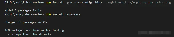

参考 (88条消息) 安装node-sass失败的解决方案_Heigl swift的博客-CSDN博客_node_modules\node-sass
npm install -g mirror-config-china --registry=registry.npm.taobao.org
然后再 yarn install

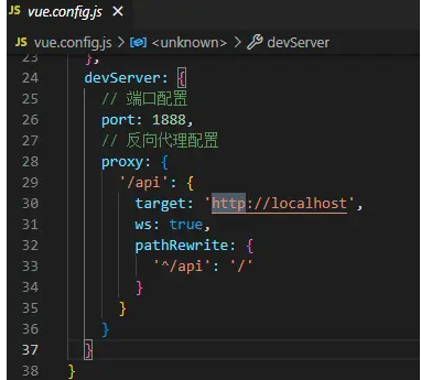

 如果后台地址有变化,在这个文件修改

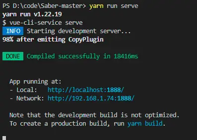

启动前端项目

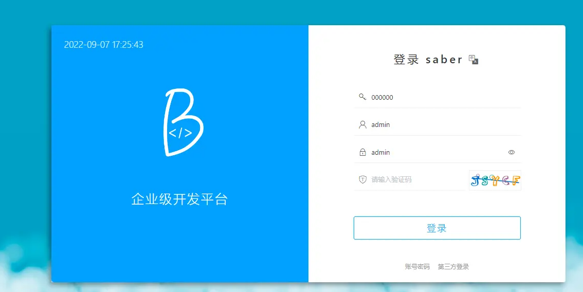

访问http://localhost:1888/

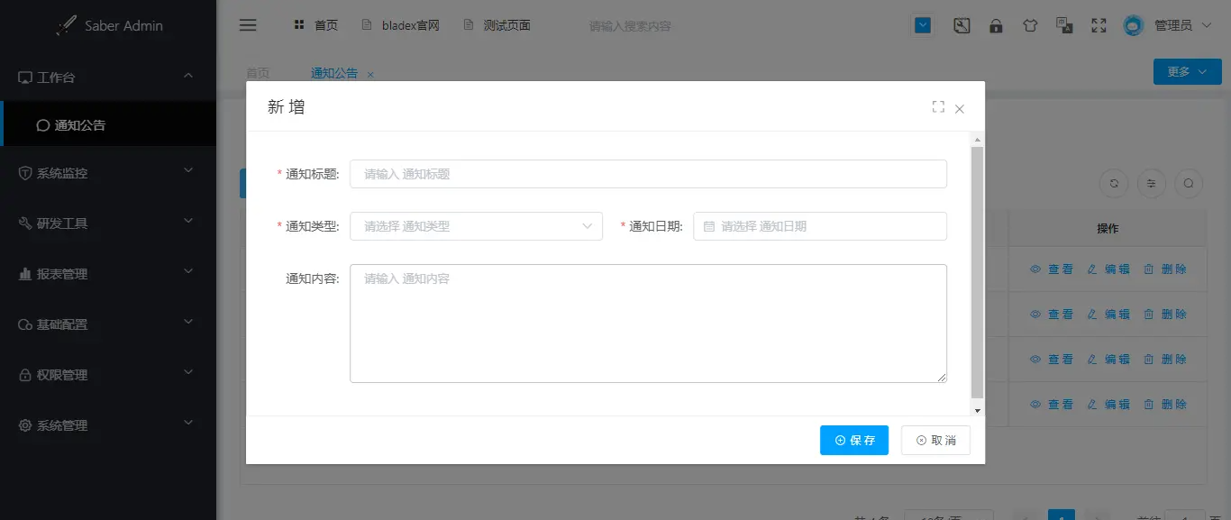

5. 小结

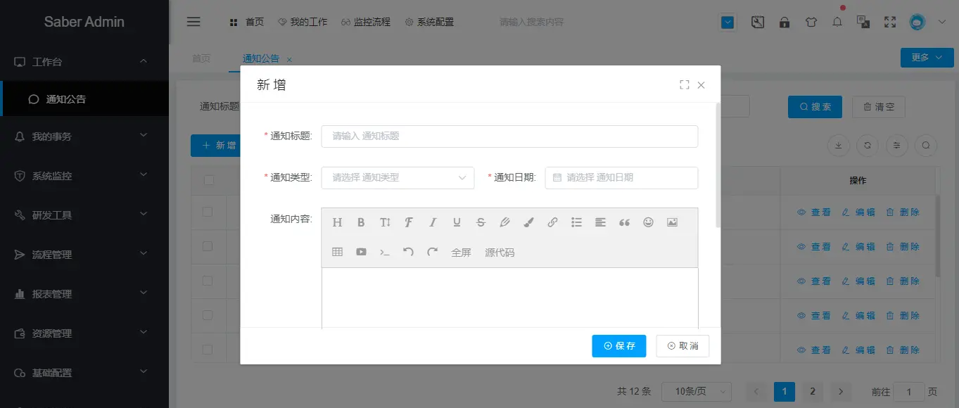

登录以后发现开源版没有富文本编辑器。。。好吧还需要自己集成一个,这个下篇文章再说。
