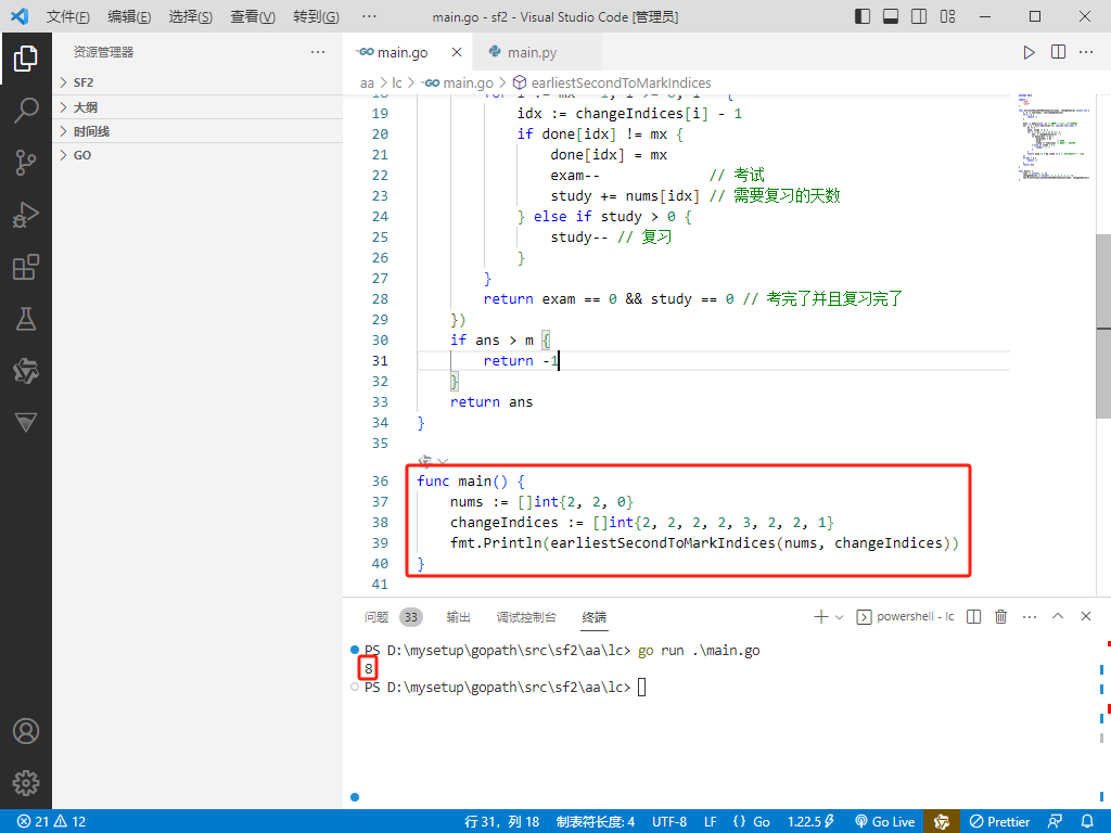

func main() {
	nums := []int{2, 2, 0}
	changeIndices := []int{2, 2, 2, 2, 3, 2, 2, 1}
	fmt.Println(earliestSecondToMarkIndices(nums, changeIndices))
