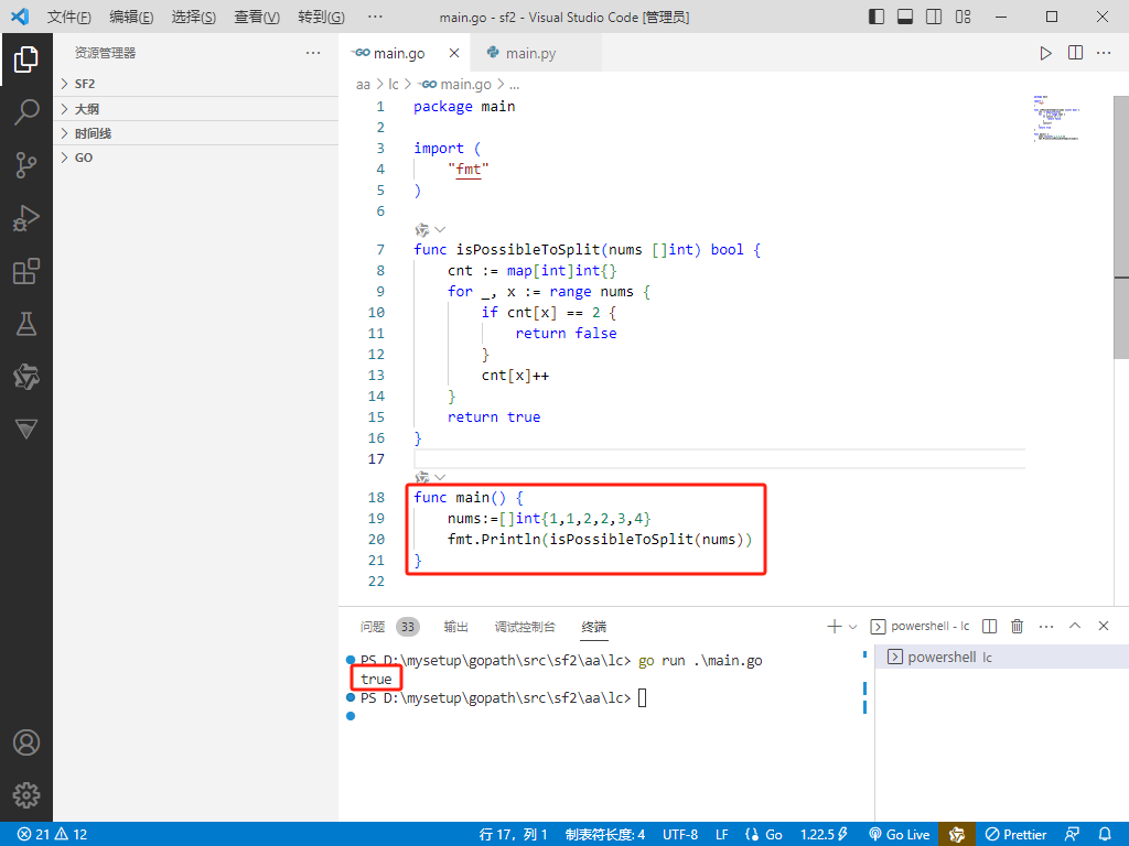

package main
import (
	"fmt"
func isPossibleToSplit(nums []int) bool {
	cnt := map[int]int{}
	for _, x := range nums {
		if cnt[x] == 2 {
			return false
		cnt[x]++
	return true
func main() {
	nums:=[]int{1,1,2,2,3,4}
	fmt.Println(isPossibleToSplit(nums))

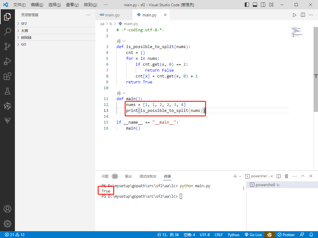

# -*-coding:utf-8-*-
def is_possible_to_split(nums):
    cnt = {}
    for x in nums:
        if cnt.get(x, 0) == 2:
            return False
        cnt[x] = cnt.get(x, 0) + 1
    return True
def main():
    nums = [1, 1, 2, 2, 3, 4]
    print(is_possible_to_split(nums))
if __name__ == "__main__":
    main()
