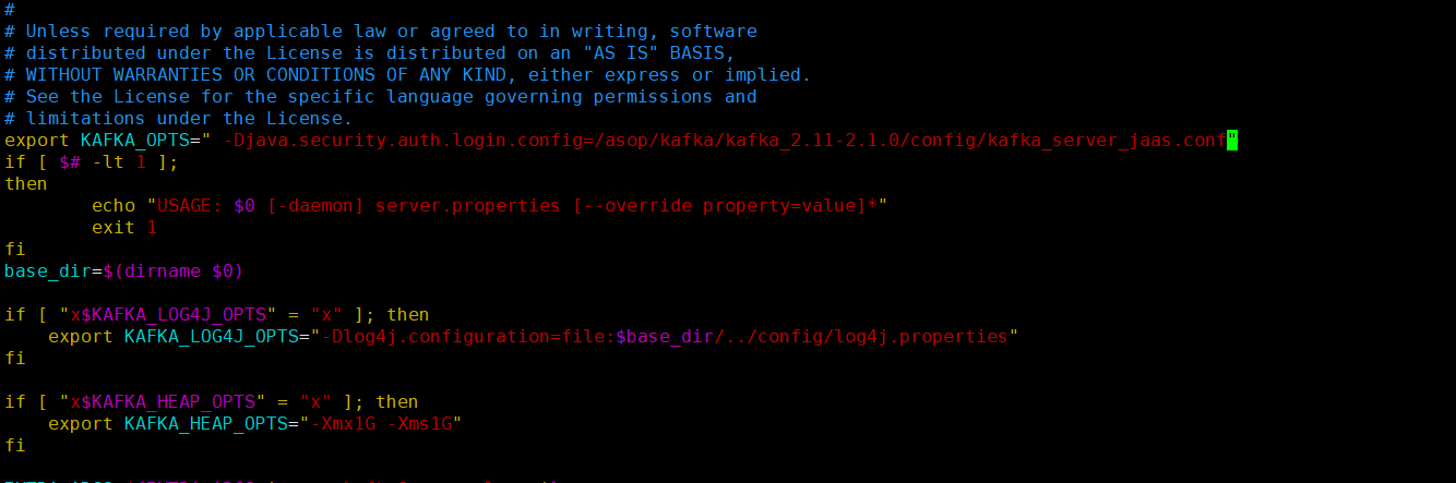

3、然后修改kafka安装目录vim /asop/kafka/kafka_2.11-2.1.0/bin/kafka-server-start.sh,在文件最上面添加变量
export KAFKA_OPTS=" -Djava.security.auth.login.config=/asop/kafka/kafka_2.11-2.1.0/config/kafka_server_jaas.conf"

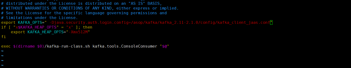

6、 修改kafka安装目录bin/kafka-console-producer.sh和bin/kafka-console-consumer.sh,在文件最上面添加变量
vim /asop/kafka/kafka_2.11-2.1.0/bin/kafka-console-producer.sh
vim /asop/kafka/kafka_2.11-2.1.0/bin/kafka-console-consumer.sh
export KAFKA_OPTS=" -Djava.security.auth.login.config=/asop/kafka/kafka_2.11-2.1.0/config/kafka_client_jaas.conf"
