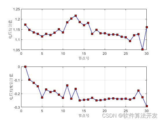

disp('状态估计结果');
disp('网络节点 --- 电压幅度    --- 电压相位角度');
for m = 1:Num_Bus
    fprintf('%4d        ',m);
    fprintf('%8.8f     ',V_est(m));
    fprintf('%8.8f  ',Ang_est(m));
    fprintf('\n');
end
figure;
subplot(211);
plot(1:Num_Bus,V_est,'-bs',...
    'LineWidth',1,...
    'MarkerSize',6,...
    'MarkerEdgeColor','k',...
    'MarkerFaceColor',[0.9,0.0,0.0]);
grid on;
xlabel('节点号');
ylabel('电压估计值');
subplot(212);
plot(1:Num_Bus,Ang_est,'-bs',...
    'LineWidth',1,...
    'MarkerSize',6,...
grid on;
xlabel('节点号');
ylabel('电压角度估计值');

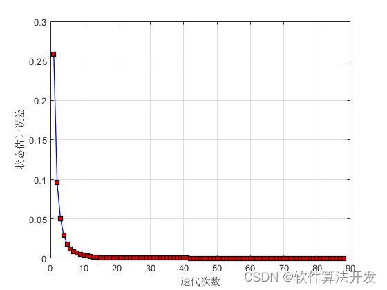

figure;
plot(errors,'-bs',...
    'LineWidth',1,...
    'MarkerSize',6,...
grid on;
xlabel('迭代次数');
ylabel('状态估计误差');

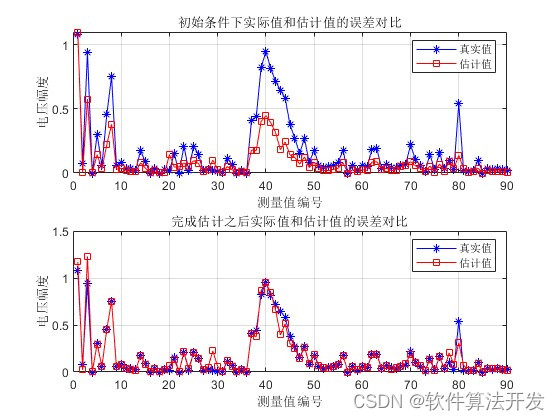

figure;
subplot(211);
plot(abs(Values),'b-*');
hold on
plot(abs(h_est{2}),'r-s');
grid on;
legend('真实值','估计值');
xlabel('测量值编号');
ylabel('电压幅度');
title('初始条件下实际值和估计值的误差对比');
subplot(212);
hold on
plot(abs(h_est{end}),'r-s');
grid on;
xlabel('测量值编号');
ylabel('电压幅度');
title('完成估计之后实际值和估计值的误差对比');
