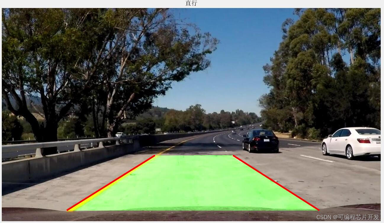

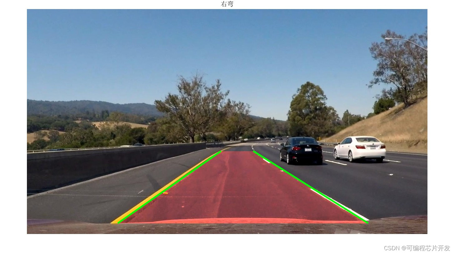

1.课题概述
        基于ADAS的车道线检测算法,通过hough变换和边缘检测方法提取视频样板中的车道线,然后根据车道线的弯曲情况,判决是直形,右转或者左转等。并用高亮标注车道线和车辆前方路面。

         % 设定动作名称为'左弯'
         if Pt_vratio> 0.47 &&Pt_vratio< 0.485
            Actions = '左弯';
            flag    = 1;
         elseif Pt_vratio>= 0.485 &&Pt_vratio<= 0.51% 设定动作名称为'直行'
            Actions = '直行';
            flag    = 0;
         else
            Actions = '右弯';% 设定动作名称为'右弯'
            flag    = -1;
         end

figure(1)
imshow(IIm0), hold on
         if flag==-1% 显示车道
            plot(p1,p2,'LineWidth',4,'Color','green');
            plot([Pt_line_dir1(1),Pt_line_dir2(1)],[Pt_line_dir1(2), Pt_line_dir2(2)],'LineWidth',4,'Color','green');
         end
         if flag== 0
            plot(p1,p2,'LineWidth',4,'Color','red');
            plot([Pt_line_dir1(1),Pt_line_dir2(1)],[Pt_line_dir1(2), Pt_line_dir2(2)],'LineWidth',4,'Color','red');
         end
         if flag== 1
            plot(p1,p2,'LineWidth',4,'Color','yellow');
            plot([Pt_line_dir1(1),Pt_line_dir2(1)],[Pt_line_dir1(2), Pt_line_dir2(2)],'LineWidth',4,'Color','yellow');
         end
title(Actions,'FontSize',16)
