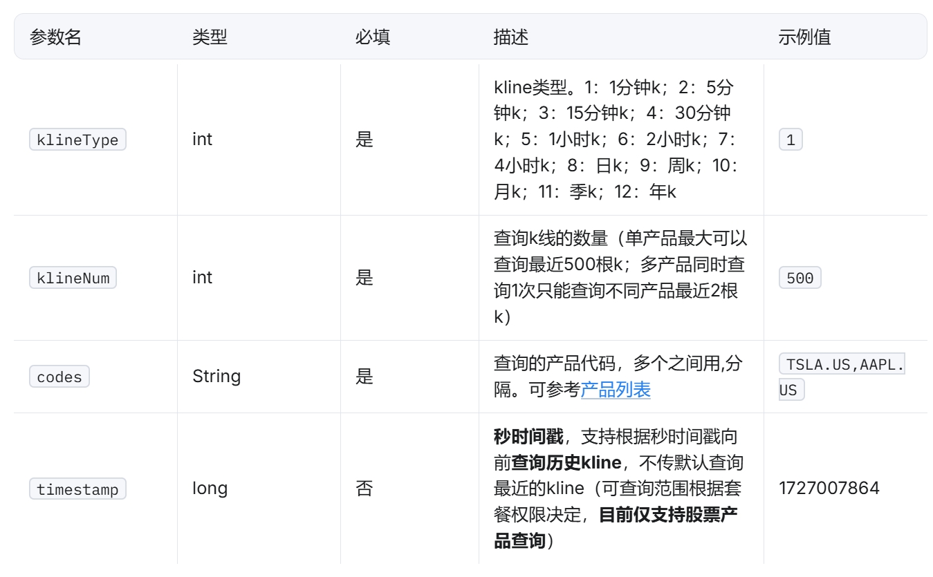

上面代码同时查询三个不同市场的股票(002594.SZ, 00285.HK, TSLA.US),批量K线的请求地址统一为:
https://data.infoway.io/stock/v2/batch_kline
入参示例:
    "klineType":1, //kline类型
    "klineNum":10, //k线数量
    "codes":"TSLA.US,AAPL.US", //查询产品,逗号分隔
    "timestamp":1758553860 //最近截止时间戳
