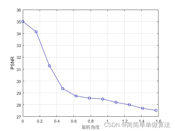

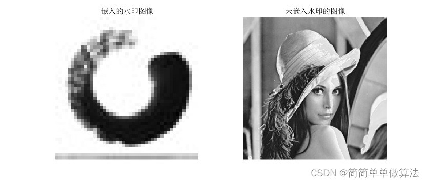

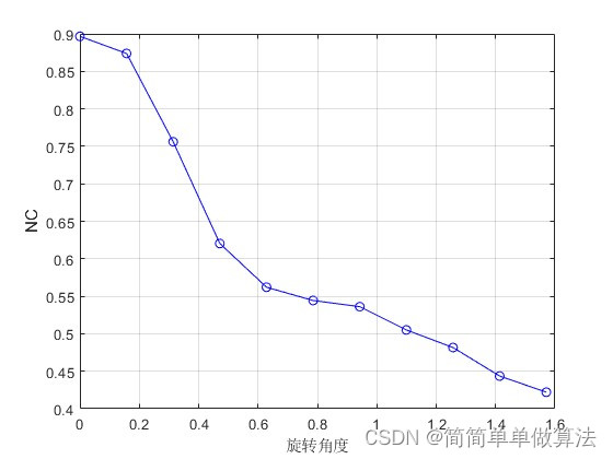

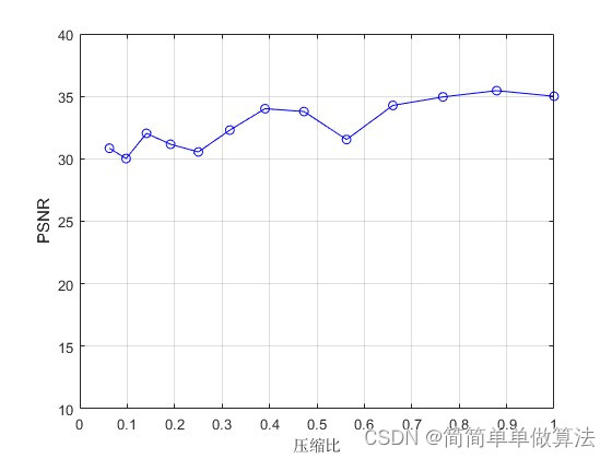

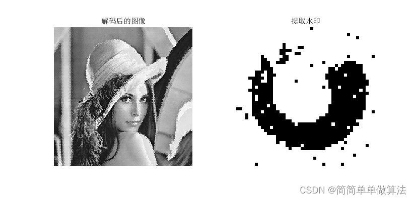

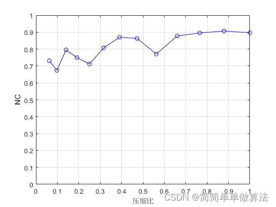

1.算法运行效果图预览
噪声测试
旋转测试
压缩测试
2.算法运行软件版本

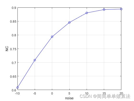

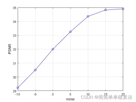

%噪声攻击
Mwk_binary= uint8(awgn(double(Mwk_binary),NOISE(jj),'measured'));
[Imark,Mwk_binarys] = func_desert(Mwk_binary,RR,CC,4);
figure(1);
subplot(122);
imshow(Imark,[]);
title('提取水印');

PSNR(jj) = func_psnr((Imark0),(Imark));
NC(jj)   = func_nc((Imark0),(Imark)) ;
end
figure;
plot(NOISE,PSNR,'b-o');
grid on
xlabel('noise');
ylabel('PSNR');
figure;
plot(NOISE,NC,'b-o');
grid on
xlabel('noise');
ylabel('NC');
