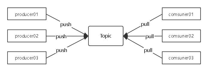

Kafka是一种高吞吐量的分布式发布订阅消息系统,它可以处理消费者在网站中的所有动作流数据。

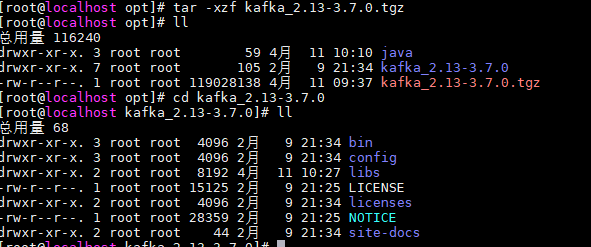

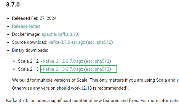

Kafka下载https://downloads.apache.org/kafka/3.7.0/kafka_2.13-3.7.0.tgz
解压tar -xzf kafka_2.13-3.7.0.tgz

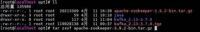

二、Zookeeper服务器启动Kafka

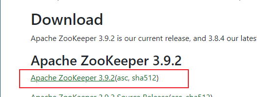

Zookeeper服务器安装
https://zookeeper.apache.org/
https://dlcdn.apache.org/zookeeper/zookeeper-3.9.2/apache-zookeeper-3.9.2-bin.tar.gz
tar zxvf apache-zookeeper-3.9.2-bin.tar.gz

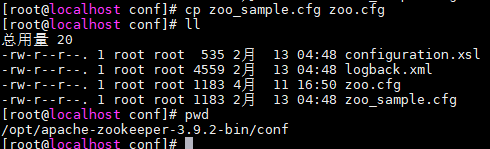

配置Zookeeper服务器
cp zoo_sample.cfg zoo.cfg

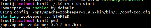

启动Zookeeper服务器
./zkServer.sh start

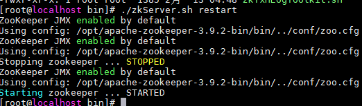

修改Zookeeper端口
Zoo.cfg添加内容
admin.serverPort=8099
apache-zookeeper-3.9.2-bin/bin目录下重启Zookeeper

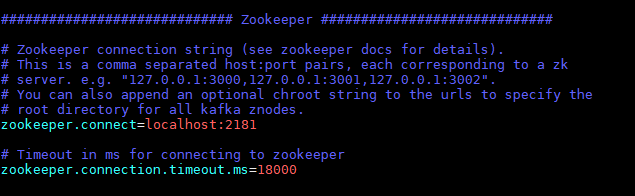

Kafka配置文件server.properties

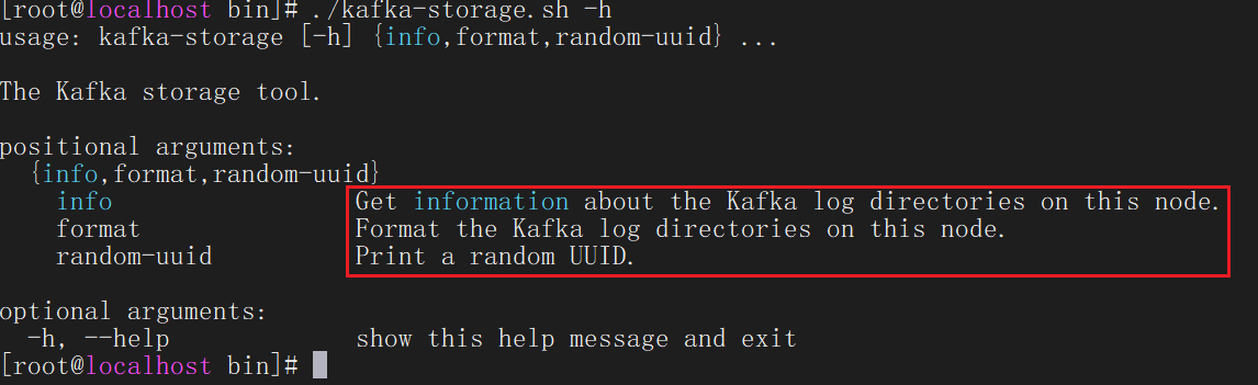

三、使用KRaft启动Kafka

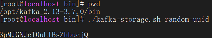

UUID通用唯一识别码(Universally Unique Identifier)
1、生成Cluster UUID(集群UUID):./kafka-storage.sh random-uuid
2.格式化kafka日志目录:./kafka-storage.sh format -t 3pMJGNJcT0uLIBsZhbucjQ -c ../config/kraft/server.properties

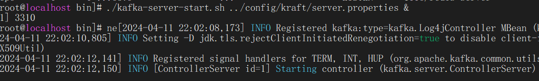

3.启动kafka:./kafka-server-start.sh ../config/kraft/server.properties &

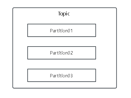

创建topic时,若不指定topic的分区(partition)数量使,则默认为1个分区(partition)

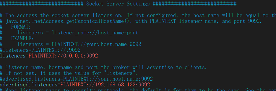

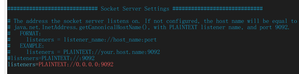

修改server.properties文件
vim server.properties

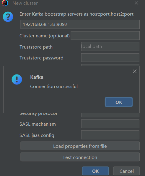

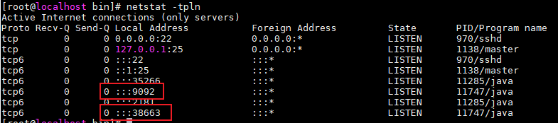

listeners=PLAINTEXT://0.0.0.0:9092
advertised.listeners=PLAINTEXT://192.168.68.133:9092

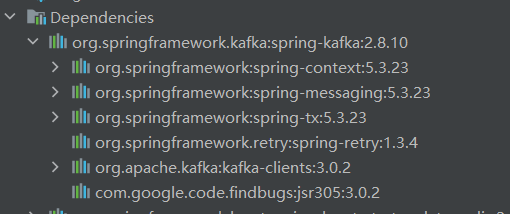

springboot加入依赖kafka
<dependency>
<groupId>org.springframework.kafka</groupId>
<artifactId>spring-kafka</artifactId>
</dependency>
加入spring-kafka依赖后,springboot自动装配好kafkaTemplate的Bean

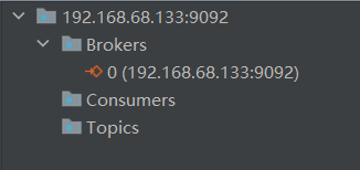

application.yml配置连接kafka
spring:
kafka:
bootstrap-servers: 192.168.68.133:9092

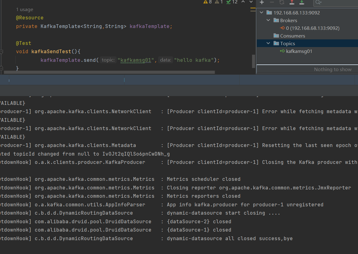

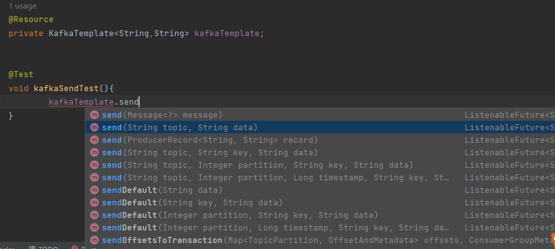

生产者
发送消息
@Resource
private KafkaTemplate<String,String> kafkaTemplate;
@Test
void kafkaSendTest(){
kafkaTemplate.send("kafkamsg01","hello kafka");

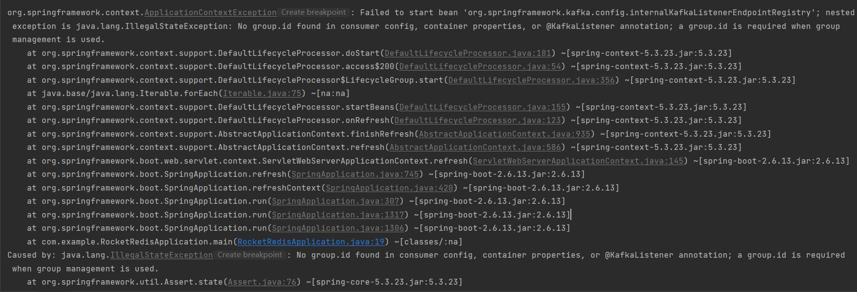

若没有配置groupid
Failed to start bean 'org.springframework.kafka.config.internalKafkaListenerEndpointRegistry'; nested exception is java.lang.IllegalStateException: No group.id found in consumer config, container properties, or @KafkaListener annotation; a group.id is required when group management is used.
