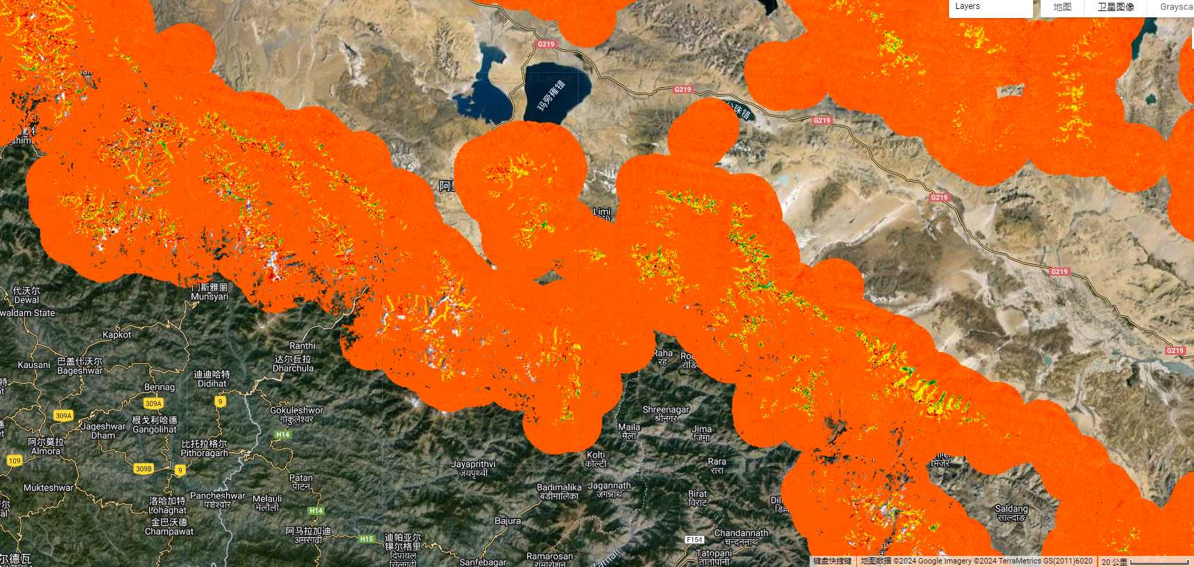

代码
var collection = ee.ImageCollection("projects/sat-io/open-datasets/GLOBAL-GLACIER-MASS-LOSS/elevation-change"),
    error = ee.ImageCollection("projects/sat-io/open-datasets/GLOBAL-GLACIER-MASS-LOSS/elevation-change-error");
// Load your glacial elevation map
var elevationMap = collection.mosaic();
//Setup basemaps
var snazzy = require("users/aazuspan/snazzy:styles");
snazzy.addStyle("https://snazzymaps.com/style/132/light-gray", "Grayscale");
var elevationPalette = [
  'blue', 'cyan', 'lightblue', 'lightgreen', 'green', 'darkgreen',
  'yellow', 'orange', 'red', 'darkred', 'brown', 'black'
Map.setCenter(81.472,30.116,9)
// Visualize the original and masked elevation maps
Map.addLayer(elevationMap, {min: -6.3, max: 3, palette: elevationPalette}, 'Original Elevation');
// Define a custom elevation palette with a wide range of color
代码链接
https://code.earthengine.google.com/?scriptPath=users/sat-io/awesome-gee-catalog-examples:elevation-bathymetry/GLACIER-ELEVATION
