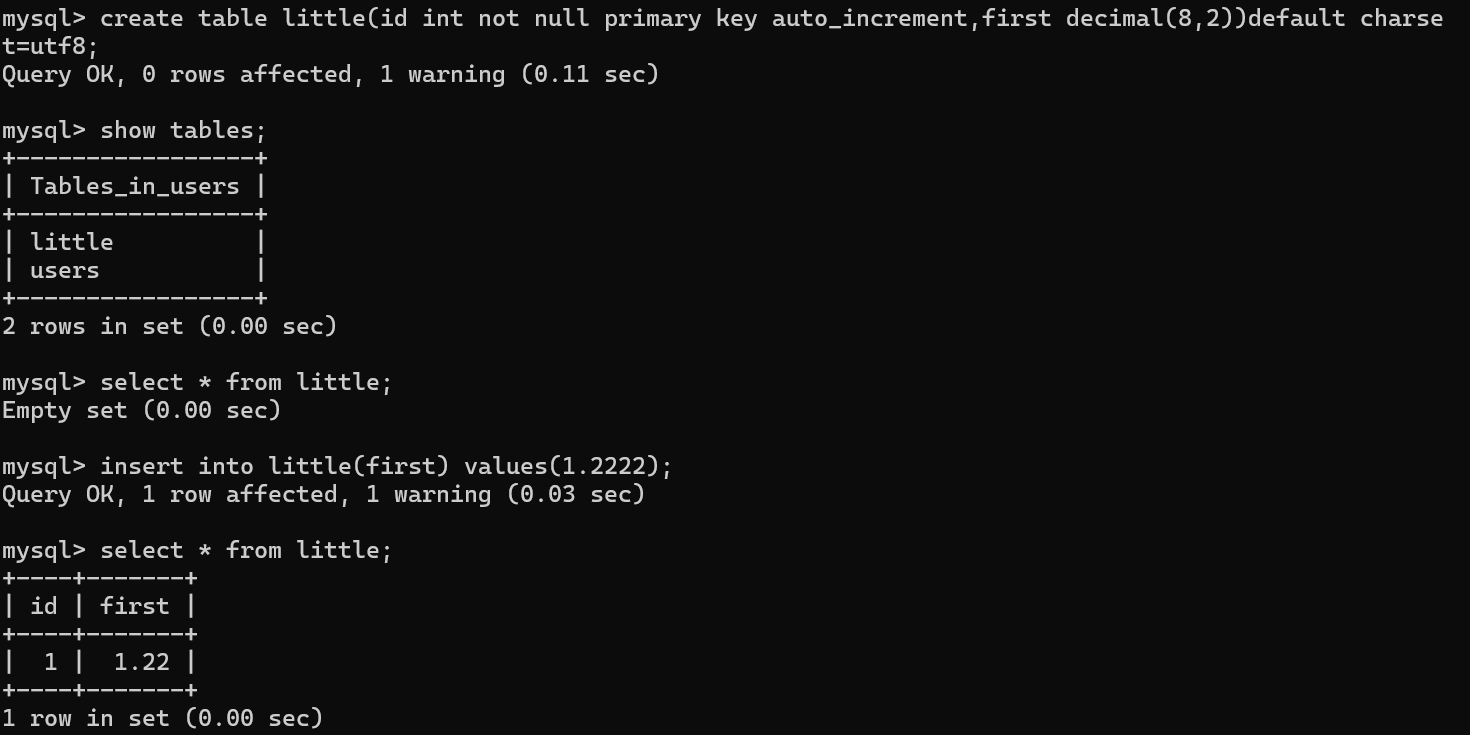

例子-------------------------
	create table little(id int not null primary key auto_increment,first decimal(8,2))default charse
t=utf8;
	insert into little(first) values(1.2222);
	select * from little;
