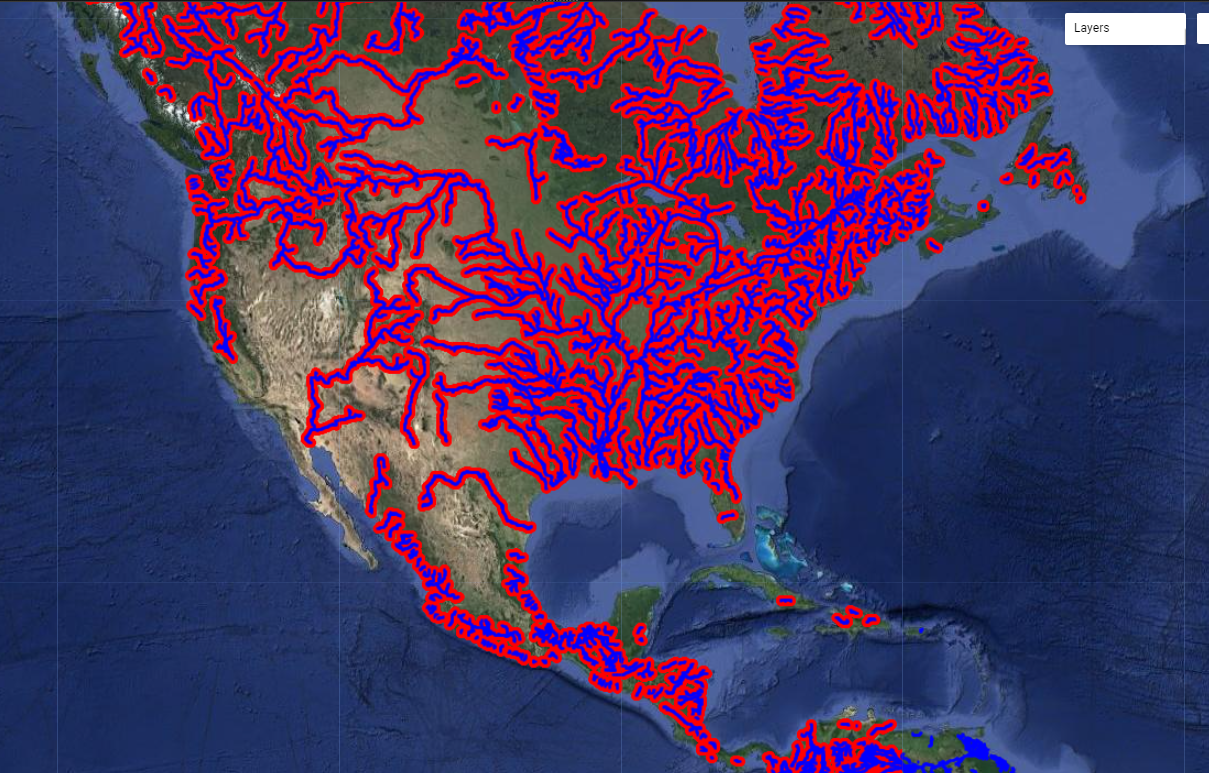

var nodes_merged = ee.FeatureCollection("projects/sat-io/open-datasets/SWORD/nodes_merged");
var reaches_merged = ee.FeatureCollection("projects/sat-io/open-datasets/SWORD/reaches_merged");
// Define different styles for each FeatureCollection
var nodeStyle = {
  color: 'red',
  width: 2
var reachStyle = {
  color: 'blue',
  width: 1
// Add each FeatureCollection with its own style
Map.addLayer(nodes_merged, nodeStyle, 'Nodes');
Map.addLayer(reaches_merged, reachStyle, 'Reaches');
代码链接
https://code.earthengine.google.com/?scriptPath=users/sat-io/awesome-gee-catalog-examples:hydrology/SWORD-NODES-REACHES-MERGED
