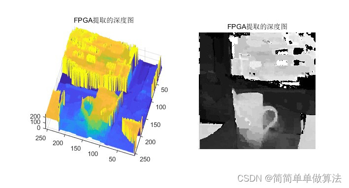

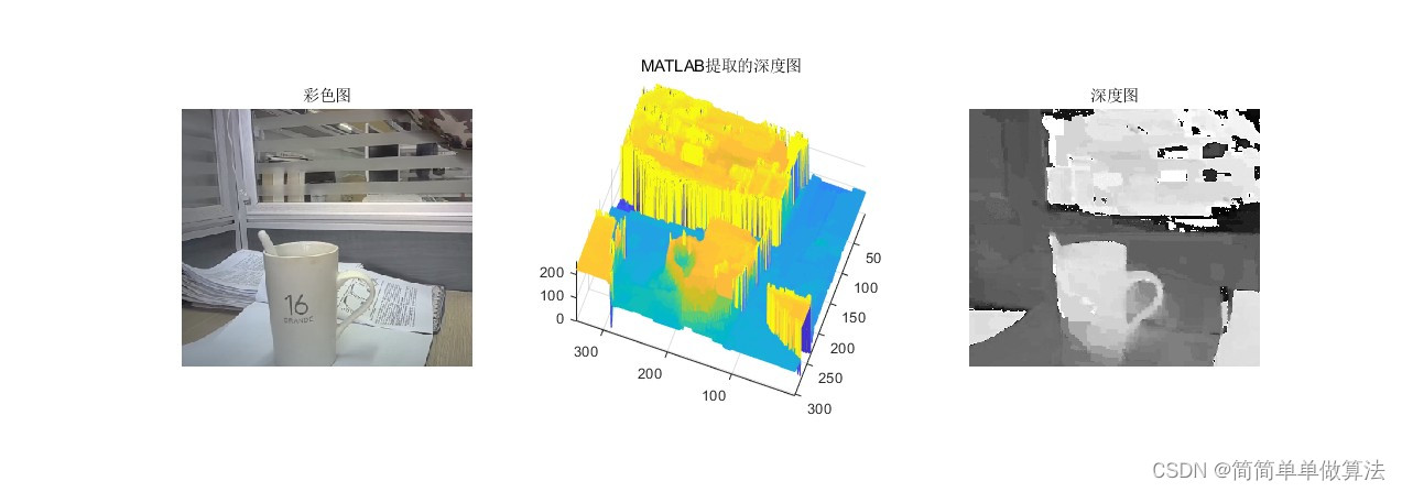

1.算法运行效果图预览
将FPGA结果导入到matlab显示结果如下:
matlab的对比测试结果如下:

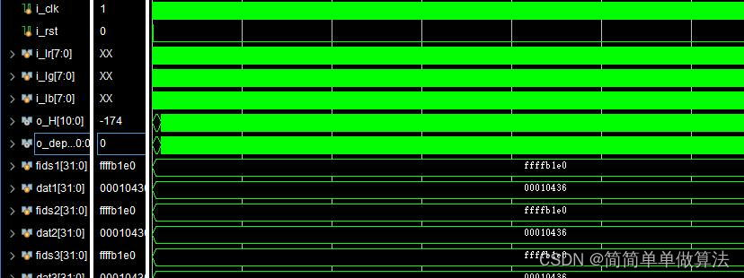

`timescale 1ns / 1ps
// Company:
// Engineer:
// Create Date: 2023/08/01
// Design Name:
// Module Name: RGB2gray
// Project Name:
// Target Devices:
// Tool Versions:
// Description:
// Dependencies:
// Revision:
// Revision 0.01 - File Created
// Additional Comments:
//MATLAB/verilog/python/opencv/tensorflow/caffe/C/C++等算法仿真
//微信公众号:matlabworld
module test_image;
reg i_clk;
reg i_rst;
reg [7:0] Rbuff [0:100000];
reg [7:0] Gbuff [0:100000];
reg [7:0] Bbuff [0:100000];
reg [7:0] i_Ir,i_Ig,i_Ib;
wire [10:0]o_depth;
integer fids1,dat1,fids2,dat2,fids3,dat3,jj=0;
//D:\FPGA_Proj\FPGAtest\codepz
initial
begin
	fids1 = $fopen("D:\\FPGA_Proj\\FPGAtest\\codepz\\R.bmp","rb");
	dat1  = $fread(Rbuff,fids1);
	$fclose(fids1);
end
initial
begin
	fids2 = $fopen("D:\\FPGA_Proj\\FPGAtest\\codepz\\G.bmp","rb");
	dat2  = $fread(Gbuff,fids2);
	$fclose(fids2);
end
initial
begin
	fids3 = $fopen("D:\\FPGA_Proj\\FPGAtest\\codepz\\B.bmp","rb");
	dat3 = $fread(Bbuff,fids3);
	$fclose(fids3);
end
initial
begin
i_clk=1;
i_rst=1;
#1200;
i_rst=0;
end
always #5  i_clk=~i_clk;
always@(posedge i_clk)
begin
	i_Ir<=Rbuff[jj];
	i_Ig<=Gbuff[jj];
	i_Ib<=Bbuff[jj];
	jj<=jj+1;
end
main_RGB2HSV main_RGB2HSV_u(
.i_clk          (i_clk),
.i_rst          (i_rst),
.i_image_R      (i_Ir),
.i_image_G      (i_Ig),
.i_image_B      (i_Ib),
.o_depth        (o_depth)
integer fout1;
initial begin
 fout1 = $fopen("o_depth.txt","w");
end
always @ (posedge i_clk)
 begin
    if(jj<=66616 & jj>66616-65536)
	$fwrite(fout1,"%d\n",o_depth);
	else
	$fwrite(fout1,"%d\n",0);
end
endmodule
